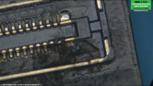

On these machines, the eDP(embedded displayport, protocol for image) data line from the CPU to the LCD, is right next to the backlight voltage line to the screen. This means that a 52v power line is right next to a 1.8v data line on the connector – and that 1.8v data line goes right to the CPU. On older Macbooks, there was typically a ground pin sitting between backlight and image data pins. That is gone.
This makes the machine very susceptible to humidity/dust causing a short circuit whereby the backlight voltage short circuits to image data, sending 52v straight to the CPU. This results in the CPU image circuitry being fried entirely. It looks like this on the display cable.
This is a Touchbar Macbook Pro display cable after the 52v from the backlight line has short circuited to the 1.8v CPU data line right next to it.
On 15″ Touchbar Macbooks, the situation is a little less dire – the image data line does not go straight to the CPU, but rather to a mux chip – that switches the input of the display between the dedicated graphics chip & the CPU integrated graphics. This is a simpler repair as the mux chip is more readily available, cheaper, and easier to solder on than a BGA CPU.
If you have this issue, it will present as no image – even if you look closely, it will not be there. This is not a dim picture – it is no picture. This issue is not covered by Apple.
