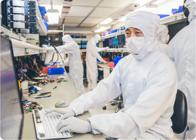

A Common Claim:
You need a $2,000,000 clean room for data recovery

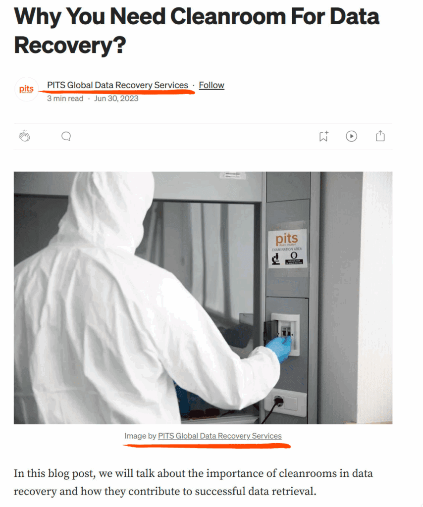

Some companies showcase room-scale clean rooms and full body suits in their marketing. While impressive-looking, the functional requirement for data recovery is a particulate-free work zone, not necessarily a room-scale sterile facility.
Screenshot from a PITS article about clean rooms
Image & excerpt cited from PITS Data Recovery on Medium.
What Actually Matters:

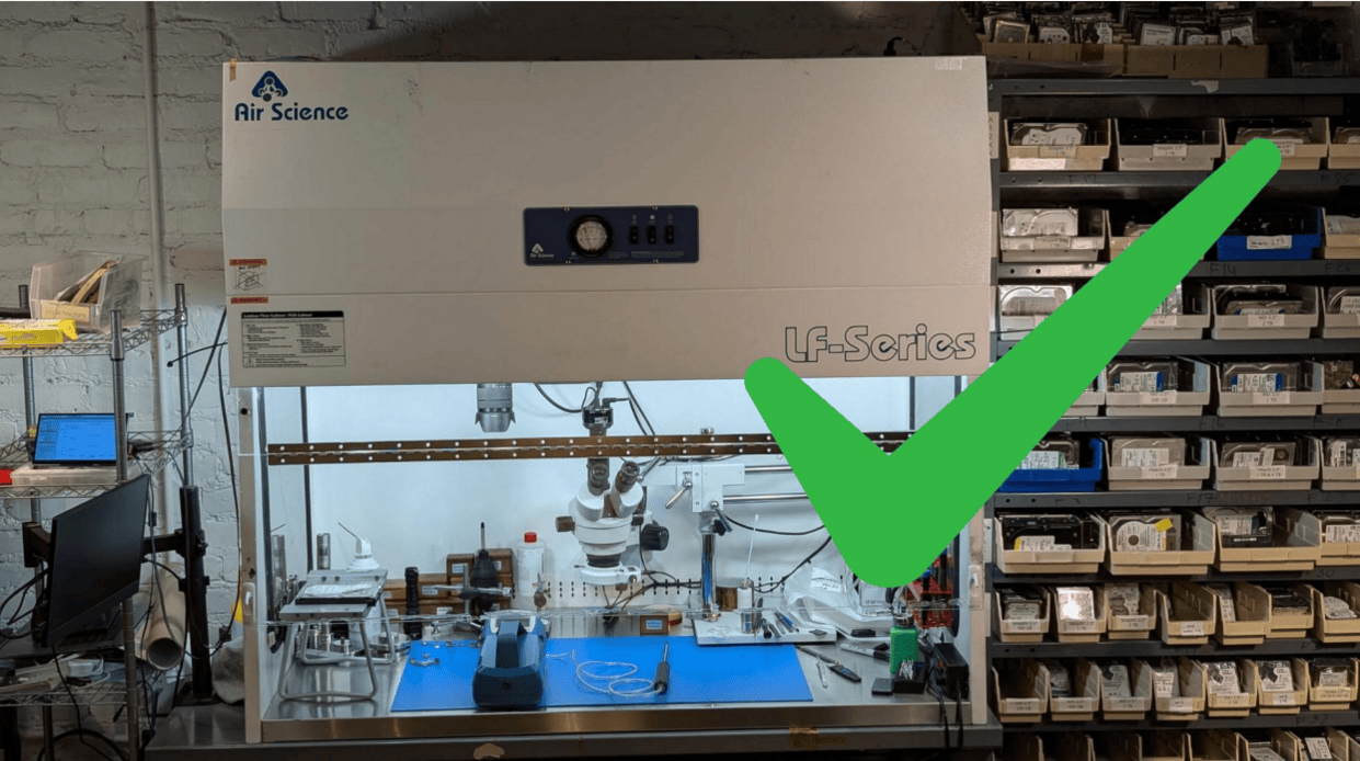

A properly filtered workspace
Opening a hard drive in your living room is a bad idea; we won't dispute that. A well-maintained ISO clean room provides the contamination control a hard drive needs. But a room-scale facility isn't the only path to safe recovery. Here's what's actually needed:
  • Filtered air that removes ultrafine particles
  • Consistent laminar airflow that flushes contaminants
  • Gloves and proper handling to protect platters from contact contamination
  • Engineers who know what they're doing
At Rossmann Repair Group, we do all four.

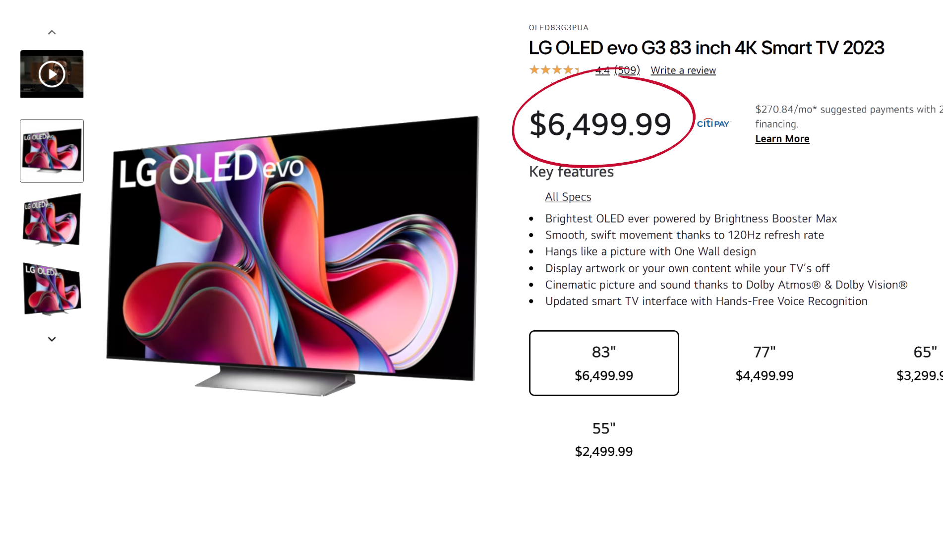

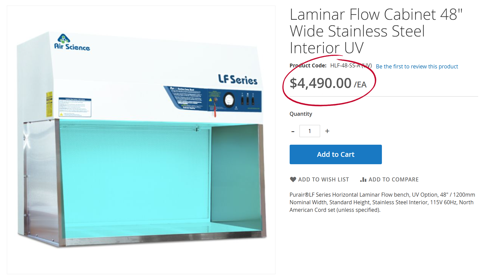

Bench vs tv
Clean bench and consumer electronics cost comparison
While full clean-room facility costs can run into the millions, the professional equipment required to secure a hard drive data recovery work zone is far more accessible.

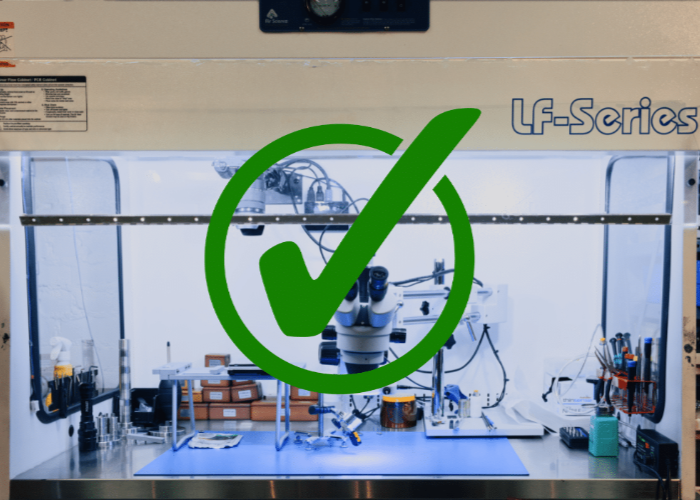

This is a 0.02 µm ULPA-filtered laminar-flow clean bench. Let's put it to work and see how it performs.
ULPA-filtered laminar flow bench listing
Professional laminar-flow cabinet for open-drive work
LG 83-inch OLED TV listing
Consumer electronics can cost more than a bench-scale recovery workspace

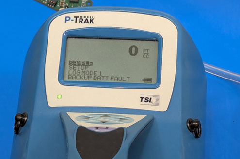

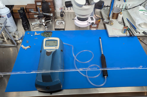

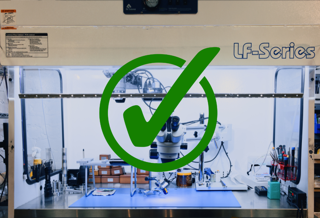

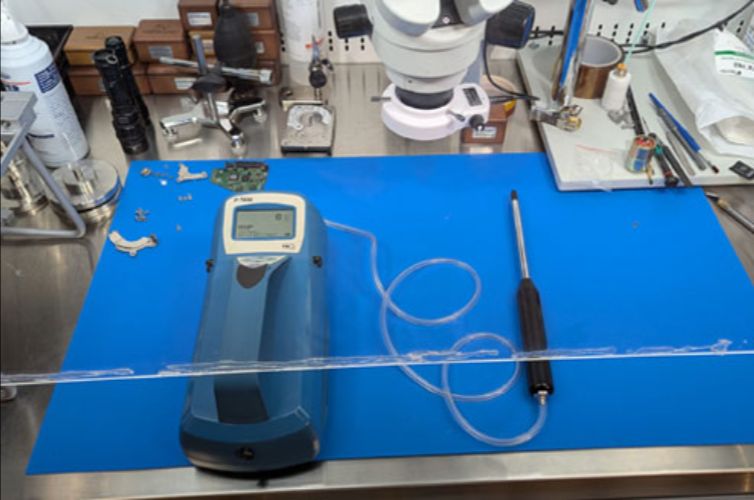

Inside the bench
The 0.02 µm ULPA-filtered laminar-flow clean bench protects drives from airborne particulates while open. It creates a vertical curtain of filtered air that continually flushes contaminants away from the work area. In other words, we achieve contamination control at the work surface without the overhead of a room-scale facility.

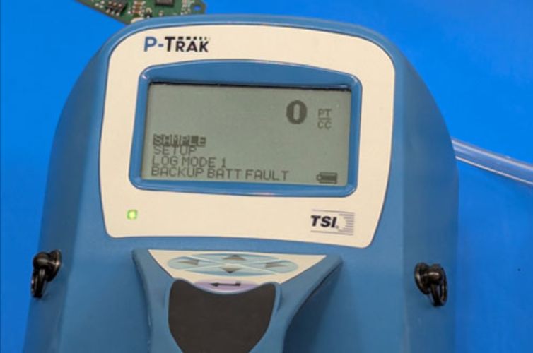

Particle counter test inside the bench
Working inside the bench
A laminar-flow bench isn't a sealed box that you contaminate the moment you reach into it. The bench continuously pushes ULPA-filtered air downward through the work area. Contaminants from the technician's arms and body are carried down and away from the work surface, not onto the platters.
This is the same principle used in pharmaceutical compounding, semiconductor fabrication, and biological safety cabinets. The airflow is what keeps the work zone clean, and it does so continuously while the technician is actively working.
Our technicians wear nitrile gloves for all open-drive procedures. Gloves prevent fingerprints, skin oils, and contact contamination on platters. Between the vertical airflow handling airborne particulates and gloves handling contact contamination, the drive surface is protected on both fronts.
Particle counter on the bench with laminar sheet
Close-up of particle counter display

What are the ISO 14644-1 particle limits for data recovery: Class 4 vs. Class 5?
ISO 14644-1 Class 5 permits up to 3,520 particles at 0.5 µm per cubic meter. Class 4 is 10x stricter at 352 particles.
ISO 14644-1 defines cleanroom classifications by measuring the maximum permitted concentration of airborne particles per cubic meter of air. The scale is logarithmic. Here are the two classes relevant to data recovery:
ISO Class 5 (formerly "Class 100" under Federal Standard 209E)
Maximum 3,520 particles at 0.5 µm or larger per cubic meter. Maximum 100,000 particles at 0.1 µm or larger per cubic meter.
ISO Class 4
Maximum 352 particles at 0.5 µm or larger per cubic meter. Maximum 10,000 particles at 0.1 µm or larger per cubic meter. This is 10x stricter than ISO Class 5.
ISO 14644-1 does not mandate that an entire room must achieve these conditions. Its own scope statement covers cleanrooms, clean zones, and separative devices as defined in ISO 14644-7, so the standard classifies air cleanliness at a zone, not only at a room.

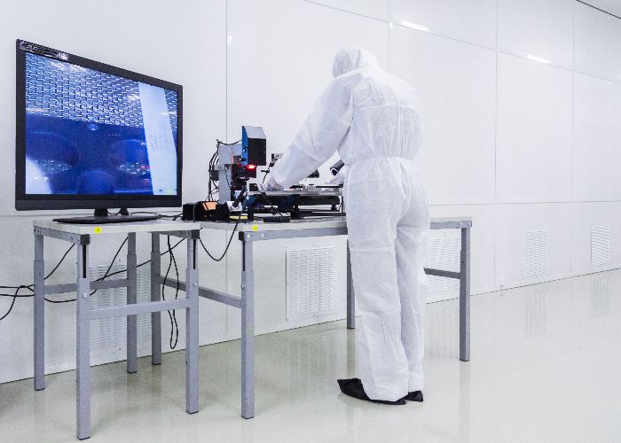

Spacesuits section
Cleanroom garments and bench filtration
Some facilities use full clean-room suits. For work inside a laminar-flow bench, you don't need them; the bench handles the filtering, not the outfit. What matters is the particle count where the drive actually is. Companies like DriveSavers feature these suits prominently in their marketing, but the suits protect the room from the technician, not the drive from particles. That's the bench's job.

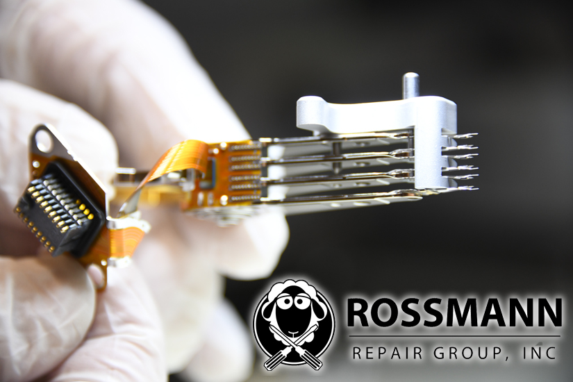

Head swap timing and particle exposure

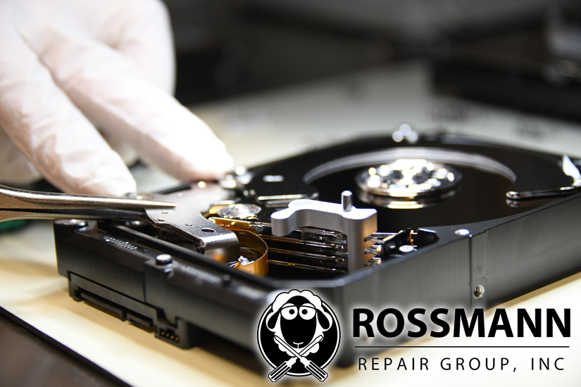

How long platters are exposed during a head swap
The physical swap, where platters are open and the head stack assembly is being exchanged, takes roughly 15 to 45 minutes. For that entire window, the drive sits directly beneath the 0.02 µm ULPA-filtered clean bench, which pushes filtered air downward and actively deflects ambient particles away from the platter surfaces.
A head swap involves removing a failed head stack assembly using precision head combs and installing a matched donor assembly. The overall recovery process, including diagnostics, donor matching, ROM transfer, the swap itself, and imaging with PC-3000, can take hours. The physical swap where the platters are open and the heads are being exchanged takes roughly 15 to 45 minutes.
During that 15-to-45-minute window, the drive sits directly beneath the ULPA-filtered clean bench. The ULPA filter generates a continuous, unidirectional curtain of filtered air flowing downward. Ambient particles from the technician, the room, and the surrounding workspace are physically deflected away from the platter surfaces by positive pressure at the work zone. The bench does not merely trap particles in a filter; it actively pushes clean air over the platters for the entire duration of the procedure.
Read/write head fly height and particle contact
Modern read/write heads float on an air bearing surface created by the platters spinning at 5,400 to 10,000 RPM.
If a particle larger than the fly height lands on the platter surface, the head collides with it at speeds of 80 to 120 km/h and gouges the magnetic coating. This is why any work that opens the drive must happen under continuous ULPA-filtered airflow, not just behind a closed door labeled "clean room."

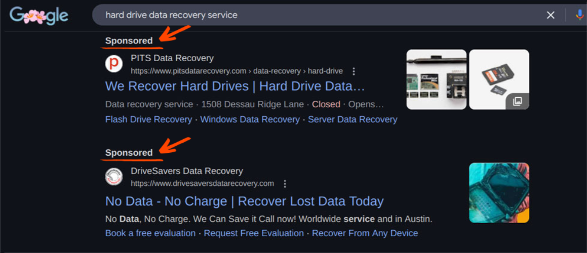

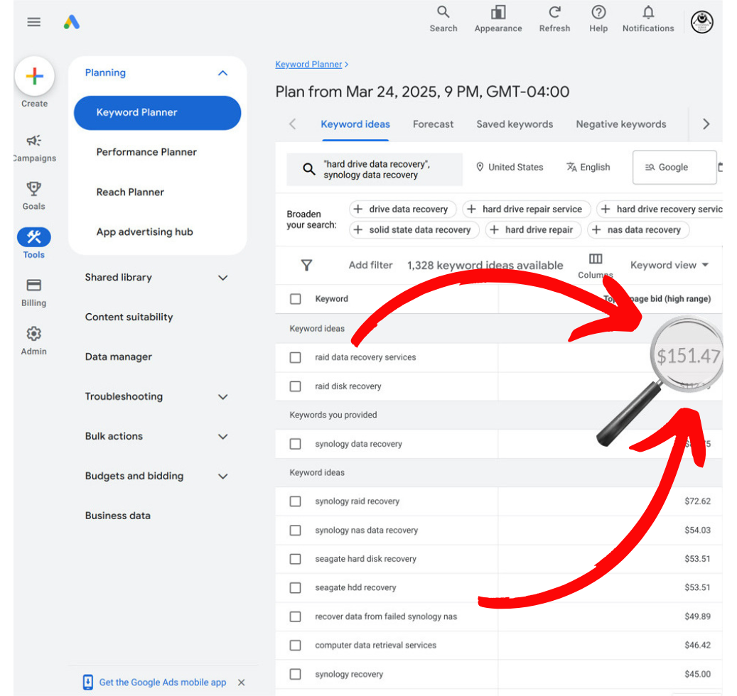

Paid search for data recovery is expensive before a drive reaches the bench. If a lab buys most of its leads, that ad spend has to be recovered through successful jobs.
Sponsored Google results for data-recovery keywords
Sponsored placement
Placement at the top of the page is paid, not organic.
Google Ads keyword planner showing high CPC for data-recovery terms
High-range CPC
Paid ads
Paid search placement can make every data recovery lead expensive before a drive ever reaches the bench.
