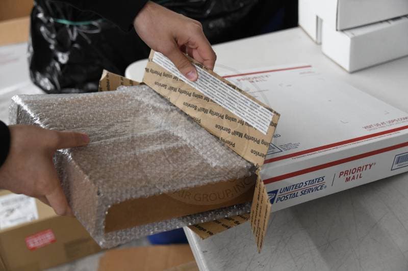

Packaging guide07/14
How Should You Package a Hard Drive for Shipping?
Use Box-in-Box packaging: wrap the drive in an anti-static bag, add 2-3 inches of bubble wrap, place it in a small inner box, then float that box inside a larger outer box with padding on all sides. This method absorbs impact without allowing the drive to shift, protecting it from physical damage during transit.
Use Box-in-Box packaging: wrap the drive in an anti-static bag, add 2-3 inches of bubble wrap, place it in a small inner box, then float that box inside a larger outer box with padding on all sides. This method absorbs impact without allowing the drive to shift.
Proper packaging is your first line of defense. A drive that has failed logically (software) can become a physical failure if dropped during shipping.
  • 1Anti-Static Bag: Protects the PCB from electrostatic discharge.
  • 2Bubble Wrap (2-3 inches): Tightly wrap the drive. Peanuts allow shifting; don't use them alone.
  • 3Box-in-Box: For maximum safety, place the wrapped drive in a small box, then float that box in a larger one.
Warning: Do not use FedEx envelopes or padded mailers. They offer zero crush protection.

Shipping Your Drive: Packaging, Carriers, Insurance, and Returns
Ship your drive in a rigid corrugated box using the box-in-box method: anti-static bag, two inches of bubble wrap on every face, inner box, outer carton. Carrier declared value covers physical hardware replacement only, not data. Include a note inside the box with your ticket number, name, and return address.
How should I physically package a bare hard drive or SSD for shipping?
Use the box-in-box method. Place the bare drive in an anti-static (ESD) bag to protect the PCB from electrostatic discharge. Suspend the bagged drive in a small inner box with at least two inches of bubble wrap on every face, then float that inner box inside a larger outer carton with padding on all sides.
Do not use loose packing peanuts; they compress in transit and let the drive migrate to the box wall where shock absorption is zero. The same protocol applies to mechanical hard drive recovery shipments, where head parking and platter alignment are the first casualties of a drop.
