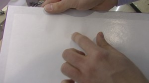

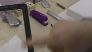

Crap glass has inferior packaging.
Good glass has a screen protector that is flush against the entire surface of the glass, applied at the factory at the time of production. You won't find dust, or any other junk under this protector.
Good glass has a screen protector that is flush against the entire surface of the glass, applied at the factory at the time of production. You won’t find dust, or any other junk under this protector.
The crap used glass has a white piece of paper over the backside of it. This is not factory applied, this is applied by a person - a lowly skilled one at that, who often eats over his work. You'll find dust and all sorts of crap between this piece of paper and the glass, as it is not sealed.
The crap used glass has a white piece of paper over the backside of it. This is not factory applied, this is applied by a person – a lowly skilled one at that, who often eats over his work. You’ll find dust and all sorts Crap glass has inferior packaging. of crap between this piece of paper and the glass, as it is not sealed.

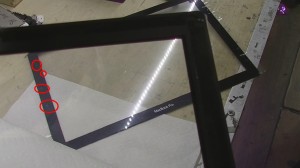

Crap glass has bubble defects.
You'll have to look closely, click & zoom in to see. These defects cause angry customers, chargebacks,and bad reviews.
You’ll have to look closely, click & zoom in to see. These defects cause angry customers, chargebacks,and bad reviews.

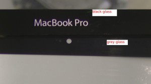

Crap glass has discolored borders
Ok, so the $100 camcorder doesn't do a stellar job of getting this point across, but if you can see it with the crap JVC Everio, imagine how bad it is in person. The crap glass on the bottom isn't even black - it's grey.
Ok, so the $100 camcorder doesn’t do a stellar job of getting this point across, but if you can see it with the crap JVC Everio, imagine how bad it is in person. The crap glass on the bottom isn’t even black – it’s grey.
