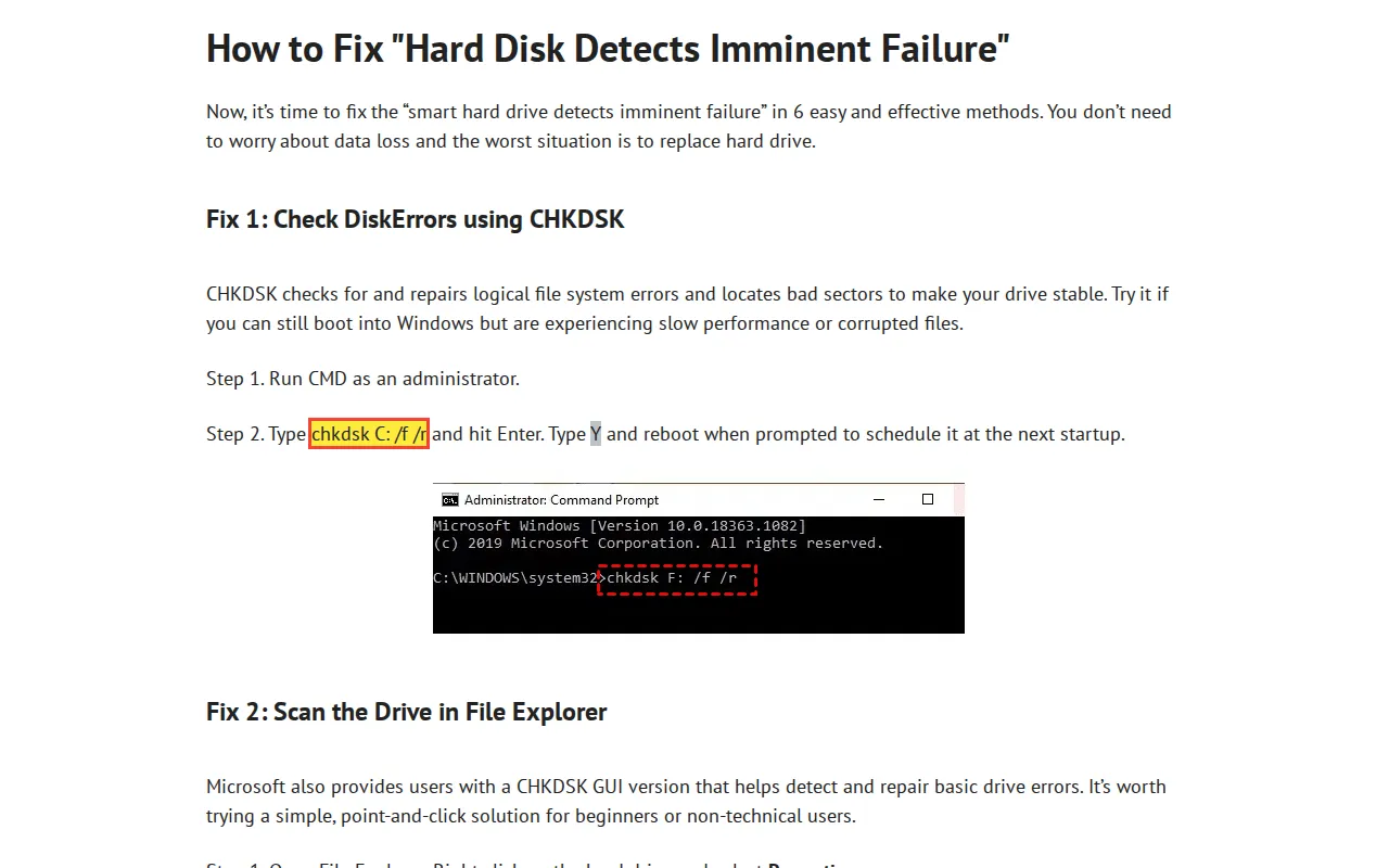

AOMEI publishes three articles recommending CHKDSK for drives with active SMART warnings. Their 'Hard Disk Detects Imminent Failure' guide instructs 'Type chkdsk C: /f /r and hit Enter' to 'locate bad sectors to make your drive stable.' Their 'Windows Detected a Hard Disk Problem' guide repeats the same advice without any data loss warning.
Source: AOMEI
“Fix 1: Check DiskErrors using CHKDSK... locates bad sectors to make your drive stable... Type chkdsk C: /f /r and hit Enter.”
Screenshot of AOMEI website showing the claim: "Fix 1: Check DiskErrors using CHKDSK... locates bad sectors ..."Click to enlarge screenshot
AOMEI page screenshot
View archived copy
Original: https://www.aomeitech.com/clone-tips/hard-disk-detects-imminent-failure-0044.html
Captured 2026-03-23

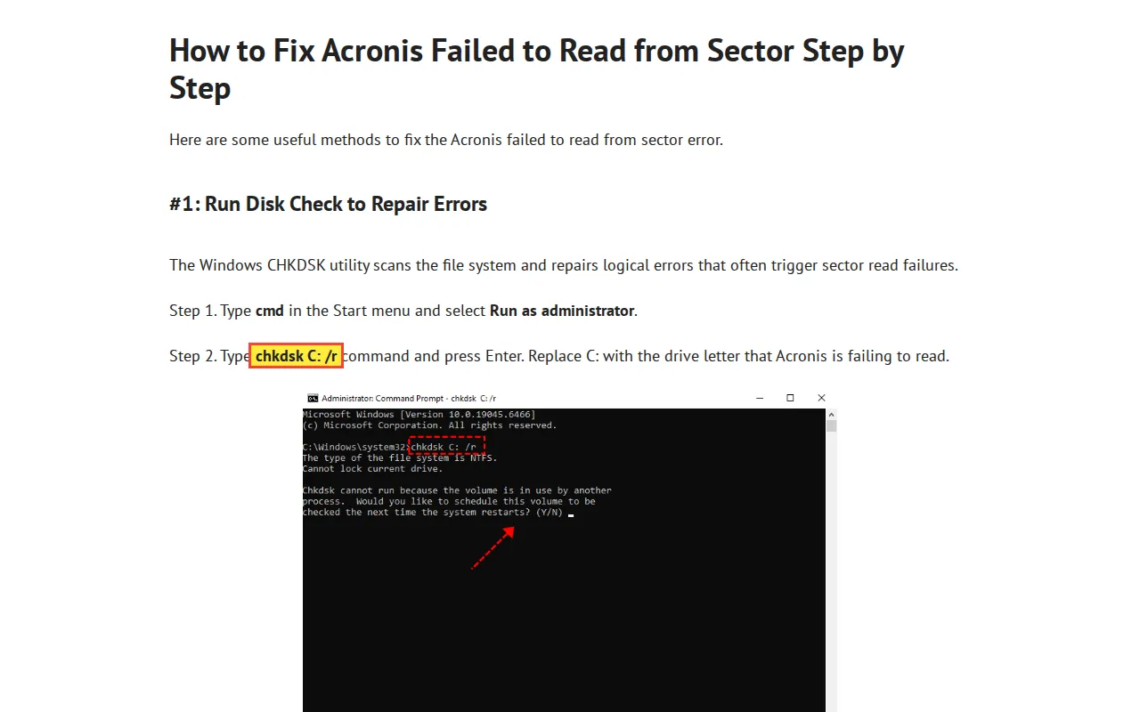

Source: AOMEI
“#1: Run Disk Check to Repair Errors... Type chkdsk C: /r command and press Enter.”
Screenshot of AOMEI website showing the claim: "#1: Run Disk Check to Repair Errors... Type chkdsk C: /r com..."Click to enlarge screenshot
View archived copy
Original: https://www.aomeitech.com/clone-tips/acronis-failed-to-read-from-sector-0044.html
Captured 2026-03-23
The Reality
SMART thresholds trip only when a drive has sustained physical degradation: a spike in Reallocated Sector Count, Current Pending Sector Count, or Spin Retry Count. By definition, the drive is actively dying. Running a full surface scan (/r) on a drive that has already warned the host firmware of imminent failure accelerates that failure.
Why This Matters
The /r flag forces the actuator arm across every track on every platter surface. On a drive with failing heads, this sustained load generates heat that pushes the heads closer to the platter surface. A head crash during the scan destroys data on every track the heads contact.
Correct Recovery Procedure
When SMART reports imminent failure: power off the drive. Do not run any diagnostic or repair utility. Image it with hardware tools that use configurable timeouts and multi-pass strategies.
Source: ATA/ATAPI SMART specification (T13); AOMEI's own articles

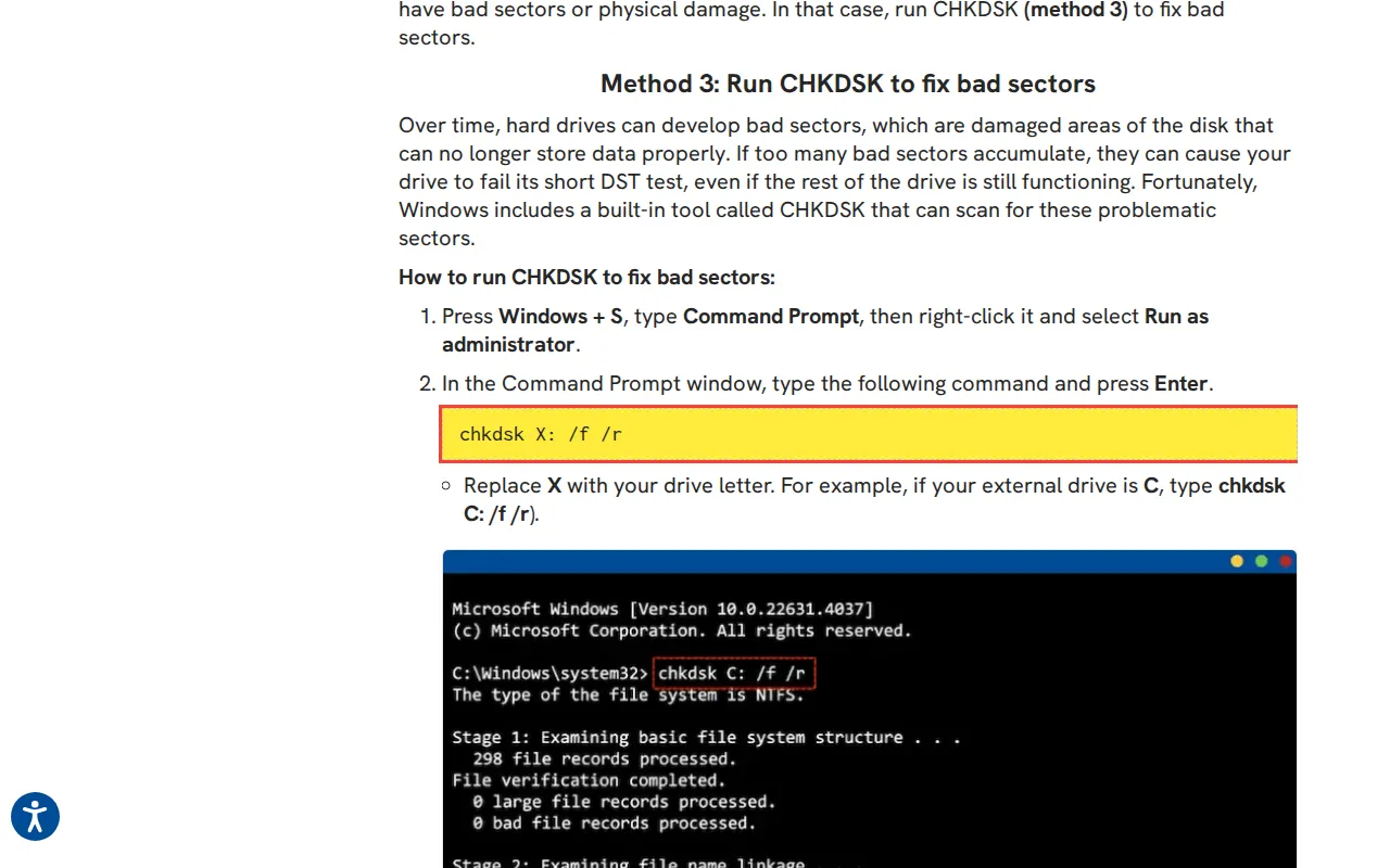

Secure Data Recovery publishes two articles recommending CHKDSK for hardware-level diagnostic failures. Their 'Short DST Failed' guide instructs 'chkdsk X: /f /r' for a drive that failed its internal self-test. Their CRC error guide recommends 'chkdsk X: /f /r /x' for errors caused by 'hardware failure, or physical damage (such as scratched platters or bad sectors).'
Source: Secure Data Recovery
“In the Command Prompt window, type the following command and press Enter. chkdsk X: /f /r. Replace X with your drive letter.”
Screenshot of Secure Data Recovery website showing the claim: "In the Command Prompt window, type the following command and..."Click to enlarge screenshot
Secure Data Recovery page screenshot
View archived copy
Original: https://www.securedatarecovery.com/blog/short-dst-failed
Captured 2026-03-23

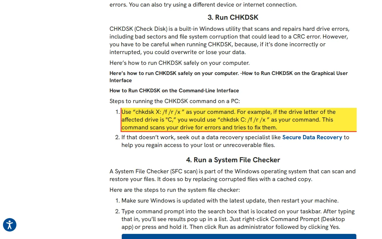

“Use 'chkdsk X: /f /r /x' as your command... This command scans your drive for errors and tries to fix them.”
Screenshot of Secure Data Recovery website showing the claim: "Use 'chkdsk X: /f /r /x' as your command... This command sca..."Click to enlarge screenshot
View archived copy
Original: https://www.securedatarecovery.com/blog/data-error-cyclic-redundancy-check
Captured 2026-03-23
The Reality
A failed Short Drive Self-Test (DST) is a firmware-level declaration that the drive's read/write heads cannot complete a basic servo seek test or that the Growing Defect List has overflowed. A CRC (Cyclic Redundancy Check) error means the drive's internal ECC cannot reconstruct data from a sector. Both are hardware failures, not file system problems.
Why This Matters
CHKDSK /r forces the compromised heads to interrogate the entire surface area. When it encounters sectors the firmware cannot read, it drops directory links and orphans files to .chk fragments. On SSDs, freed clusters trigger TRIM.
A drive failing DST or reporting CRC errors requires immediate power-off and professional hard drive data recovery. Read-only imaging captures all readable data before any metadata is modified.
Source: ATA Short Drive Self-Test specification (T13); CRC error correction documentation

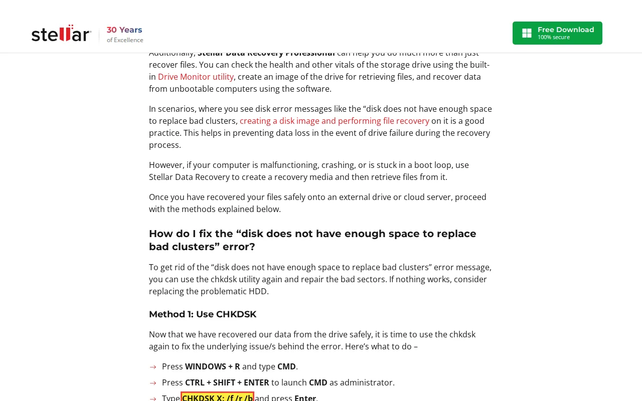

The Misconception
Stellar recommends 'CHKDSK X: /f /r /b' for the error 'disk does not have enough space to replace bad clusters.' That error means the drive has entirely exhausted its spare sector pool. MiniTool recommends 'chkdsk D: /f /r' for files showing as 0 bytes, a symptom of $MFT corruption or physical read channel failure.
Source: Stellar
“To get rid of the 'disk does not have enough space to replace bad clusters' error message, you can use the chkdsk utility again and repair the bad sectors.... Type CHKDSK X: /f /r /b and press Enter.”
Screenshot of Stellar website showing the claim: "To get rid of the 'disk does not have enough space to replac..."Click to enlarge screenshot
Stellar page screenshot
View archived copy
Original: https://www.stellarinfo.com/blog/disk-does-not-have-enough-space-to-replace-bad-clusters/
Captured 2026-03-23

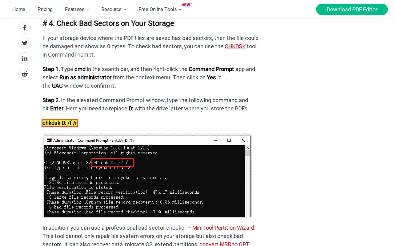

Source: MiniTool
“To check bad sectors, you can use the CHKDSK tool in Command Prompt... type the following command and hit Enter. chkdsk D: /f /r”
Screenshot of MiniTool website showing the claim: "To check bad sectors, you can use the CHKDSK tool in Command..."Click to enlarge screenshot
MiniTool page screenshot
View archived copy
Original: https://pdf.minitool.com/news/open-0-kb-pdf-files.html
Captured 2026-03-23
The Reality
The /b flag clears the NTFS-level list of known bad clusters and forces CHKDSK to re-evaluate them. This sends the failing actuator assembly back over the most damaged areas of the platter that the file system had previously abandoned. On a drive with no spare sectors, the physical damage is already so widespread that the firmware has no reserve capacity. A 0-byte file is typically caused by a read failure on the $DATA attribute of the MFT record, not logical corruption.
Why This Matters
The /b flag on a drive with exhausted spares forces the heads over the worst-damaged zones. A head crash at this stage destroys data across multiple tracks. The 0-byte file that could have been recovered by carving raw hex data from a disk image is permanently erased from the file system by CHKDSK.
Image the drive first, then run file system repair tools on the image. PC-3000 Data Extractor allows engineers to build a head map, imaging from stable heads first while skipping degraded heads and power-cycling when errors are detected.
Source: Microsoft CHKDSK /b documentation; NTFS $MFT $DATA attribute specification

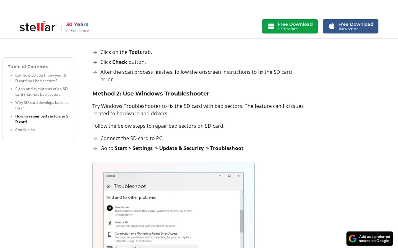

Source: Stellar
“Type 'chkdsk followed by the drive letter of the SD card, a colon and /f. (For example, chkdsk G: /f...)”
Screenshot of Stellar website showing the claim: "Type 'chkdsk followed by the drive letter of the SD card, a ..."Click to enlarge screenshot
View archived copy
Original: https://www.stellarinfo.com/blog/repair-sd-card-with-bad-sectors/
Captured 2026-03-23
The Reality
SD cards use NAND flash memory with an internal Flash Translation Layer (FTL) and wear-leveling microcontroller. 'Bad sectors' on an SD card indicate exhausted write-cycle endurance or FTL instability, not magnetic surface damage. CHKDSK /f on flash media triggers FAT/exFAT metadata mutations that are immediately written back to the failing cells. The /r flag compounds this by scanning every cluster.
Why This Matters
The barrage of metadata writes from CHKDSK frequently causes a compromised FTL to panic and lock the card into a permanent read-only state. If the FTL does not lock, CHKDSK's FAT table rewrites can corrupt the file allocation tables beyond recovery. Data that was physically intact on the NAND cells is rendered inaccessible by the FTL corruption.
Connect the SD card to a hardware write-blocker via a card reader. Image the card at the sector level. If the controller is functional, PC-3000 Flash or R-Studio can reconstruct the FAT/exFAT file system from the image. If the controller is dead, the NAND chip can be desoldered and read directly in a programmer.
Source: JEDEC flash endurance specification; FAT32/exFAT filesystem specification

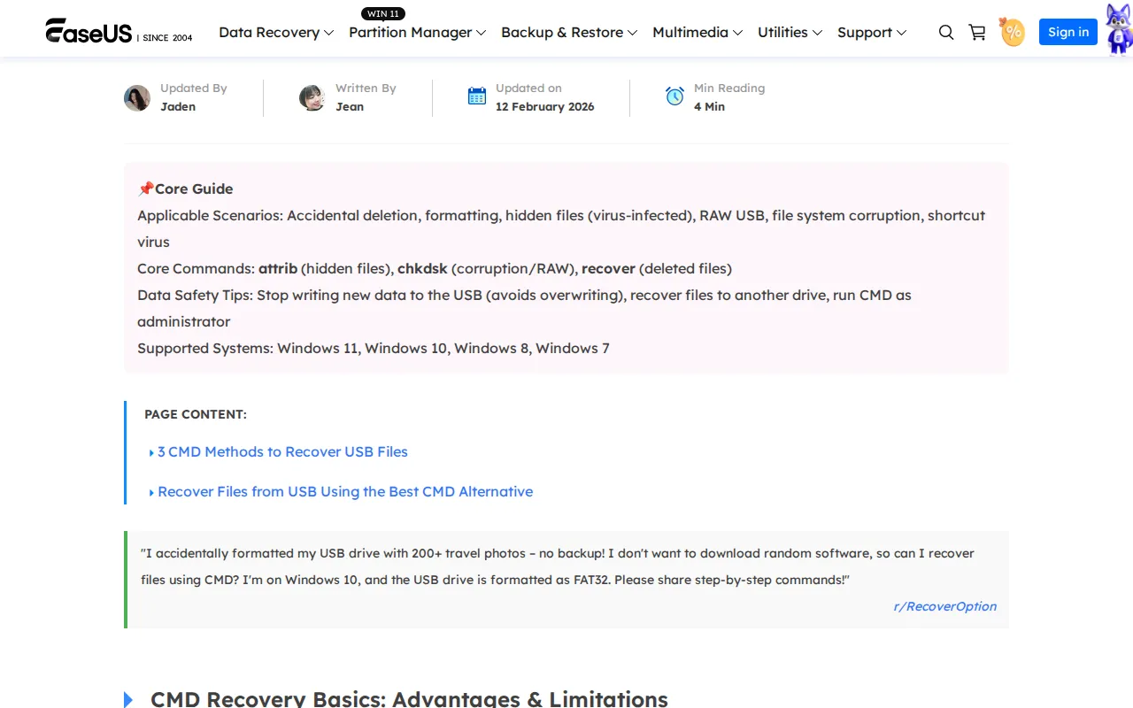

Source: EaseUS
“chkdsk drive letter: /r/f (e.g., chkdsk d: /r/f)”
Screenshot of EaseUS website showing the claim: "chkdsk drive letter: /r/f (e.g., chkdsk d: /r/f)..."Click to enlarge screenshot
EaseUS page screenshot
View archived copy
Original: https://www.easeus.com/data-recovery-solution/command-prompt-for-data-recovery.html
Captured 2026-03-23
The Reality
An I/O Device Error on an external drive frequently indicates internal head failure, firmware module corruption, or a degraded USB bridge controller. A RAW partition in Windows often means the OS cannot read the Master Boot Record or volume boot sector due to physical degradation. Running CHKDSK /r on a RAW partition commands the utility to rebuild a file system tree over a physically failing surface.
Why This Matters
On external drives, the /x flag forces dismount and the /r flag forces sustained scanning. An unstable USB bridge connection will likely drop mid-write, corrupting the $MFT and rendering the partition permanently unmountable.
Remove the drive from its external enclosure and connect it directly via SATA to a hardware imaging tool. If the drive itself has no SATA connector, the bridge is part of the drive PCB and there is nothing to connect a SATA cable to. Imaging then runs over its own USB interface with a tool that issues ATA passthrough commands, or through board-level work on the PCB. See our hard drive data recovery service for pricing.
Source: ATA I/O error specification; USB Mass Storage Class specification

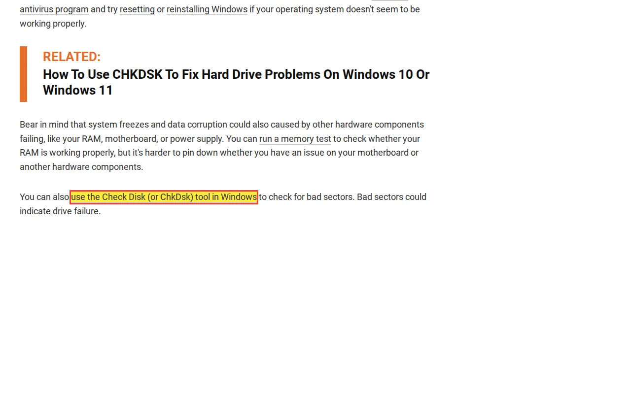

MakeUseOf lists CHKDSK as a 'hard drive health check app,' instructing users to 'type chkdsk C: /f /r to scan your main drive' with no data loss warning. How-To Geek recommends using 'the Check Disk (or ChkDsk) tool in Windows to check for bad sectors' on a drive that is 'making weird sounds.'
Source: How-To Geek
“You can also use the Check Disk (or ChkDsk) tool in Windows to check for bad sectors. Bad sectors could indicate drive failure.”
Screenshot of How-To Geek website showing the claim: "You can also use the Check Disk (or ChkDsk) tool in Windows ..."Click to enlarge screenshot
How-To Geek page screenshot
View archived copy
Original: https://www.howtogeek.com/341268/what-to-do-when-your-hard-drive-fails/
Captured 2026-03-23

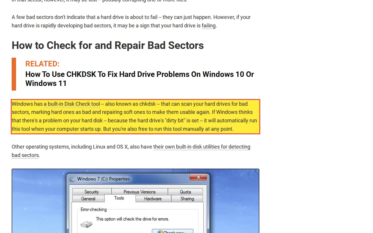

Source: How-To Geek
“Windows has a built-in Disk Check tool -- also known as chkdsk -- that can scan your hard drives for bad sectors, marking hard ones as bad and repairing soft ones to make them usable again.”
Screenshot of How-To Geek website showing the claim: "Windows has a built-in Disk Check tool -- also known as chkd..."Click to enlarge screenshot
View archived copy
Original: https://www.howtogeek.com/173463/bad-sectors-explained-why-hard-drives-get-bad-sectors-and-what-you-can-do-about-it/
Captured 2026-03-23
The Reality
CHKDSK does not perform passive health checks or non-destructive reads. It performs active, destructive file system writes. 'Weird sounds' (clicking, grinding, beeping) from a mechanical drive mean the fault is in hardware, and the sound does not identify which part. Commanding the actuator to sweep the platters during an active mechanical failure accelerates media scoring and head destruction.
Why This Matters
Readers who follow this advice convert recoverable mechanical failures into permanent platter damage. The CHKDSK scan generates metallic particulate debris throughout the drive chassis.
A drive making unusual sounds should be powered off immediately and diagnosed on hardware rather than scanned. Where that diagnosis finds damaged heads, the recovery needs a ULPA-filtered clean bench, matched donor heads, and sector-level imaging with PC-3000.
Source: SMART diagnostic specification; HDD acoustic failure mode documentation
