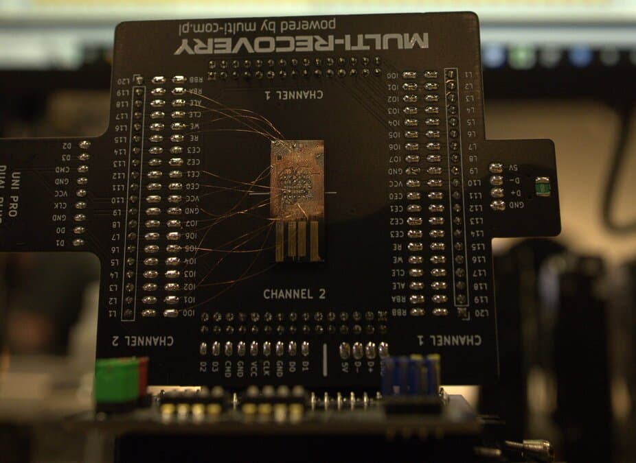

MicroSD cards are monolithic: controller and NAND memory sealed in one package. When the controller fails or the contacts break, no card reader will detect it. We bypass the controller by wiring directly into the NAND test points and reading the raw flash memory using PC-3000 Flash.
Monolithic microSD card wired to spider board adapter for direct NAND extraction

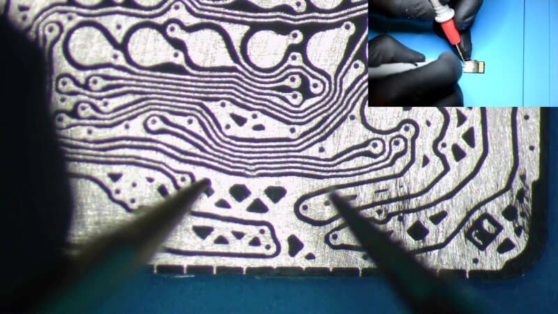

Monolithic recovery requires scraping away protective epoxy, locating microscopic pinouts, soldering hair-thin wires, and reading the raw NAND on dedicated lab hardware such as PC-3000 Flash.
Exposed copper traces of a monolithic microSD card under microscope
Exposed internal copper traces of a monolithic microSD card, ready for direct NAND access wiring.

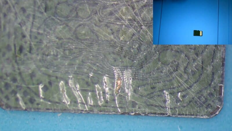

  1. 1
    Physical Inspection
    Every recovery starts under a microscope. We inspect the card's contact pads for scratches, corrosion, or cracks in the plastic shell. We check whether the controller is responding or if the internal trace connections are severed.
    This inspection determines whether a simple contact repair might work or if full chip-off extraction is required.
    MicroSD card under microscope during initial damage assessment
    MicroSD card inspection under microscope before recovery.
  2. MicroSD card with protective epoxy removed, exposing copper test points
    2
    NAND Interface Exposure
    We sand away the protective epoxy coating on the card's underside to reveal the copper test points that connect to the NAND die. This uses fine sandpaper starting at 1000 grit and progressing to 2500 grit to avoid gouging the traces.
    One chance only
    One slip gouges a trace and renders the data unrecoverable. This decapsulation step can take hours on its own.

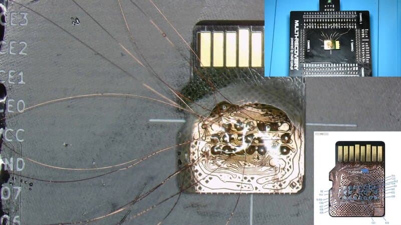

    With the test points exposed, we solder fine wires to each pad and connect them to a spider board adapter on PC-3000 Flash. The reader sends low-level commands directly to the NAND die, leaving the card's controller out of the path entirely.
    The result is a raw memory dump: every page of NAND data, including spare area bytes, read sequentially. A 128 GB card produces a dump that takes hours to complete with multiple verification passes.
    Spider-web wiring connecting a monolithic microSD card to PC-3000 Flash for direct NAND extraction
    Spider-web wiring from monolithic microSD to PC-3000 Flash adapter: each wire maps to a NAND signal line.

Spider Board
A precision hardware adapter designed to interface with NAND signal lines on a monolithic chip. The adapter routes these signals to PC-3000 Flash for data extraction.
