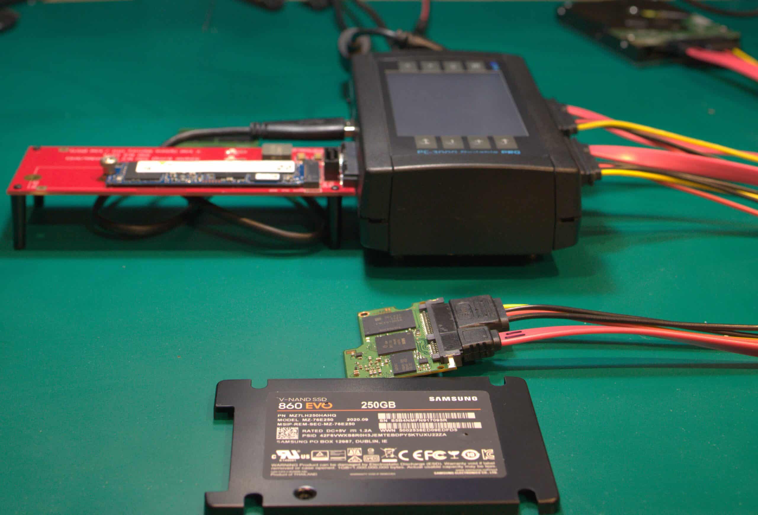

SSD recovery uses firmware platforms, soldering stations, and thermal diagnostics instead of cleanroom equipment. PC-3000 SSD accesses controller diagnostic mode for firmware reconstruction. Hakko microsoldering stations replace failed components; FLIR thermal cameras locate shorted ICs without applying power long enough to cause further damage.
SSD failures are electronic, not mechanical. The tools below are what we use daily at our Austin lab for controller repair, firmware rebuilding, and NAND imaging.
PC-3000 SSD
ACE Lab's SSD-specific firmware recovery platform. Accesses technological mode on Phison, Silicon Motion, and Marvell controllers for service area reconstruction and flash translation layer rebuilding.
Microsoldering Stations
Hakko FM-2032 irons on FM-203 base stations, Atten 862 hot air rework, and Zhuo Mao precision BGA rework. Used for controller replacement, capacitor repair, and NAND chip-off when desoldering is required.
FLIR Thermal Imaging
Identifies shorted components, failed voltage regulators, and overheating controller ICs without applying power long enough to cause further damage. Pinpoints the fault before a single solder joint is touched.

No stock photos. Watch SSD recoveries on YouTube, where firmware is rebuilt and components are replaced on camera, start to finish. The channel has 2.64M subscribers.

We use PC-3000 Portable III for firmware-level repair and Hakko FM-2032 microsoldering stations for component-level board work. Free evaluation, firm quote before paid work.
  • $Cost: SATA SSD recovery runs $200–$1,500 depending on failure type. Firm quote after a free evaluation.
  • Equipment: PC-3000 Portable III, FLIR thermal cameras, and Hakko FM-2032 microsoldering stations on FM-203 base stations.
  • Guarantee: No data recovered = no charge. Free evaluation. No diagnostic fees.

What Equipment Does SSD Board Repair Use?
  • A Hakko FM-2032 microsoldering iron on an FM-203 or FX-951 base station handles the fine-pitch rework on the controller, PMIC, and power rails.
  • An Atten 862 hot air rework station preps for chip removal and reflow.
  • A Zhuo Mao precision BGA rework station handles the controller reball when the controller itself has to come off.
  • A FLIR thermal camera locates the shorted component before any iron touches the board.
Once the controller is powered and stable, the drive is imaged through PC-3000 SSD or PC-3000 Portable III to reconstruct the flash translation layer and pull the logical file system. That sequence is what the tiers above pay for. All of it happens in-house at the Austin, TX lab.

PC-3000 SSD with SSD Extended add-onController-level SATA and NVMe access, firmware reconstruction, translator rebuilds
PC-3000 Portable III and Portable PRODrive imaging with per-sector read control and read-retry handling on degraded NAND
FLIR thermal camerasLocating shorted controllers and power-path components on dead boards
Zhuo Mao BGA rework stationsController and NAND chip removal and transplant when board repair requires it

At that point, PC-3000 forces the failed controller into diagnostic mode (Techno Mode), injects a working firmware loader, and rebuilds the translator from NAND metadata. For drives with severe NAND degradation or charge retention loss, we apply controlled heat to shift voltage thresholds back into readable range; a technique demonstrated in our NVMe recovery walkthrough.
Recovery steps
What Does the SSD Recovery Process Look Like Step by Step?
SSD recovery follows five stages: current profiling to identify shorts, safe mode access to prevent garbage collection, translator rebuilding to reconstruct the NAND address map, multi-pass imaging with adjusted read parameters, and file system extraction to a target drive. Each stage isolates a distinct failure class, from shorted PMICs to corrupted flash translation layers.
Every SSD that arrives at our Austin lab goes through these diagnostic and repair stages. The specific path depends on the failure type, but the workflow is consistent.
  1. Current Profiling: We connect the SSD to a bench power supply with current limiting and measure draw at 5V (2.5" SATA) or 3.3V (M.2 NVMe). A healthy SSD draws minimal current at idle but shows initialization spikes when it tries to load firmware. A shorted PMIC or controller pulls well above normal and shows as a hot spot on our FLIR thermal camera within seconds. This tells us whether the failure is a short circuit (needs component replacement) or a firmware/logical issue (needs PC-3000).
  2. Safe Mode Access (ROM Mode / Pin Shorting): A failing NVMe or SATA controller left to power up normally will attempt to load its corrupted firmware and may execute background garbage collection, permanently erasing NAND blocks flagged by prior TRIM commands. To prevent this, we physically isolate the controller from the NAND by shorting specific Vout or clock pins on the PCB before applying power.
    This forces the controller into a minimal ROM mode (called "Techno Mode" on Phison, "Test Mode" on Silicon Motion) where it accepts commands but does not execute autonomous background tasks. Modern Samsung NVMe controllers are controller-bound and have no equivalent loader-based factory-access mode, so recovering a modern Samsung SSD depends on board-level repair of the original controller rather than the loader path below.
    Once in ROM mode, PC-3000 Portable III uploads a custom microcode loader directly into the controller's RAM. This loader replaces the corrupted on-NAND firmware with a minimal instruction set that enables stable, single-channel read access to the flash. With the loader active, the controller responds to vendor-specific commands without running garbage collection, wear leveling, or TRIM execution, preserving every NAND block in its current state for imaging.
  3. Translator Rebuilding: PC-3000 scans raw NAND metadata to reconstruct the flash translation layer (FTL), which maps logical addresses to physical NAND pages. Without this map, the drive cannot locate any files. The rebuild process reads spare area bytes from every NAND page to piece together the correct logical-to-physical mapping.
  4. Multi-Pass Imaging: Using PC-3000 Data Extractor, we image the SSD sector by sector. Sectors that fail on the first pass get queued for retry with adjusted read parameters. For degraded NAND, we apply thermal stabilization to shift voltage thresholds into a readable range. The result is a sector-by-sector clone on a target drive.
  5. File System Extraction: We mount the cloned image, verify file integrity, and transfer recovered data to the customer's choice of media. The original failed SSD is returned or securely retired per the customer's instructions.
