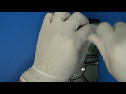

Watch a Real WD Recovery
What Does a WD Hard Drive Recovery Look Like?
A WD recovery video should show diagnosis before extraction. This walkthrough covers a Western Digital drive that would not power on because a shorted 12V TVS diode followed an overvoltage event, then shows component removal and data recovery after the electrical fault is isolated.
This walkthrough covers a WD drive that would not power on due to a shorted 12V TVS diode from overvoltage. The video shows the full diagnosis, component removal, and data recovery.
