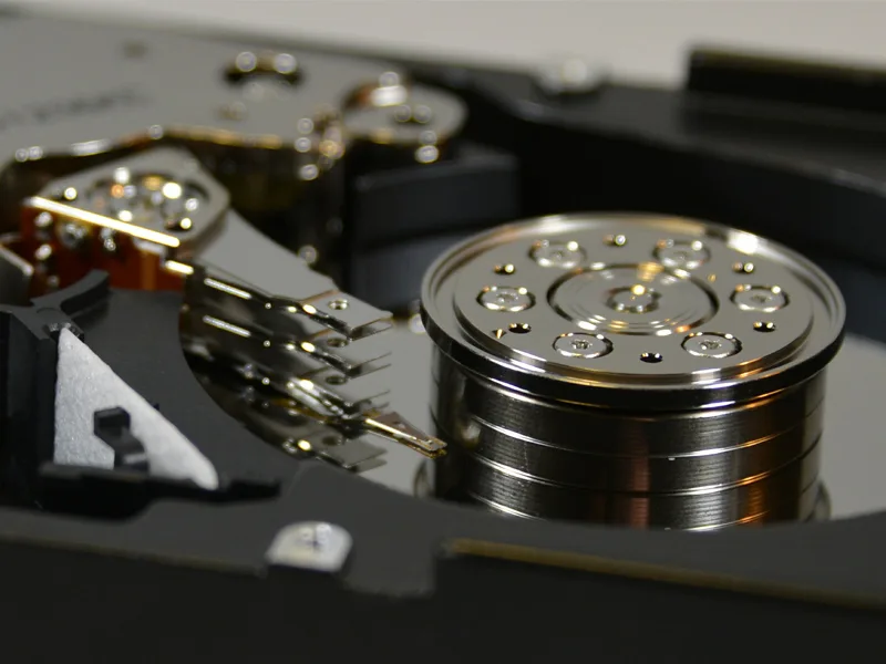

Clean bench head swaps and platter work for clicking or beeping drives with physical head damage, performed under ULPA-filtered laminar flow bench with 0.02 micron ULPA filtration

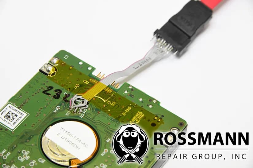

Almost no consumer can do a PCB swap on a modern drive, and here's what real hard drive repair looks like when we do one. Modern HDDs store boot code and calibration unique to that drive, including head-specific adaptive parameters, on an 8-pin SPI flash ROM on the PCB.
Modern PMR heads keep a baseline aerodynamic clearance of a few nanometers and use thermal fly-height control to hold the transducer at an active magnetic spacing of about 1 to 2 nanometers. A donor PCB without the patient's ROM won't initialize the drive, because the adaptive parameters in that ROM belong to this drive's own heads.
We move the original ROM, or its contents, to a family-matched and firmware-matched donor board, and only then power the drive long enough to image it on the DeepSpar. Firmware-tier work follows the same logic: translator rebuilds, P-list and G-list edits, and module repairs such as WD Module 32 through SA access on the PC-3000 Portable III, performed in service of the image rather than to return a working disk to you.

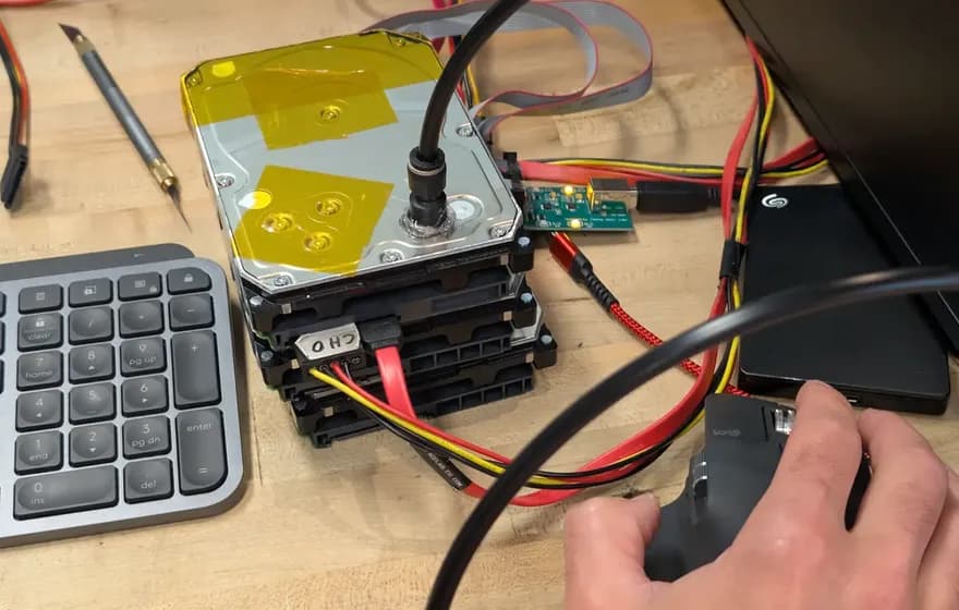

If a drive is mechanically stable, we image it before we try any repair. The PC-3000 Portable III and DeepSpar Disk Imager pull a head-by-head, sector-by-sector image with head-map control, so good surfaces are read first and weak surfaces last. We only do a head swap when bench diagnosis shows the read/write heads, not the firmware, have failed.

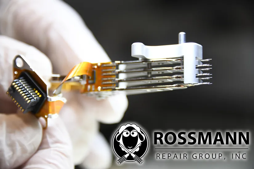

Head swaps run on a 0.02 micron ULPA-filtered laminar flow bench with a donor matched to the family, head map, and firmware revision; platter handling stays inside that bench from de-lid to image. We handle firmware faults through SA module access on the PC-3000 rather than mechanical work. Standard pricing tiers run $100–$2,000. If we can't read the files off, there's no recovery fee. That's our no-data, no-recovery-fee policy.
Hard drive jobs in our Austin lab go through four procedures.
First, PCB ROM transfer with a board-revision-matched donor, when the original board is dead or has a burned TVS diode. We move the 8-pin SPI flash that holds the drive's own adaptive parameters, or its contents, to a family, firmware, and board-revision-matched donor before we apply any power. A donor PCB without the patient ROM won't initialize the drive.
Second, head and media work on the 0.02 micron ULPA-filtered clean bench when bench diagnosis shows the heads have failed. Third, firmware service-area edits on the PC-3000 Portable III for translator rebuilds, P-list and G-list repairs, and module-level fixes that bring the drive back into a readable state.
Fourth, physical imaging on the DeepSpar Disk Imager once the drive is stable enough to read, with head-map control sequencing the strongest surfaces first. Hard drive recovery and HDD data recovery describe the same four-step workflow; the original drive is never the deliverable, the image is.

    Clean-Bench Mechanics
    For failed or stuck heads, we do an exact-match donor head swap on the 0.02 micron ULPA-filtered laminar clean bench. Whenever an HDD data recovery case needs mechanical work, the donor has to match the patient drive's preamp revision, head map, and firmware. A simple PCB or head swap without this matching step won't work.

  2. Inspect the tribological stack for scoring or contamination from DIY attempts. The damaged head stack is removed using head combs to prevent any slider from contacting platter media during extraction. Platter surfaces are then inspected under magnification to map zones with visible scoring or magnetic layer removal. Metallic shavings, carbon debris, and displaced lubricant from prior opening attempts are catalogued before cleaning begins.
  3. Perform the donor-matched head swap on the clean bench. We clean debris off the platter surfaces inside the laminar flow zone of the 0.02 micron ULPA bench. Then we guide a donor head stack assembly, matched on preamp revision, head map, and firmware, onto the load/unload ramps with head combs so no slider contacts platter media during seating.

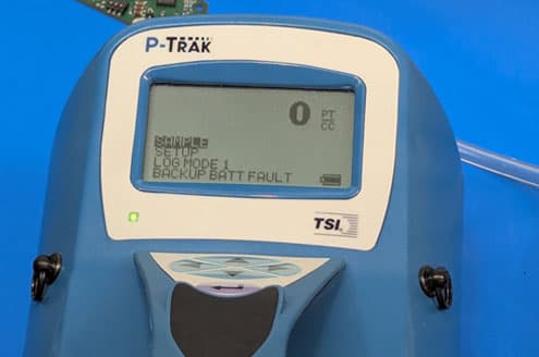

0.02 micron ULPA clean bench
A laminar flow bench fitted with a 0.02 micron ULPA filter. The 0.3 micron figure quoted for HEPA filters is their most penetrating particle size, the point of minimum efficiency, not the smallest particle they stop.

Donor-matched head swap
A mechanical recovery procedure that replaces a failed head stack assembly with a compatible donor. Before any swap, we check the donor drive against its head map, preamp silicon revision, and firmware, plus the site code on Seagate drives.

Is It Safe to Open a Hard Drive at Home?
Opening a hard drive outside a filtered environment introduces particles larger than the head flying height into the sealed head-disk assembly. The table below shows how the failure mode and outcome differ between a home opening and the 0.02 micron ULPA-filtered clean bench used in our Austin lab.
ScenarioFailure ModeOutcome
Home / unfiltered room openingDust particles larger than head flying height contact platter surface on spin-up; head slider contacts platter and strips magnetic recording layerMetallic and carbon debris circulates inside the sealed HDA, scoring data tracks
0.02 micron ULPA clean bench (Austin lab)Laminar airflow through the 0.02 micron ULPA filter keeps ambient particulates away from the open chassisPlatter surfaces remain clean during head stack transfer; donor heads seat on ramps via head combs without slider-to-platter contact; imaging proceeds on surviving data tracks
If your drive has already been opened outside a clean bench, notify us before shipping. Previously opened drives require platter surface inspection and cleaning before a donor head stack can be safely installed. This adds time to the recovery but does not always change the pricing tier.
From PCB diagnostics to PC-3000
From PCB Diagnostics to PC-3000 Platter Imaging
Component-level PCB repair restores power-on electrical viability so a drive can boot its own microcode. It is the prerequisite for PC-3000 firmware work, not a substitute. PCB rework does not decrypt user data or alter hardware encryption on SED or OPAL drives.
Why a Bare PCB Swap Fails on Modern Drives
Modern hard drives store boot code and unique factory calibration data in a SOIC-8 serial flash ROM on the PCB, including head-specific adaptive parameters and servo calibration tables. These values are tuned to the specific physical head stack assembly inside the patient drive.
A donor board booted with its own ROM will not initialize the patient drive.
When a Transient Voltage Suppression (TVS) diode shorts to ground after an overvoltage event, or a motor driver IC burns open, the recovery workflow starts at the bench supply with a multimeter in diode mode and a FLIR thermal camera to localize the fault. The shorted diode is removed with an Atten 862 hot air station; the SOIC-8 ROM is desoldered with hot air and soldered onto an identical donor board using a Hakko FM-2032 micro-soldering iron.
This restores power-on electrical viability so the drive can load its own Service Area microcode. It does not decrypt user data or alter hardware encryption. See PCB diagnostics versus logic board repair and water damaged drives with corroded SPI pins.

Modern PMR read and write heads hold a baseline aerodynamic clearance of a few nanometers on an air bearing, and use Thermal Fly-height Control to protrude the transducers to an active magnetic spacing of 1 to 2 nanometers.
The bench on the equipment list is a 0.02 micron ULPA-filtered laminar clean bench, and that filtration rating is what the open-drive work is specified on.
ISO 14644-1 specifies particle concentration per cubic meter of air. Vertical laminar flow pushes filtered air downward across the open chassis, deflecting room contaminants and operator shedding away from the exposed platters.

Imaging and firmware tooling
The PC-3000 Portable III runs directly on the clean bench. It accesses each drive through vendor-specific commands rather than the standard ATA stack, which is what makes Service Area work possible after a head swap.
On Western Digital Marvell architectures the engineer transfers Module 47 adaptive parameters from the patient ROM, edits the physical head map in Module 0A, and rebuilds Module 190 translator tables on SMR families. On Seagate F3 drives the same hardware connects to the diagnostic UART at 38400 baud to reach the F3 T> prompt for SysFile 28 and media cache map work on Rosewood and other shingled platforms.
The PC-3000 Express sits on a dedicated PCIe card in a separate workstation with four SATA diagnostic ports and two legacy PATA ports.
The DeepSpar Disk Imager runs on a separate PCIe imager and talks to the drive at the SATA PHY layer, below the host operating system. We set millisecond-level hardware timeouts so a read on a weak track is cut off instead of waiting out the drive's own retries.

Open-drive work at this lab runs on a 0.02 micron ULPA-filtered laminar clean bench. Vertical filtered airflow pushes airborne particles down and away from the work surface for as long as the drive is open.
What air reaches the open chassis during a head stack swap?
During a head stack transfer the platters are exposed only to the air immediately above them. Vertical laminar flow pushes ULPA-filtered air downward across the open chassis at a consistent face velocity, deflecting operator shedding, room dust, and ambient turbulence away from the platter surfaces.
Engineering requirement at the platter level
The platters need filtered laminar airflow at the work surface, and the 0.02 micron ULPA-filtered bench gives them that.
All head-stack work, helium refill, and platter cleaning happen on this bench in Austin. For the longer-form physics breakdown see cleanrooms vs laminar flow benches, and for the step-by-step bench procedure see what a head swap involves.

  6. Selective head map imaging via PC-3000. Once mechanical stability is confirmed, the PC-3000 issues vendor-specific commands to log per-head read stability. We disable weak heads in the firmware head map and throttle read requests with imaging-utility timeouts. We image healthy surfaces first onto safe destination media, and we only go back to degraded zones after the rest of the image is locked. The DeepSpar Disk Imager handles the same role for drives that respond to ATA but degrade quickly under sustained imaging load.
  7. File extraction from the clone, not the patient. File system parsing and file extraction run from the cloned image, never from the patient drive. If the image cannot be produced the no-data-no-recovery-fee guarantee applies and the customer pays nothing except optional return shipping. The original drive is held under the customer's shipping instruction.

  1. Platter surface inspection under magnification. The damaged head stack is removed using head combs to prevent any slider from contacting platter media during extraction. Platter surfaces are then inspected under magnification to map zones with visible scoring or magnetic layer removal. Cleaning cannot recover data from an abraded zone; it prepares surviving tracks for the incoming donor heads.
  2. Debris and displaced lubricant removal. We clean debris off the platter surfaces inside the laminar flow zone of the 0.02 micron ULPA bench, where filtered air flows down across the open chassis.
  3. Donor head installation via head combs. We guide a matched donor head stack assembly, verified against head count, preamp revision, and firmware family, onto the load/unload ramps with head combs so no slider contacts platter media during seating. On helium-sealed drives, we refill the chamber with helium in-house at our Austin lab.

Gloved hand holding a six-slider head stack assembly with the preamp flex circuit visible, inspected before donor matching for a head swap
Six-head stack inspection: every slider, preamp, and ramp checked before swap.

Component-level repair is board-level diagnostic work on the hard drive PCB. We identify the ROM chip, dump it natively, and replace a shorted TVS diode. We do this work in-house.
The same microsoldering skill that fixes MacBook logic boards diagnoses an HDD PCB without guesswork.
If you searched "louis rossmann hard drive recovery" or "rossmann data recovery," the entity behind those queries is the same engineer who repairs MacBook logic boards on YouTube. The microsoldering work documented on that channel is the upstream skill that makes hard drive PCB diagnostics tractable rather than guesswork.
The bridge between the two disciplines is the hard drive PCB itself. Every modern Seagate, Western Digital, and Toshiba drive carries unique adaptive parameters in its board ROM.
Recovery work on a dead PCB starts with the same tools that come out for a logic-board repair: a Hakko FM-2032 on an FM-203 or FX-951 base, an Atten 862 hot-air rework station, and a FLIR thermal camera to map a shorted power rail before any chip leaves the board.

Do You Need a Clean Room for Hard Drive Recovery?
No. We do open-drive work on a 0.02 micron ULPA-filtered laminar clean bench, and that covers the minutes the drive is open.
Cleanroom photography sells: technicians in full spacesuits inside a “certified ISO Class 5 clean room”. Clean room classifications are defined by ISO 14644-1, which specifies maximum allowable airborne particle concentrations.
For data recovery, that level of whole-room infrastructure is marketing theater, not a technical requirement. What actually protects your platters is a 0.02 micron ULPA-filtered laminar clean bench and an image-first workflow.

Filter class is what our bench is specified on, and it is on the equipment list: a 0.02 micron ULPA-filtered laminar clean bench. That is a filtration rating for the air moving across the work surface, not a room classification, and the two are not the same measurement.
You only need clean air in the immediate work zone during the brief window when platters are exposed. A laminar bench provides that.
Handheld particle counter held in the airflow at the open work surface of the Austin lab clean bench
Particle counter in the filtered air column above the bench, before a drive is opened
Watch the particle counter run at the bench.
Bottom line: The heads do not see room air. They see the air column directly above the open chassis, and that is what a laminar bench controls. We publish which equipment does the work, we publish what each tier costs, and we film the bench. Ask any lab you are considering to do the same.
Why a Head Swap Does Not Need a Walk-In Cleanroom
Cleanroom photos are the industry's favourite trust signal, and they are a picture of a building rather than of the air over your platters. In this video Louis runs a particle counter at the laminar flow bench so you can watch the number the heads actually depend on.

When a WD drive suffers a PCB failure (power surge, shorted TVS diode, blown motor driver), a simple board swap will not work. The replacement PCB has its own ROM data that does not match the patient drive's platter calibration.
On boards that have a separate 8-pin ROM chip, we desolder the chip from the dead board and transfer it to the donor board.

SMR-Aware Intake Procedure With PC-3000 Portable III
On any drive we identify as device-managed SMR, the first thing we do is lock the user area against background firmware writes with PC-3000 Portable III firmware utilities.
With the user area locked, we read the translator structures into the PC-3000 module database: Module 190 on Western Digital SMR drives, and the Media Cache Management Table on Seagate SMR drives.

Before removing the failed heads, we inspect the platters under our 0.02 µm ULPA-filtered clean bench. We look for two things: scoring (visible scratches from a head crash) and particulate contamination (debris from degraded heads circulating inside the HDA).

Removing and installing the head stack assembly requires separating the heads from each other without letting them contact platter surfaces. We use head combs sized for each drive family.

Platter Decontamination Before Donor Installation
When heads crash, the slider gouges the ferromagnetic coating off the platter surface. The resulting debris circulates inside the sealed HDA and embeds itself in undamaged tracks. Installing donor heads into a contaminated enclosure destroys the new stack. The particles act as microscopic abrasives between the head and the platter surface.
Our approach is non-destructive. Under the 0.02 µm ULPA-filtered clean bench, we lift loose particulate from surviving platter surfaces. Zones where the coating is physically gone are mapped and excluded from the imaging plan. After cleaning, we disable the head assigned to the destroyed surface via PC-3000 firmware and image only the surviving platters with the donor stack.
The lab documents non-destructive decontamination and head-stack work through filmed platter swaps. If decontamination and donor imaging do not return the data, the no data, no recovery fee guarantee means the evaluation and mechanical attempt cost nothing. Lab-wide customer feedback sits at 4.9 stars across 1,837+ Google reviews, which aggregates outcomes across all recovery workflows.

Platter Decontamination Sequence
After a head crash, we clean the surviving platter surfaces before donor heads go in.

A clean-bench head swap replaces a failed head stack assembly inside a 0.02 micron ULPA-filtered laminar flow bench. Donor selection requires matching the HSA by model family, firmware revision, and preamp silicon revision.
Head combs keep each slider off platter media during extraction and seating.

ROM Patching for Diagnostic-Locked Seagate F3 Drives With PC-3000 Portable III
PC-3000 Portable III bypasses the diagnostic lock by dumping the SPI ROM and injecting an unlock patch into RAM, without altering the physical SPI flash.
Modern Seagate F3 drives, including Rosewood and Barracuda families, ship with the diagnostic terminal locked by default. The lock is a firmware-level security feature, not mechanical damage. The platters spin, but the ARM Cortex bootloader blocks vendor-specific commands over the UART serial interface, preventing access to the Service Area System Files required to rebuild damaged translators.
Once the ROM is in PC-3000 RAM, the Seagate F3 utility analyzes the firmware revision family and generates an unlock patch matched to that revision. The patch is injected into controller volatile RAM, not the physical ROM. The SPI chip remains in its factory state. Power-cycling the drive removes the patch and restores the diagnostic lock.
The patch restores diagnostic-terminal access for Service Area repair. It does not decrypt user data and it does not bypass a drive's SED or ATA password lock; where the media is encrypted, the original credentials are still required.

ROM Extraction and Re-Injection via PC-3000 Portable III
Two situations force a ROM-level workflow. The first is a drive whose PCB is damaged badly enough that the original board cannot boot the spindle: a shorted TVS diode, a burned motor driver, or a cracked solder joint on the controller. The second is an architecture such as Western Digital where a generic donor PCB cannot drive the patient heads until the patient’s adaptive ROM contents are transferred onto the donor.
The extraction itself is component-level rework. The flash chip is desoldered under a microscope with a Hakko FM-2032 precision iron on an FM-203 or FX-951 base station or removed with an Atten 862 hot-air rework station with a shielded nozzle. We read the chip on a programmer and write its contents onto the donor board's ROM.

The DeepSpar Disk Imager is the hardware we use to do that extraction. It operates as an independent host bus adapter on the bench, bypasses the host BIOS and operating system, and controls every read at the ATA command layer.

DeepSpar Imaging Parameters for a Marginal Drive
DeepSpar Disk Imager controls every read at the ATA command level, which lets us tune the following parameters per drive and per imaging phase. The settings below are starting points; actual values are adjusted by the technician based on how the patient behaves on the bench.
  • Read timeout in milliseconds. If the drive does not return the sector within the configured window, DeepSpar aborts the read. The sector is logged as bad, and the imager advances.
  • Hardware PHY reset and COMRESET. When a drive hangs mid-read, DeepSpar issues a COMRESET or hardware power-cycle to unfreeze the SATA link.
  • Variable read block size. The initial pass uses large multi-sector blocks to maximize throughput on healthy zones. When an error is detected, the imager returns to that block in a later pass with the block size dropped to 1 sector, which isolates the bad LBAs without discarding the healthy sectors that surround them.
  • Background auto-relocation disabled. DeepSpar commands the drive to suppress the firmware's internal reallocation of sectors flagged as weak. Auto-relocation writes to the service area, consumes spindle time, and can corrupt the translator if it fires during imaging of a drive with a damaged G-list.
  • Healthy heads first. The imager pulls all data mapped to healthy heads before it attempts the degraded head, which means the bulk of the drive is safely cloned before the weak head is ever used.
Every one of these settings is aimed at the same goal: pull the maximum amount of data off the drive while giving the damaged heads and platters the minimum amount of work.

Opened Before Intake
Contamination after uncontrolled opening
If a hard drive is opened outside a clean bench, platter contamination changes the job. The workflow becomes platter inspection, surface cleaning, donor head matching, and conservative DeepSpar imaging.
$1,200–$1,500 to $2,000
Watch clean-bench work →
Head swap recovery
If read/write heads fail on an enterprise HDD, donor matching checks firmware revision, head map, preamp family, and adaptives before the head stack is transferred.
$1,200–$1,500
Watch head swap case →
Green light, no detection
If a drive powers on but never identifies, PC-3000 terminal access checks BSY state, ROM compatibility, SA module integrity, and translator access before imaging starts.
$600–$900
Watch the workflow →

Service Area Firmware Repair on the PC-3000 Portable III
A healthy-sounding drive that reports the wrong capacity or hangs Busy can have a corrupted Service Area. Repair runs on the PC-3000 Portable III using vendor-specific interfaces: UART for Seagate F3 and SATA commands for WD Marvell.
The repair workflow uses vendor-specific ATA commands routed through the PC-3000 Portable III rather than any host-OS storage driver. For a longer description of how hard drive firmware works end-to-end, and a separate page on what PC-3000 actually does at the hardware level, see the linked technical references.

Why a PCB swap alone fails: adaptive parameters and ROM extraction
The bootstrap ROM on a modern hard drive PCB holds more than the initial loader. It also stores adaptive parameters calibrated for the exact head stack inside that specific drive at the factory. The parameters tune the PRML read channel for each head individually and include:
  • Microjog corrections for off-track positioning
  • FIR equalizer tap coefficients
The right way is to desolder the original SPI flash ROM and reflow it onto the donor, or extract the ROM contents on a programmer and write them to the donor board's ROM.
