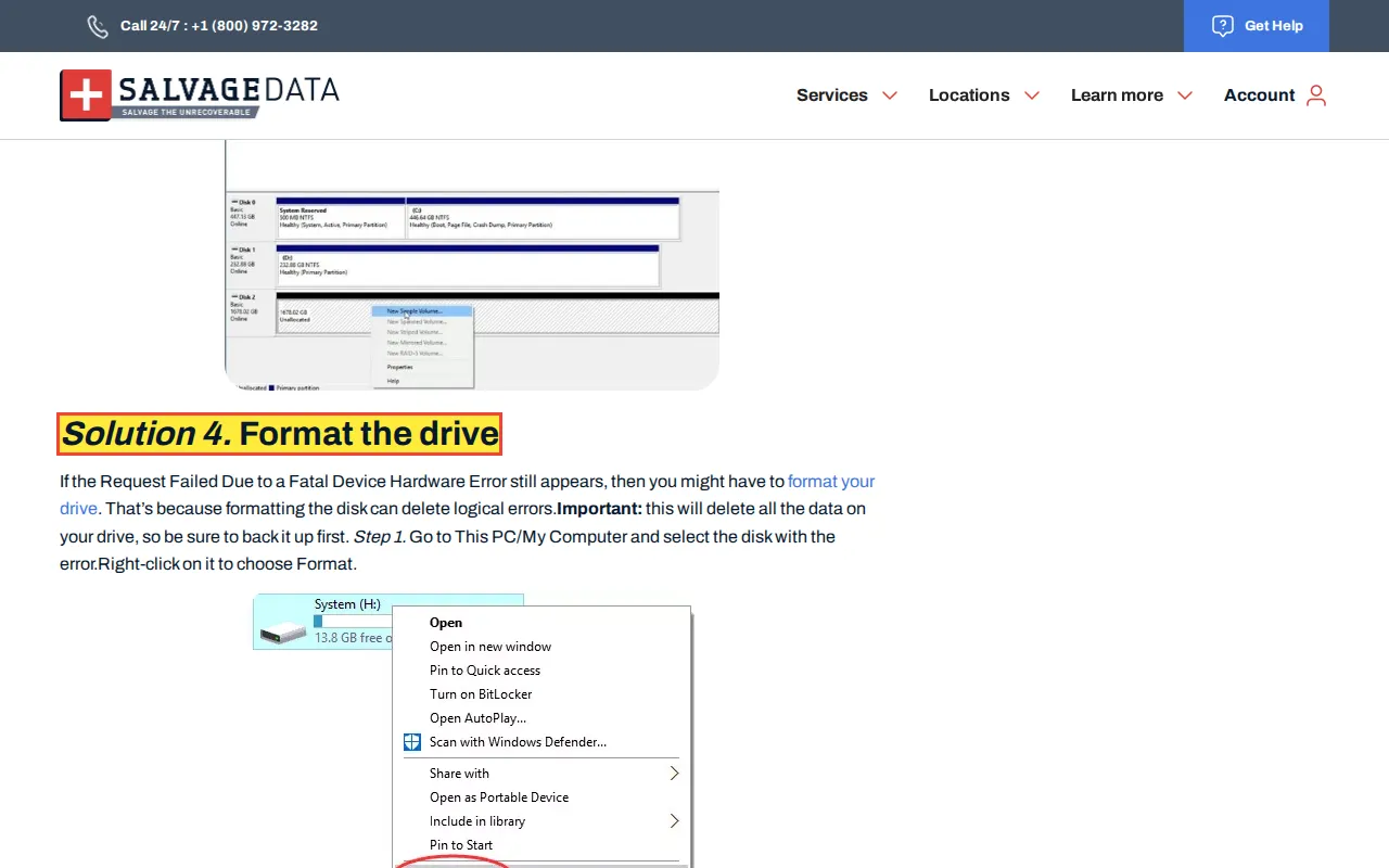

Should you format a drive to fix a fatal hardware error?
1The Claim
“Format the drive If the Request Failed Due to a Fatal Device Hardware Error still appears...”
Source: https://www.salvagedata.com/blog/fatal-device-hardware-error-solutionView archived source
Screenshot of https://www.salvagedata.com/blog/fatal-device-hardware-error-solution showing the quoted claim
2The Reality
A format command writes a new, blank file system over the existing partition. The Master File Table (MFT), the critical index that maps every piece of data to its physical location on the disk, is overwritten. On a drive already reporting hardware errors, the intense write operations push the degraded hardware toward total failure. Formatting a drive to "fix" a hardware fault destroys the logical map to the data while simultaneously stressing the hardware that is physically failing.
Consequence: Formatting overwrites the MFT and partition table. On a drive with hardware errors, the write operations accelerate mechanical failure while destroying the file system structures needed for recovery.

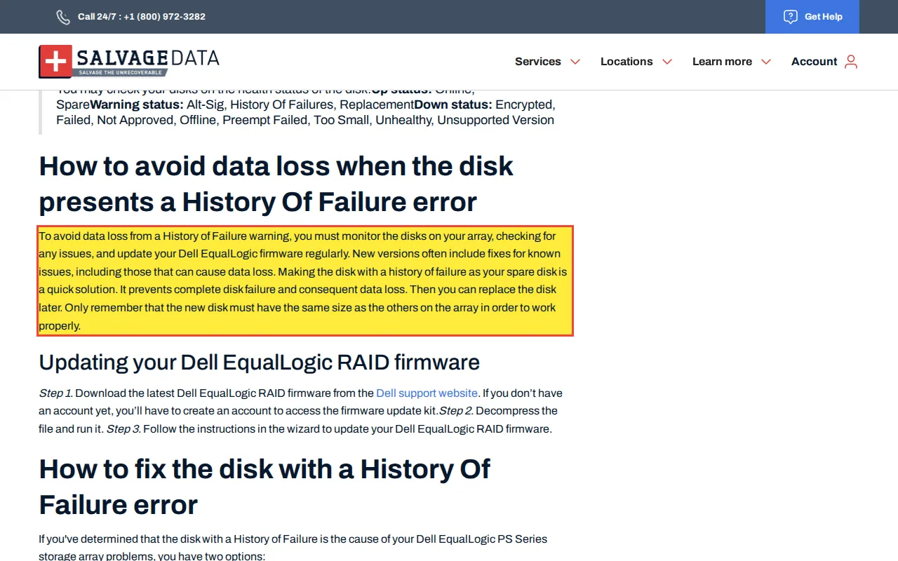

Should you use a failed drive as a RAID hot spare?
1The Claim
“Making the disk with a history of failure as your spare disk is a quick solution.”
Source: https://www.salvagedata.com/blog/fix-history-of-failure-raid-disk-errorView archived source
Screenshot of https://www.salvagedata.com/blog/fix-history-of-failure-raid-disk-error showing the quoted claim
2The Reality
A hot spare is an idle, healthy reserve drive that the RAID controller writes to during a rebuild. A rebuild is the most I/O-intensive operation a storage array performs: the controller reads every sector of the surviving healthy disks, calculates missing data via XOR parity, and writes continuously onto the spare for hours or days. Designating a drive with a documented failure history as the rebuild target guarantees a secondary failure during this process. A second drive failure during a RAID 5 rebuild destroys the entire array. For failed RAID data recovery, the correct response is to power off the array and contact a lab.
Consequence: A failed drive used as a hot spare will collapse during the rebuild, causing a multi-disk failure that destroys the entire RAID array and all data on it.

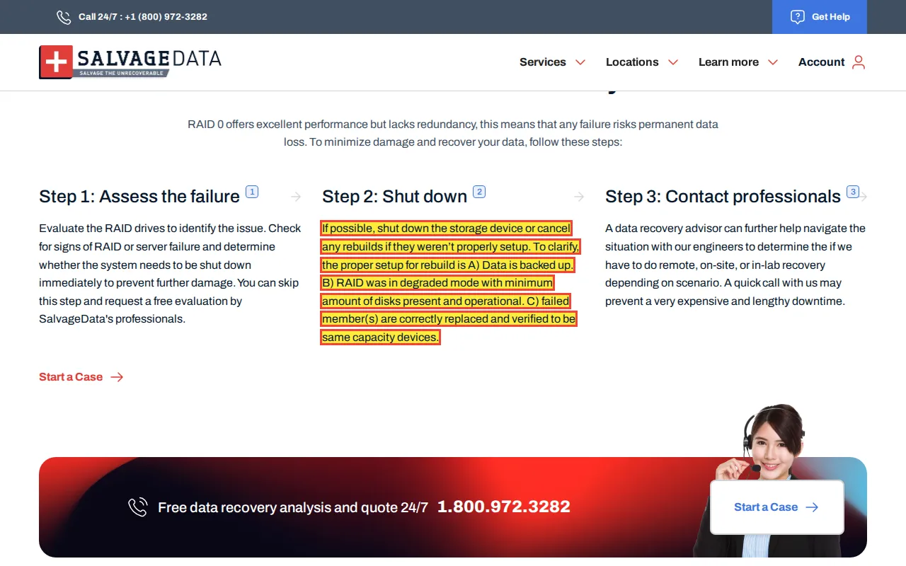

Can RAID 0 operate in degraded mode?
1The Claim
“The proper setup for rebuild is... RAID was in degraded mode with minimum amount of disks present and operational...”
Source: https://www.salvagedata.com/services/data-recovery/raid/raid-0-configurationView archived source
Screenshot of https://www.salvagedata.com/services/data-recovery/raid/raid-0-configuration showing the quoted claim
2The Reality
RAID 0 stripes data across multiple disks with zero parity and zero redundancy. If one disk in a RAID 0 array fails, the entire logical volume is destroyed because every file is missing alternating blocks of binary data. RAID 0 cannot enter a degraded mode because there is no redundant parity data to sustain operations. Claiming that a RAID 0 should be placed into degraded mode and rebuilt applies the fault-tolerant properties of RAID 5 or RAID 6 to an architecture that has none. A RAID 0 failure requires RAID data recovery where the failed member is imaged and the stripe order is reconstructed manually.
Consequence: RAID 0 has no redundancy. It cannot degrade, and it cannot rebuild. Following rebuild instructions for RAID 0 risks overwriting surviving data on the remaining member drives.

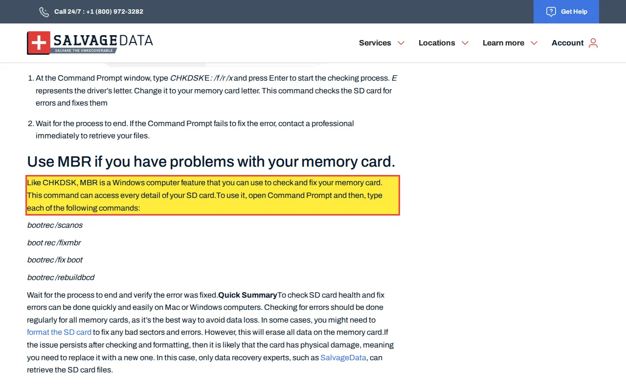

Should you run bootrec commands on an SD card?
1The Claim
“CHKDSK, MBR is a Windows computer feature that you can use to check and fix your memory card.”
Source: https://www.salvagedata.com/blog/check-sd-card-for-errorsView archived source
Screenshot of https://www.salvagedata.com/blog/check-sd-card-for-errors showing the quoted claim
2The Reality
SD cards use FAT32 or exFAT file systems. They do not contain a Windows boot partition and do not use the Master Boot Record (MBR) for operating system initialization.bootrec.exeis a Windows Preinstallation Environment utility whose sole purpose is repairing a corrupted Windows bootloader on an internal OS drive. Executing bootloader repair commands against a removable FAT32 flash storage device will yield terminal errors, and forcing an MBR overwrite on a removable card risks corrupting the partition table, rendering the media inaccessible.
Consequence: Running bootrec on an SD card is architecturally impossible and risks corrupting the partition table. The commands are designed for Windows boot drives, not removable flash storage.

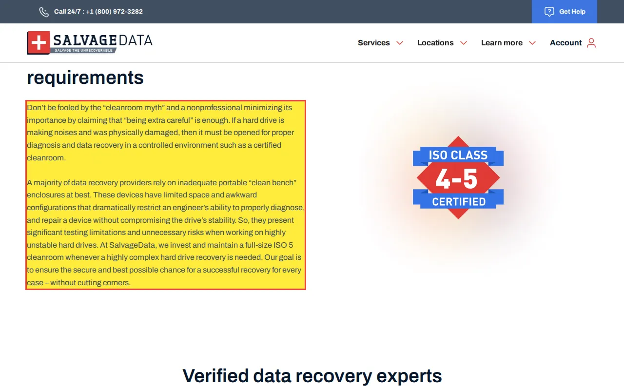

Clean Bench Filtration Accuracy Claims
Marketing claims that characterize ISO 14644-1 Class 5 clean bench filtration as inadequate for hard drive recovery.
Are clean benches inadequate for hard drive data recovery?
1The Claim
“A majority of data recovery providers rely on inadequate portable 'clean bench' enclosures...”
Source: https://www.salvagedata.com/about/certified-data-recovery/cleanroomView archived source
Screenshot of https://www.salvagedata.com/about/certified-data-recovery/cleanroom showing the quoted claim
2The Reality
Laminar flow clean benches use HEPA or ULPA filtration to wash the work surface with a continuous stream of filtered air. The physics of positive pressure inside the bench pushes contaminants away from the exposed drive. A properly rated clean bench provides ISO 14644-1 Class 5 (formerly Class 100) particle filtration across the work surface, the same standard that governs walk-in cleanroom environments. Our lab uses a 0.02µm ULPA-filtered clean bench. Characterizing this as "inadequate" ignores the fluid dynamics of laminar flow filtration. A clean bench rated to ISO 14644-1 Class 5 provides the same particle-free environment across the work surface.
Consequence: This claim implies that clean bench filtration is inadequate for hard drive recovery, which contradicts ISO 14644-1 Class 5 particle filtration standards. A properly rated laminar flow clean bench provides the same controlled environment as a walk-in cleanroom across the exposed work surface.

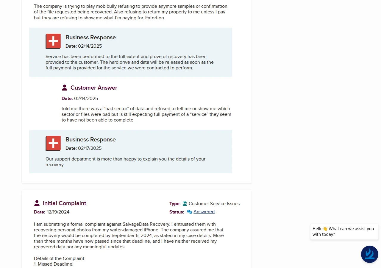

What Happens to Your Drive During a Pricing Dispute?
The Better Business Bureau profile for SalvageData documents three categories of custody complaints: drives withheld pending payment, specific dollar demands for hardware return, and media disposed of after non-payment. These complaints are filed by consumers who shipped drives to SalvageData and later disputed the quoted recovery price.
The following quotes are from complaints filed on the BBB portal for SalvageData Recovery Services in Highland Heights, Ohio.
Property Retention Until Payment
