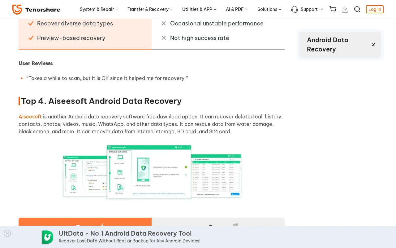

Liquid damage
Liquid Damage Myths

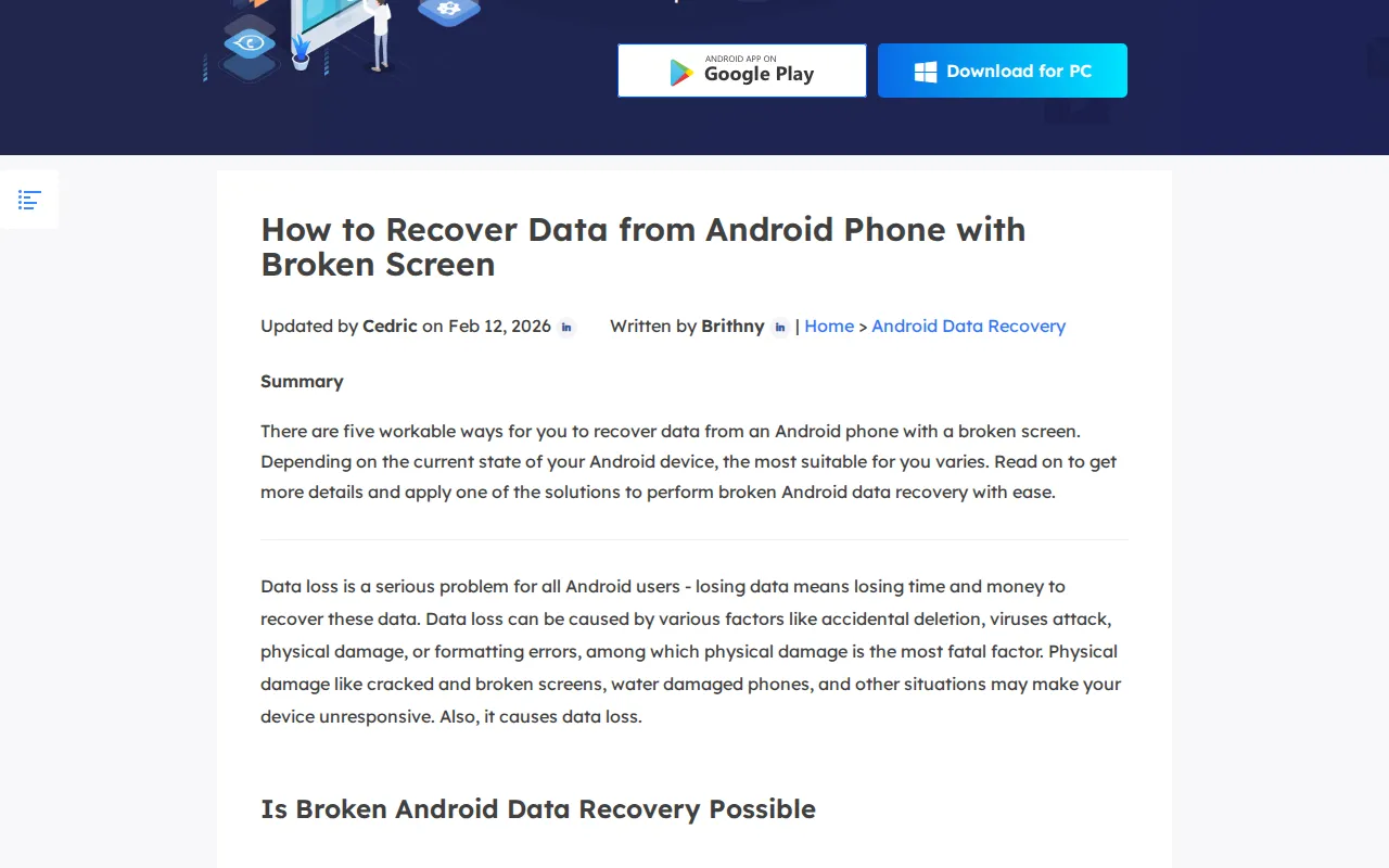

Myth 01
Should You Plug a Water-Damaged Phone into USB?
Misconception
Tenorshare, EaseUS, and other software vendors instruct users to connect water-damaged phones directly to a computer via USB cable as part of their recovery procedures. EaseUS lists water damage as a recoverable scenario for their USB-connected software. Tenorshare markets its Android recovery tool as able to 'rescue data from water damage' by connecting the phone to a PC.
Reality
Connecting a water-damaged phone to USB introduces 5V power through the charging IC. On a wet or corroded board, this voltage causes electrolytic corrosion: copper traces dissolve via anodic dissolution, and current paths short across capacitor pads to high-voltage rails.
Documented in the wild (3)
Tenorshare
“Connect your iOS device to the computer using a USB cable.”
Screenshot of Tenorshare website showing the claim: "Connect your iOS device to the computer using a USB cable...."
Tenorshare page screenshot
Archived copyCaptured 2026-03-21
EaseUS
“Physical damage like cracked and broken screens, water damaged phones, and other situations may make your device unresponsive. Also, it causes data loss. Is Broken Android Data Recovery Possible”
Screenshot of EaseUS website showing the claim: "Physical damage like cracked and broken screens, water damag..."
EaseUS page screenshot
Tenorshare
“It can rescue data from water damage, black screen, and more.”
Screenshot of Tenorshare website showing the claim: "It can rescue data from water damage, black screen, and more..."
Why this matters
Plugging in a wet phone accelerates destruction of recoverable data. Components that were repairable before power application may be destroyed within seconds.
Correct recovery procedure
The correct first step is displacement of moisture with 99% isopropyl alcohol, followed by ultrasonic cleaning in a heated bath, then board-level inspection under a stereo microscope before applying any power.
SourceElectrochemistry: anodic dissolution mechanism in the presence of dissolved ionic contaminants under DC bias

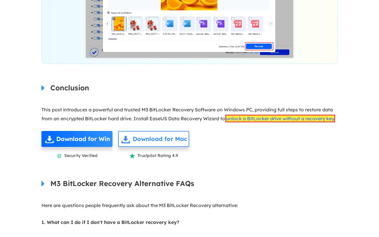

Myth 03
Can Software Unlock a BitLocker Drive Without a Recovery Key?
Misconception
EaseUS claims users can 'Install EaseUS Data Recovery Wizard to unlock a BitLocker drive without a recovery key.'
Reality
BitLocker uses AES-128 or AES-256 encryption. The 48-digit recovery key is the only fallback when the TPM-stored key is unavailable. AES encryption cannot be brute-forced; the key space is astronomically large. No commercial software can 'unlock' a BitLocker volume without either the recovery key, the original user password, or a functioning TPM that still holds the sealed key.
Documented in the wild (1)
EaseUS
“Install EaseUS Data Recovery Wizard to unlock a BitLocker drive without a recovery key”
Screenshot of EaseUS website showing the claim: "Install EaseUS Data Recovery Wizard to unlock a BitLocker dr..."
Archived copyCaptured 2026-03-22
Why this matters
The customer purchases software expecting to bypass BitLocker encryption. The software cannot decrypt AES-256. The customer wastes money and, more critically, wastes time during which they could have been searching for their recovery key backup (Microsoft account, printout, Active Directory).
Search for the recovery key: Microsoft account backup, Active Directory, Azure AD, printed copy, USB key backup. If all key sources are exhausted and the TPM is non-functional, the data is cryptographically sealed. No lab and no software can change this. EaseUS's own embedded YouTube video says at 0:45 that the user needs their BitLocker recovery key (youtu.be/-PIAkAyX7mo?t=45), directly contradicting the page headline.
SourceMicrosoft BitLocker documentation; AES specification (NIST FIPS 197)

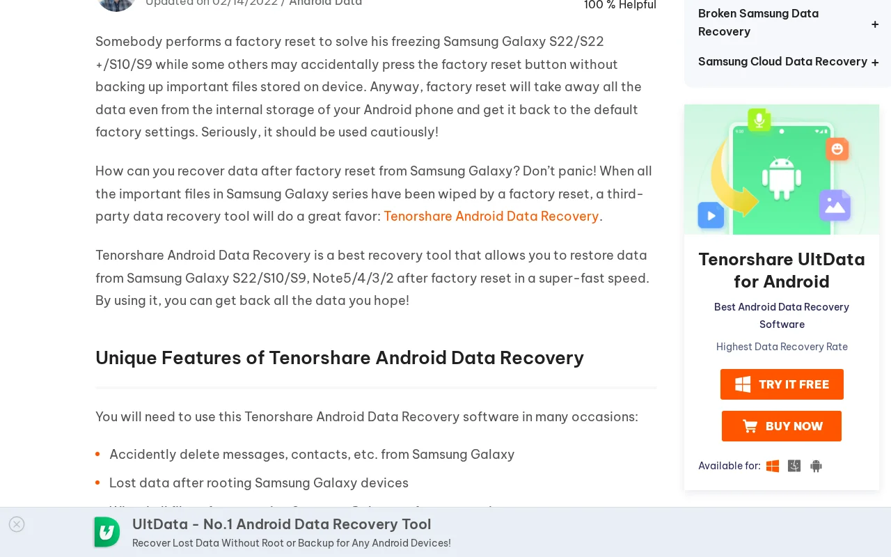

Myth 04
Can Software Recover Data After a Factory Reset?
Misconception
EaseUS claims their tool 'can help you effectively recover all personal media data such as contacts, messages, photos, videos, music files, documents lost due to factory reset.' Tenorshare claims their software 'allows you to restore data from Samsung Galaxy S22/S10/S9, Note5/4/3/2 after factory reset.' Stellar claims 'Your iPhone data after factory reset is still recoverable by hackers.'
Reality
Modern Android devices (Android 6.0+) use hardware-backed encryption by default. A factory reset performs a Cryptographic Erase that destroys the Media Encryption Key (MEK) stored in the Trusted Execution Environment (TEE). The NAND flash still contains data, but it is AES-encrypted ciphertext. Without the MEK (which has been zeroed), the data is indistinguishable from random noise. iPhones perform the same cryptographic erase via the Secure Enclave.
EaseUS
“EaseUS Android data recovery tool can help you effectively recover all person media data such as contacts, messages, photos, videos, music files, documents lost due to factory re”
Screenshot of EaseUS website showing the claim: "EaseUS Android data recovery tool can help you effectively r..."
Tenorshare
“Tenorshare Android Data Recovery is a best recovery tool that allows you to restore data from Samsung Galaxy S22/S10/S9, Note5/4/3/2 after factory reset in a super-fast speed.”
Screenshot of Tenorshare website showing the claim: "Tenorshare Android Data Recovery is a best recovery tool tha..."

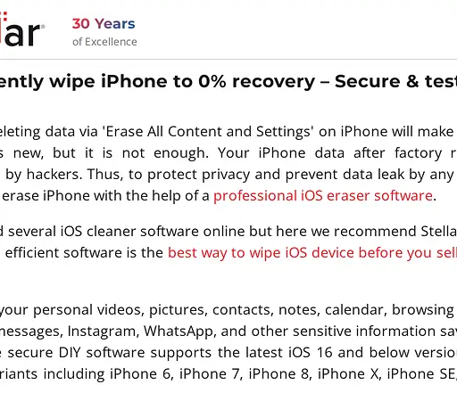

Stellar
“Your iPhone data after factory reset is still recoverable by hackers.”
Screenshot of Stellar website showing the claim: "Your iPhone data after factory reset is still recoverable by..."
Stellar page screenshot
Why this matters
The ciphertext on the NAND is unreadable without the destroyed encryption key. No software tool, no lab, and no hacker can recover plaintext data from a cryptographically erased device because the mathematical key required for decryption no longer exists anywhere.
There is no recovery path after a factory reset on a modern encrypted device. The encryption key has been destroyed. Prevention is the only option: maintain cloud backups (Google account sync, iCloud) and local backups before performing any reset.
SourceAndroid File-Based Encryption documentation; Apple Platform Security Guide: Cryptographic Erase

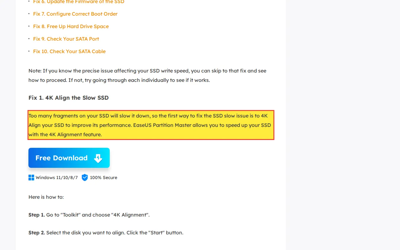

Myth 07
Does File Fragmentation Slow Down SSDs?
Misconception
EaseUS claims: 'Too many fragments on your SSD will slow it down, so the first way to fix the SSD slow issue is to 4K Align your SSD to improve its performance.'
Reality
File fragmentation is a performance concern only for mechanical HDDs, where the read/write head must physically move to non-contiguous sectors. SSDs access any NAND page in the same time regardless of physical location because there is no mechanical seek. 4K alignment is a legitimate SSD optimization (aligning partitions to NAND page boundaries), but it is unrelated to fragmentation.
EaseUS
“Too many fragments on your SSD will slow it down, so the first way to fix the SSD slow issue is to 4K Align your SSD to improve its performance.”
Screenshot of EaseUS website showing the claim: "Too many fragments on your SSD will slow it down, so the fir..."
Why this matters
Customers run defragmentation tools on their SSDs, burning through write endurance cycles for zero performance benefit while shortening the drive's lifespan.
If an SSD is slow, check for TRIM support (fsutil behavior query DisableDeleteNotify), firmware version, and remaining write endurance via SMART attributes. Do not defragment.
SourceNAND flash P/E cycle specifications; SSD garbage collection documentation

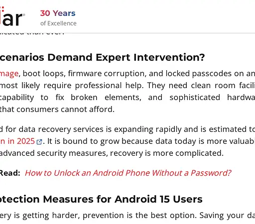

Myth 09
Does Android Phone Recovery Require a Cleanroom?
Misconception
Stellar claims Android phone recovery requires 'clean room facilities.' Android phones are solid-state devices with no exposed platters. Recovery requires board-level microsoldering, not particle filtration.
Reality
Android phones store data on embedded NAND flash (eMMC or UFS) soldered directly to the logic board. There are no platters, no read/write heads, and no air bearings inside an Android phone. A cleanroom or clean bench filters airborne particles to protect exposed hard drive platters during head swaps. Android phones have no components that airborne particles can damage.
Stellar
“They need clean room facilities, micro-soldering capability”
Screenshot of Stellar website showing the claim: "They need clean room facilities, micro-soldering capability..."
Why this matters
Customers believe they need a cleanroom-equipped lab for phone recovery, leading them to pay cleanroom premiums for a procedure that requires a microsoldering workstation and microscope.
Android phone recovery targets the power management IC (PMIC), charging controller, or SoC. A failed PMIC prevents the processor from booting, which prevents the Trusted Execution Environment from releasing decryption keys. Recovery involves component-level diagnosis with a DC power supply and FLIR thermal camera, followed by micro-soldering repair.
SourceeMMC/UFS JEDEC specifications; Android hardware-backed encryption documentation

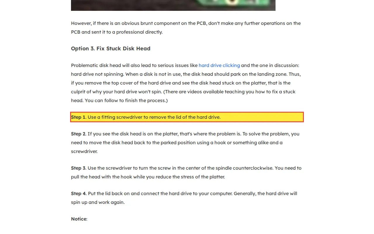

Why this matters
Dragging heads with a 'hook' bends the suspension, cracks the ceramic slider, and embeds debris across the data zone. The platters are scored, the head stack is destroyed, and all data on the drive is permanently unrecoverable. No data recovery lab can undo physical platter scoring.
A drive that will not spin up due to stuck heads requires head replacement inside a 0.02 micron ULPA-filtered clean bench. A trained technician uses calibrated tools to remove the head stack assembly without contacting the platter surface, then installs matched donor heads from a compatible drive of the same model and firmware revision.
SourceHDD manufacturer service documentation; head stack assembly clearance specifications (Seagate, WD, Toshiba)

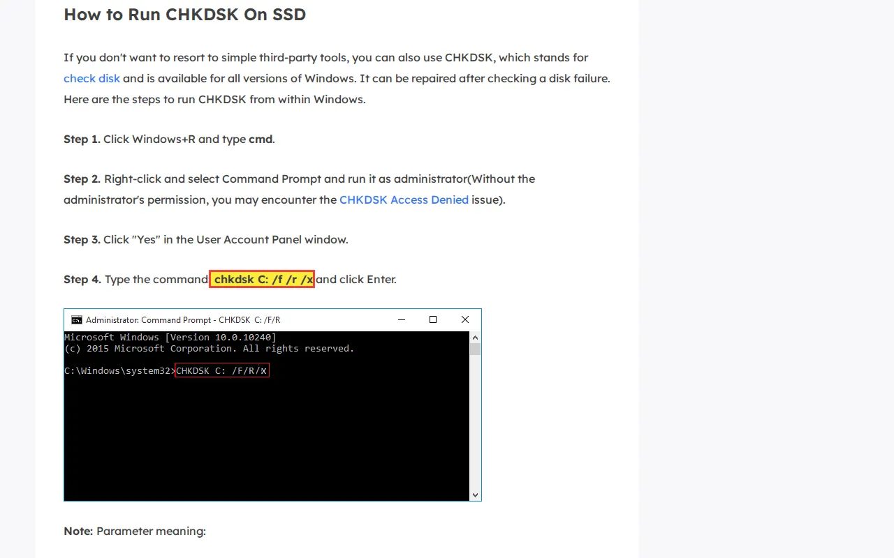

Does CHKDSK Fix a Failing Hard Drive?
Misconception
EaseUS recommends running 'chkdsk c: /f /r /x' on SSDs as a troubleshooting step. SalvageData's 'Fatal Device Hardware Error Solution' guide tells users to run CHKDSK to 'fix bad sectors' on drives with confirmed hardware errors. Both companies present CHKDSK as a repair tool for physically failing media.
Reality
CHKDSK /r forces a full surface scan of every logical block address. On a mechanically failing HDD, this maximizes stress on degraded read/write heads. On the file system level, CHKDSK walks MFT records, cross-references the $Bitmap allocation table, and deletes directory index entries it cannot read.
Documented in the wild (2)
EaseUS
“chkdsk C: /f /r /x”
Screenshot of EaseUS website showing the claim: "chkdsk C: /f /r /x..."
SalvageData
“Run CHKDSK The CHKDSK utility helps you fix file system errors and bad sectors on your hard drive. This built-in Windows tool can help you restore your disk by fixing the bad sectors”
Screenshot of SalvageData website showing the claim: "Run CHKDSK The CHKDSK utility helps you fix file system erro..."
SalvageData page screenshot
Why this matters
Orphaned files get truncated to .chk fragments in FOUND.000. On SSDs, when CHKDSK frees clusters, the OS sends TRIM commands that instruct the controller to erase the underlying NAND pages during garbage collection.
The correct first step for a failing drive is read-only sector-level imaging with PC-3000 Data Extractor or DeepSpar Disk Imager, which captures all readable data without modifying any on-disk metadata.
SourceMicrosoft CHKDSK documentation (learn.microsoft.com); NTFS $MFT structure documentation
CHKDSK on failing drives is one of the most widespread and destructive myths in data recovery. We documented 14 websites publishing this advice. Read the full CHKDSK investigation covering all three destruction mechanisms, with verbatim quotes and screenshot evidence from each source.

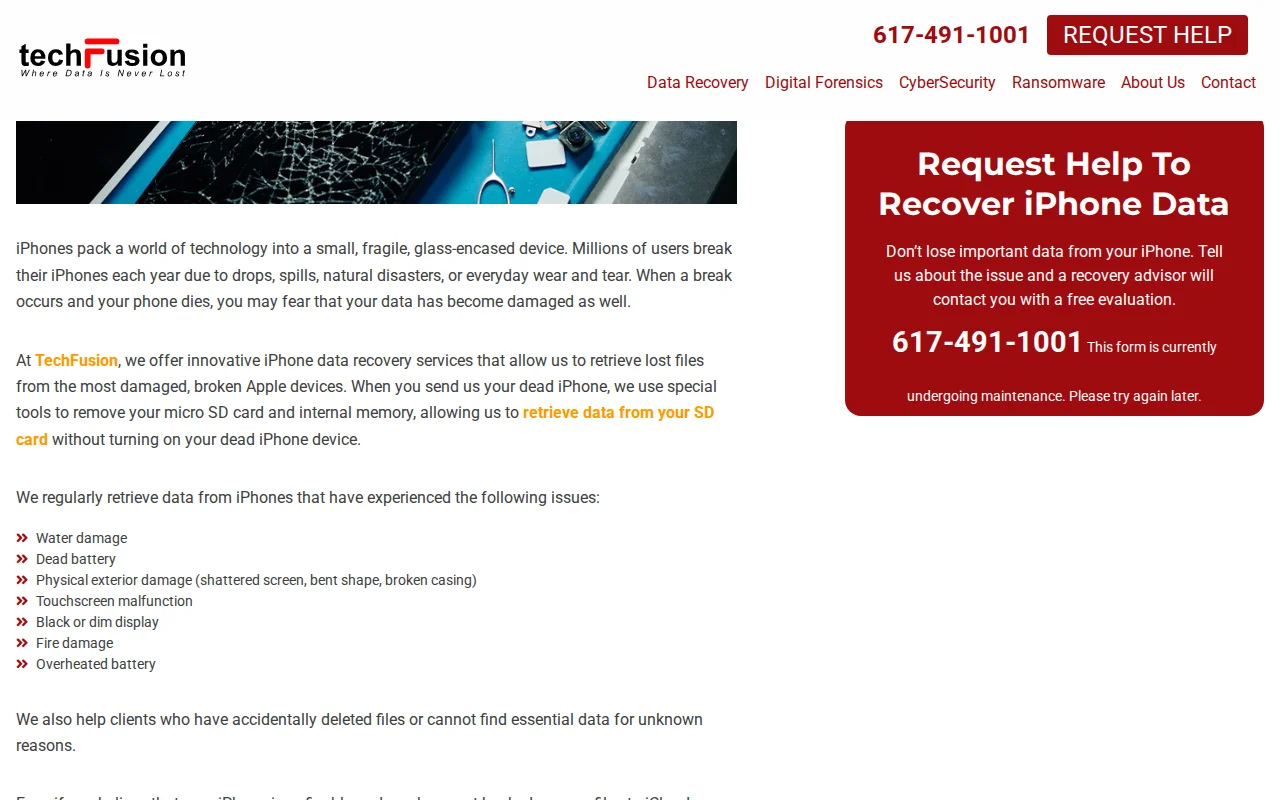

Myth 14
Do iPhones Have Removable SD Cards?
Misconception
TechFusion's iPhone data recovery page claims they can recover data by removing a "micro SD card" from a dead iPhone.
Reality
iPhones have never contained an SD card slot or any removable storage. iPhone storage is NAND flash memory soldered directly to the logic board using ball grid array (BGA) packaging. There is no card to remove.
TechFusion
“When you send us your dead iPhone, we use special tools to remove your micro SD card and internal memory, allowing us to retrieve data from your SD card without turning on your dead iPhone device.”
Screenshot of TechFusion website showing the claim: "When you send us your dead iPhone, we use special tools to r..."
TechFusion page screenshot
Why this matters
Sending your iPhone to a company that claims to 'remove your SD card' means they do not understand the hardware they are working on.
Recovery from a dead iPhone requires board-level micro-soldering: replacing the failed PMIC, Tristar/Hydra USB controller IC, or other components so the SoC boots, authenticates with the Secure Enclave, and releases decryption keys.
SourceApple iPhone technical specifications (apple.com/iphone/specs)

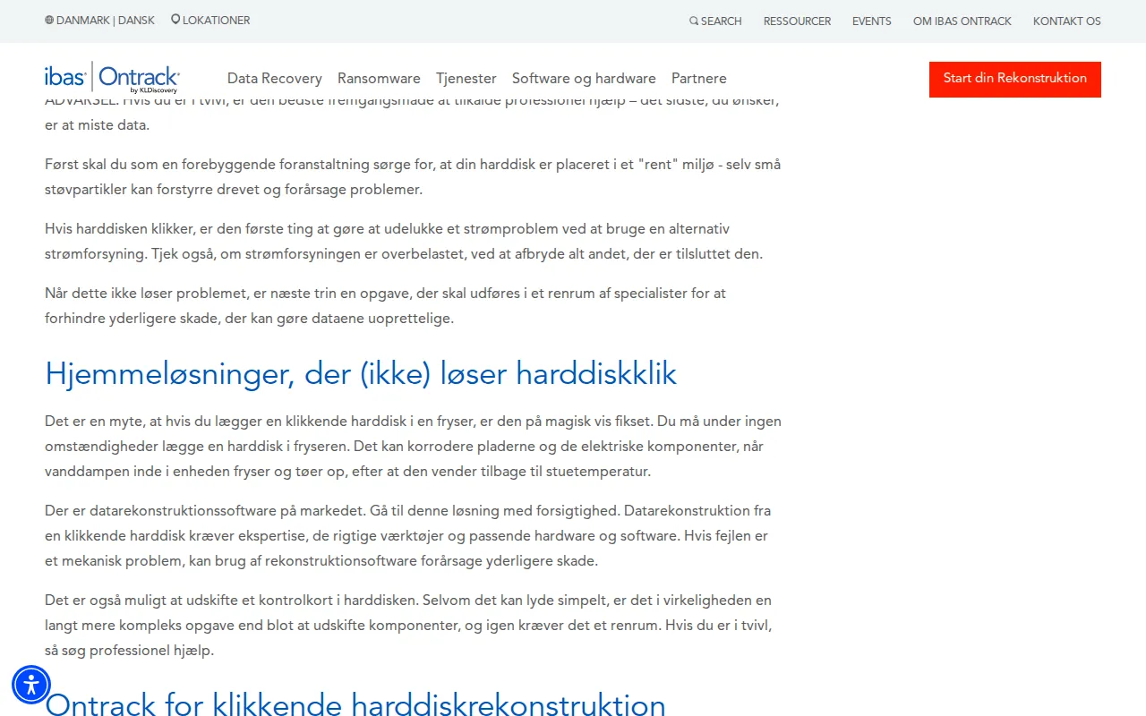

Myth 15
Does a Hard Drive PCB Swap Require a Cleanroom?
Misconception
Ontrack's Danish blog claims that replacing a hard drive control board 'is actually a far more complex task than just replacing components, and again it requires a cleanroom environment.'
Reality
The PCB (printed circuit board) is mounted on the external chassis of the sealed hard drive assembly. Swapping a PCB does not require opening the hermetic seal. The platters are never exposed during a PCB swap.
Ontrack
“Det er også muligt at udskifte et kontrolkort i harddisken. Selvom det kan lyde simpelt, er det i virkeligheden en langt mere kompleks opgave end blot at udskifte komponenter, og igen kræver det et”
Screenshot of Ontrack website showing the claim: "Det er også muligt at udskifte et kontrolkort i harddisken. ..."
Ontrack page screenshot
Why this matters
Customers believe PCB swaps require cleanroom-equipped labs, leading them to pay cleanroom premiums for a procedure that requires a soldering iron and a workbench.
A PCB swap is performed at an open electronics workbench. The only skill required is soldering: the ROM/NVRAM chip must be transferred from the original PCB to the donor PCB so the drive retains its unique calibration data (adaptives). No filtered air environment is needed because the drive enclosure stays sealed.
SourceHDD PCB pinout and ROM transfer documentation; Seagate F3, WD Marvell ROM specifications
Modern drives store unique calibration data (adaptives) on a ROM chip soldered to the PCB. Swapping a bare PCB without transferring the ROM bricks the drive. Read the full PCB swap myth investigation covering Seagate F3 ROM structure, WD Marvell NVRAM transfer, and why eBay PCB sellers omit this critical step.

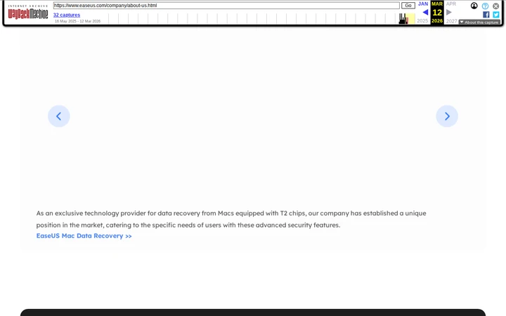

Myth 16
Does EaseUS Have 'Exclusive Technology' for T2 Mac Recovery?
Misconception
EaseUS claims to be 'an exclusive technology provider for data recovery from Macs equipped with T2 chips.' T2 Macs use hardware-bound AES-256 encryption managed by the Secure Enclave Processor. Software cannot bypass this encryption. Recovery requires board-level repair so the original SoC boots and the SEP releases decryption keys.
Reality
The T2 chip contains the Secure Enclave Processor (SEP), which generates and stores the volume encryption key at manufacturing. This key is fused into the silicon and never exposed to any software layer. The encryption is performed inline by the T2's storage controller before data reaches the NAND. No software running on the host CPU has access to the key material.
EaseUS
“As an exclusive technology provider for data recovery from Macs equipped with T2 chips, our company has established a unique position in the market, catering to the specific needs of users with these advance”
Screenshot of EaseUS website showing the claim: "As an exclusive technology provider for data recovery from M..."
Why this matters
Customers purchase EaseUS software expecting it to recover data from a T2 Mac. The software cannot access the encrypted NAND because the T2 chip must be functioning for decryption. The customer wastes money and delays seeking the correct solution: board-level repair.
T2 Mac recovery requires repairing the logic board so the original T2 chip boots. Common failure points include the PMIC, USB-C retimer, and power rail capacitors. Component-level fault isolation uses a DC power supply, FLIR thermal camera, and Hakko FM-2032 microsoldering station.
SourceApple Platform Security Guide: T2 hardware architecture; Secure Enclave key derivation

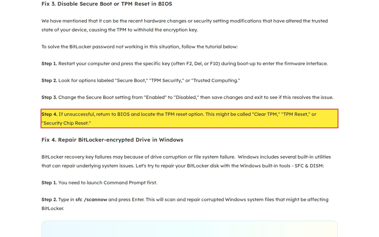

Myth 17
Should You Clear the TPM When BitLocker Recovery Key Fails?
Misconception
EaseUS instructs users to enter BIOS and 'locate the TPM reset option. This might be called Clear TPM, TPM Reset, or Security Chip Reset' when the BitLocker recovery key is not working.
Reality
The TPM stores the Volume Master Key (VMK) used to decrypt the BitLocker Full Volume Encryption Key (FVEK). Clearing the TPM destroys the VMK. Without the VMK, the only fallback is the 48-digit recovery key. If the recovery key is already not working (which is the article's premise), clearing the TPM eliminates the last remaining decryption path.
EaseUS
“If unsuccessful, return to BIOS and locate the TPM reset option. This might be called "Clear TPM," "TPM Reset," or "Security Chip Reset."”
Screenshot of EaseUS website showing the claim: "If unsuccessful, return to BIOS and locate the TPM reset opt..."
Why this matters
The AES-256 encrypted volume becomes permanently sealed. There is no mathematical method to recover the data once both the TPM-stored VMK and the recovery key are gone.
When a BitLocker recovery key fails, the correct steps are: check for the key in the user's Microsoft account (account.microsoft.com/devices/recoverykey), check Active Directory or Azure AD if the device was domain-joined, check for a printed or saved copy. If the TPM still holds the key, do not clear it. Contact a recovery specialist before taking any destructive action.
SourceMicrosoft BitLocker documentation (learn.microsoft.com); TPM 2.0 specification (trustedcomputinggroup.org)

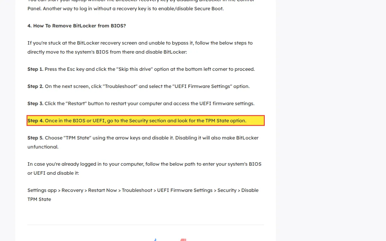

Myth 18
Does Disabling the TPM Disable BitLocker?
Misconception
EaseUS instructs users to 'Choose TPM State using the arrow keys and disable it. Disabling it will also make BitLocker unfunctional.'
Reality
Disabling the TPM does not grant access to the data. It prevents the TPM from releasing the VMK at boot, which triggers the BitLocker recovery screen. If the user does not have their 48-digit recovery key, they are now locked out.
EaseUS
“Choose "TPM State" using the arrow keys and disable it. Disabling it will also make BitLocker unfunctional.”
Screenshot of EaseUS website showing the claim: "Choose "TPM State" using the arrow keys and disable it. Disa..."
Why this matters
BitLocker demands the recovery key at every boot. If the user does not have the recovery key (common for users who enabled BitLocker via Windows defaults without saving the key), they are permanently locked out of their data.
Do not disable the TPM unless you have confirmed you possess the BitLocker recovery key. If the TPM is functioning and BitLocker is unlocking normally, the TPM is doing its job. Disabling it creates a problem where none existed.
SourceMicrosoft TPM documentation; BitLocker recovery key requirements

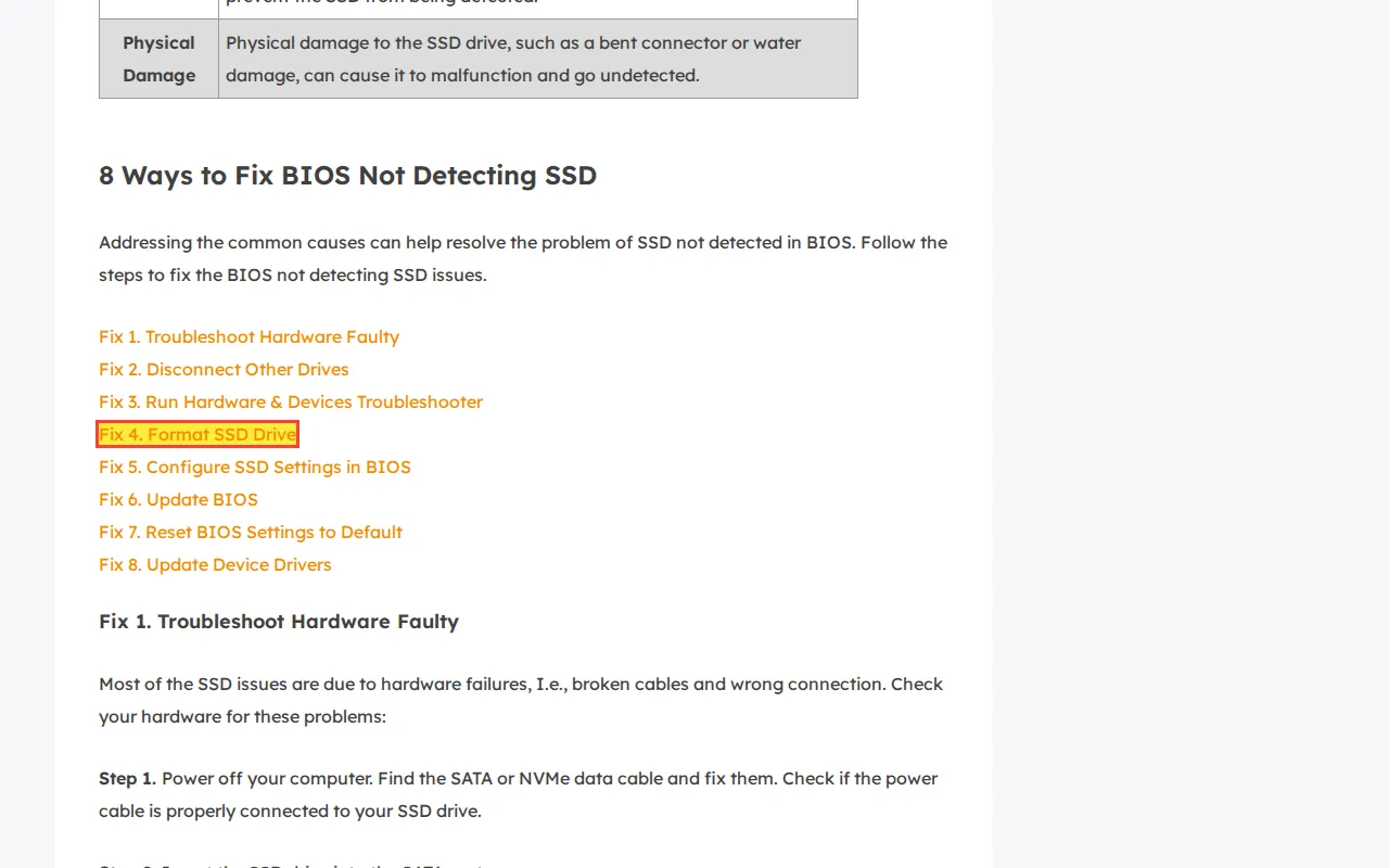

Myth 20
Should You Format a Drive with Fatal Hardware Errors?
Misconception
SalvageData's 'Fatal Device Hardware Error Solution' guide advises: 'Format the drive. That's because formatting the disk can delete logical errors.' The article explicitly acknowledges the error is a 'Fatal Device Hardware Error,' then recommends formatting. EaseUS advises formatting an SSD that is 'not detected in BIOS.'
Reality
A full format writes zeroes to every sector on the drive, forcing a complete surface scan on a drive with known hardware failure. On an SSD, formatting sends TRIM commands that unmap the freed blocks and queue them for erase; unlike an HDD format where data might persist in unallocated sectors, a TRIMmed SSD returns zeros for those addresses immediately and erases the cells during garbage collection. EaseUS's advice to format a drive 'not detected in BIOS' is logically impossible; if the BIOS cannot see the drive, Windows Disk Management cannot format it.
SalvageData
“Format the drive If the Request Failed Due to a Fatal Device Hardware Error still appears, then you might have to format your drive. That's because formatting the disk can delete logical errors.”
Screenshot of SalvageData website showing the claim: "Format the drive If the Request Failed Due to a Fatal Device..."
EaseUS
“Fix 4. Format SSD Drive An SSD drive containing malware or viruses may not work well on your computer. The only solution to clean your drive is to format it.”
Screenshot of EaseUS website showing the claim: "Fix 4. Format SSD Drive An SSD drive containing malware or v..."
Why this matters
A full format overwrites every sector, destroying all data. On a drive with hardware failure, the forced write operations cause additional head crashes and platter scoring, making even partial recovery impossible.
Power off the drive. Image it with a hardware write-blocker (PC-3000, DeepSpar) to capture all readable data before any write operation. Diagnose the hardware error after the data has been safely imaged.
SourceSATA specification: TRIM command behavior; Microsoft Disk Management documentation

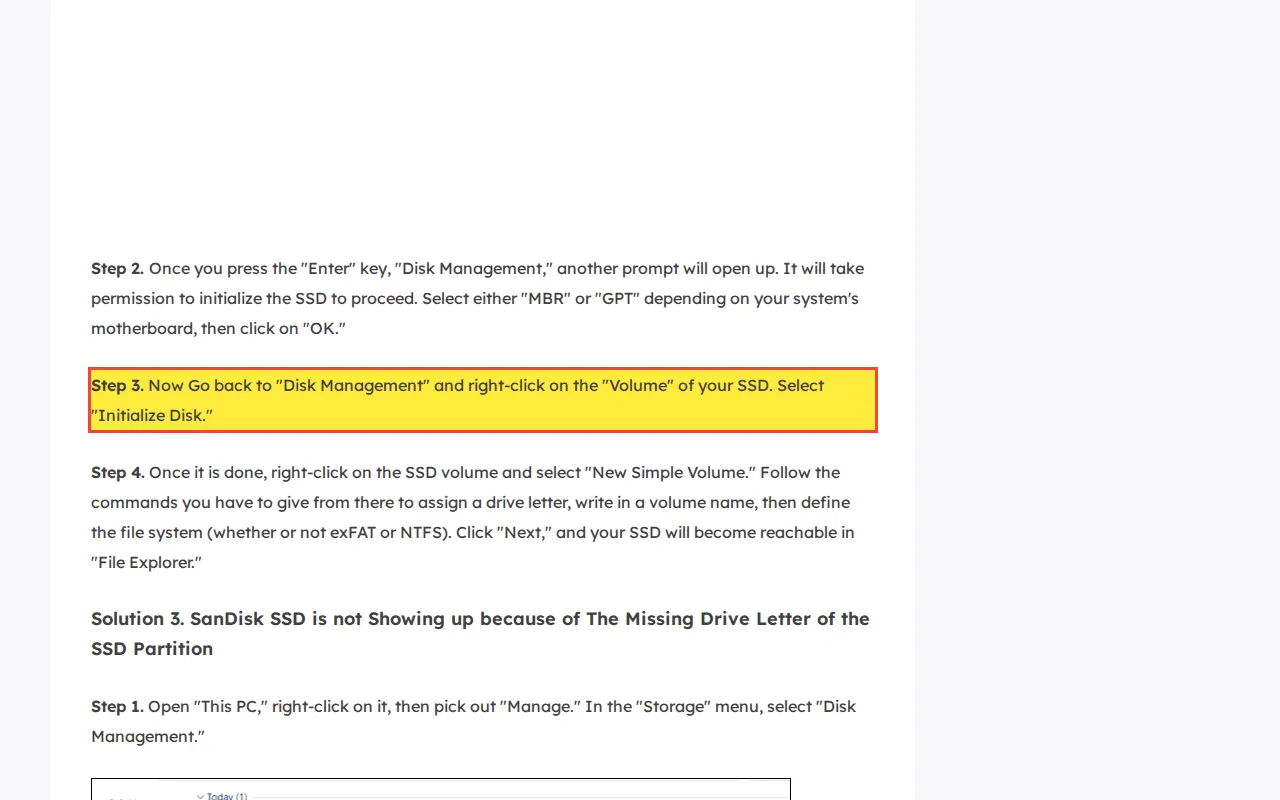

Myth 21
Should You Initialize a Disk That Is Not Showing Up?
Misconception
EaseUS instructs users to go to Disk Management, right-click the SSD volume, select 'Initialize Disk,' then create a 'New Simple Volume' when their SSD is not showing up.
Reality
Initializing a disk writes a new partition table (MBR or GPT), overwriting the existing partition map that defines where the user's data volumes begin and end. Creating a 'New Simple Volume' then formats the partition, triggering TRIM on SSDs, which unmaps every page in the volume and queues it for erase. On HDDs, this overwrites the boot sector and root directory entries.
EaseUS
“Now Go back to "Disk Management" and right-click on the "Volume" of your SSD. Select "Initialize Disk." Step 4. Once it is done, right-click on the SSD volume and select "New Simple Volume.”
Screenshot of EaseUS website showing the claim: "Now Go back to "Disk Management" and right-click on the "Vol..."
Why this matters
The existing partition table is overwritten and the drive is formatted. On an SSD, the controller stops serving those pages and garbage collection erases them. On an HDD, the file system metadata is destroyed. Both result in permanent data loss.
When a drive shows as 'not initialized' in Disk Management, the correct response is to image it with a hardware write-blocker, then reconstruct the partition table from the backup GPT header or by scanning for volume signatures using PC-3000 or R-Studio.
SourceGPT partition table specification (UEFI Forum); TRIM command specification (T13)

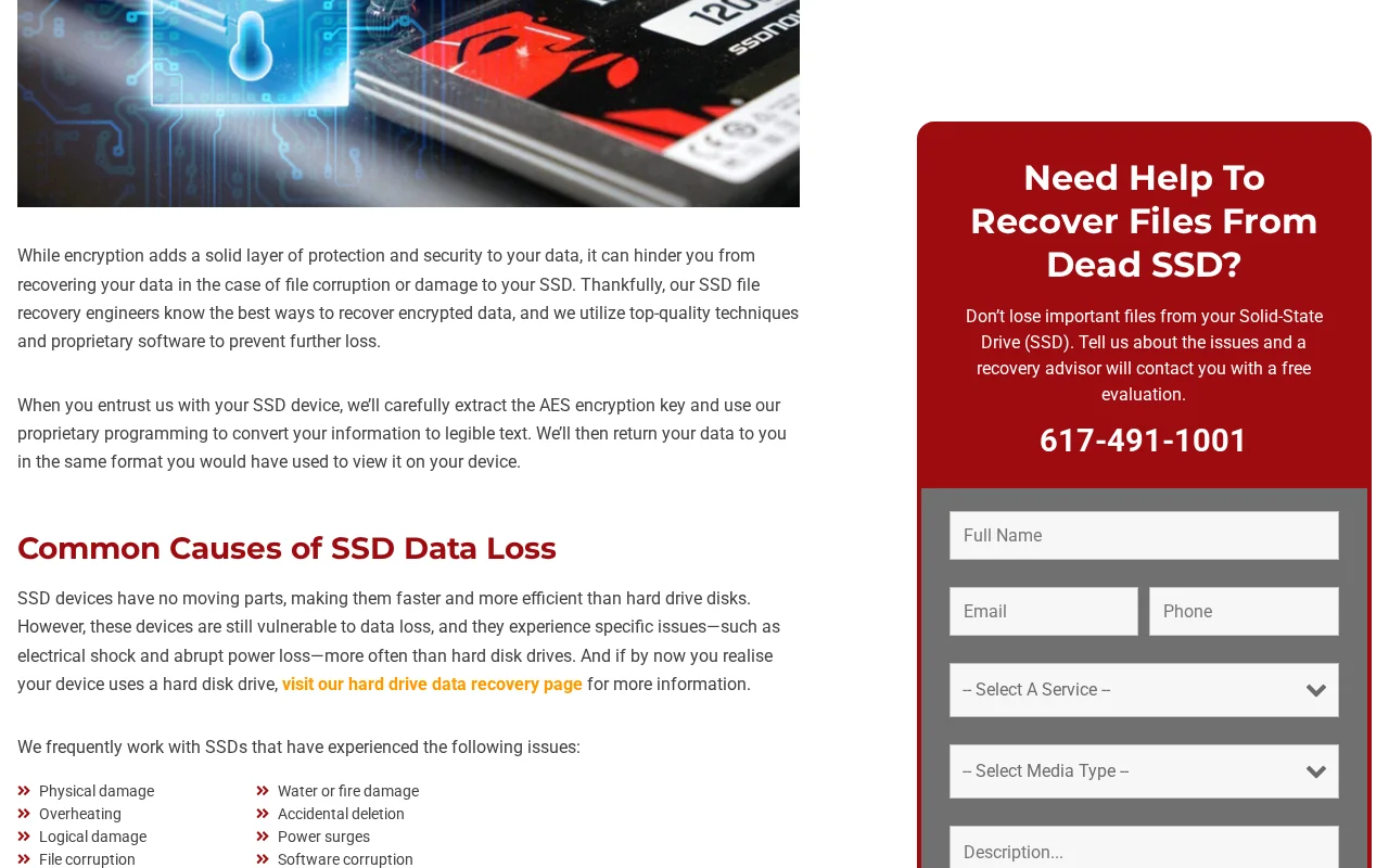

Myth 22
Can a Data Recovery Company 'Extract' AES Encryption Keys?
Misconception
TechFusion claims they will 'carefully extract the AES encryption key' from SSDs using 'proprietary programming.' AES-256 keys on hardware-encrypted SSDs are stored in tamper-resistant secure elements. The key space is 2^256. No 'proprietary programming' bypasses the mathematical foundation of AES.
Reality
AES-128 and AES-256 encryption keys on hardware-encrypted SSDs (including all Apple T2/M-series drives, Samsung SEDs, and any drive with TCG Opal compliance) live inside a tamper-resistant secure element on the SSD controller or the host SoC. The media key is generated on the controller and wrapped by a key tied to that controller's hardware-unique root, so it never leaves the original silicon. These keys cannot be 'extracted' because that binding does not transfer off the chip, which is designed to lock if physical extraction is attempted.
TechFusion
“When you entrust us with your SSD device, we'll carefully extract the AES encryption key and use our proprietary programming to convert your information to legible text”
Screenshot of TechFusion website showing the claim: "When you entrust us with your SSD device, we'll carefully ex..."
Why this matters
The customer pays for a service that cannot deliver what is described. Their hardware-encrypted SSD data remains inaccessible because the described procedure is physically impossible.
Recovery from a hardware-encrypted SSD requires repairing the original controller or host SoC so it boots and decrypts the NAND in place. If the controller is dead, PC-3000 SSD can inject firmware into the controller's RAM to access data through the original decoding pipeline. If the SoC (T2, M-series) is dead, board-level repair is the only path.
SourceAES specification (NIST FIPS 197); TCG Opal SED specification

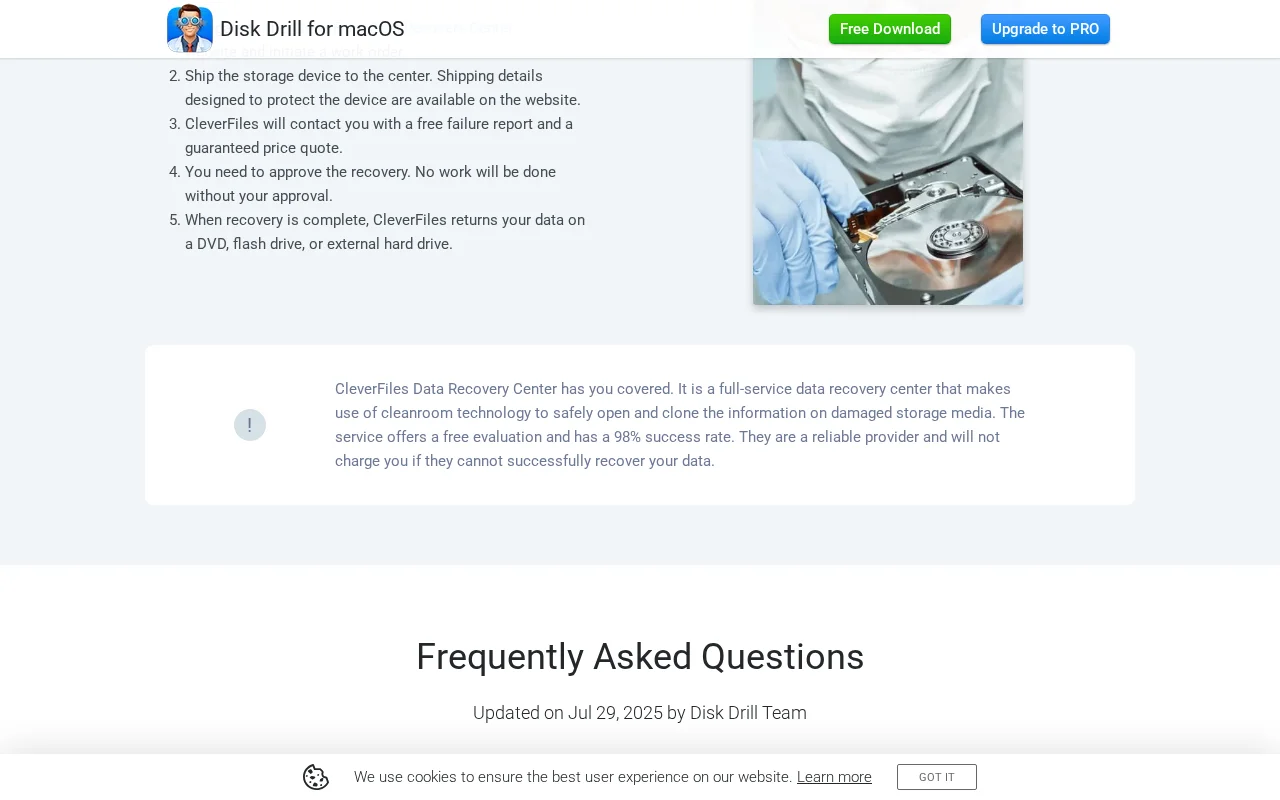

Misconception
Disk Drill's data recovery center page claims to use 'cleanroom technology to safely open and clone the information on damaged storage' for iPhone recovery. iPhones are solid-state devices. There is nothing inside an iPhone that airborne particles can damage. iPhone recovery requires microsoldering, not cleanroom filtration.
Reality
iPhones store data on BGA-soldered NAND flash encrypted by the Secure Enclave Processor. There are no platters, no read/write heads, and no air bearings inside an iPhone. A cleanroom or clean bench filters airborne particles to protect exposed hard drive platters. iPhones have no components that require particle filtration during recovery.
Disk Drill
“CleverFiles Data Recovery Center has you covered. It is a full-service data recovery center that makes use of cleanroom technology to safely open and clone the information on damaged storage”
Screenshot of Disk Drill website showing the claim: "CleverFiles Data Recovery Center has you covered. It is a fu..."
Disk Drill page screenshot
Captured 2026-03-22
Why this matters
Customers believe cleanroom certification matters for iPhone recovery, leading them to choose a lab based on irrelevant infrastructure instead of board-level microsoldering capability.
iPhone recovery involves repairing the logic board with a microsoldering station: replacing the failed PMIC, Tristar/Hydra IC, or other power delivery components so the SoC boots, authenticates with the Secure Enclave, and releases decryption keys. No filtered air environment is needed.
SourceApple iPhone hardware architecture; iFixit teardown documentation

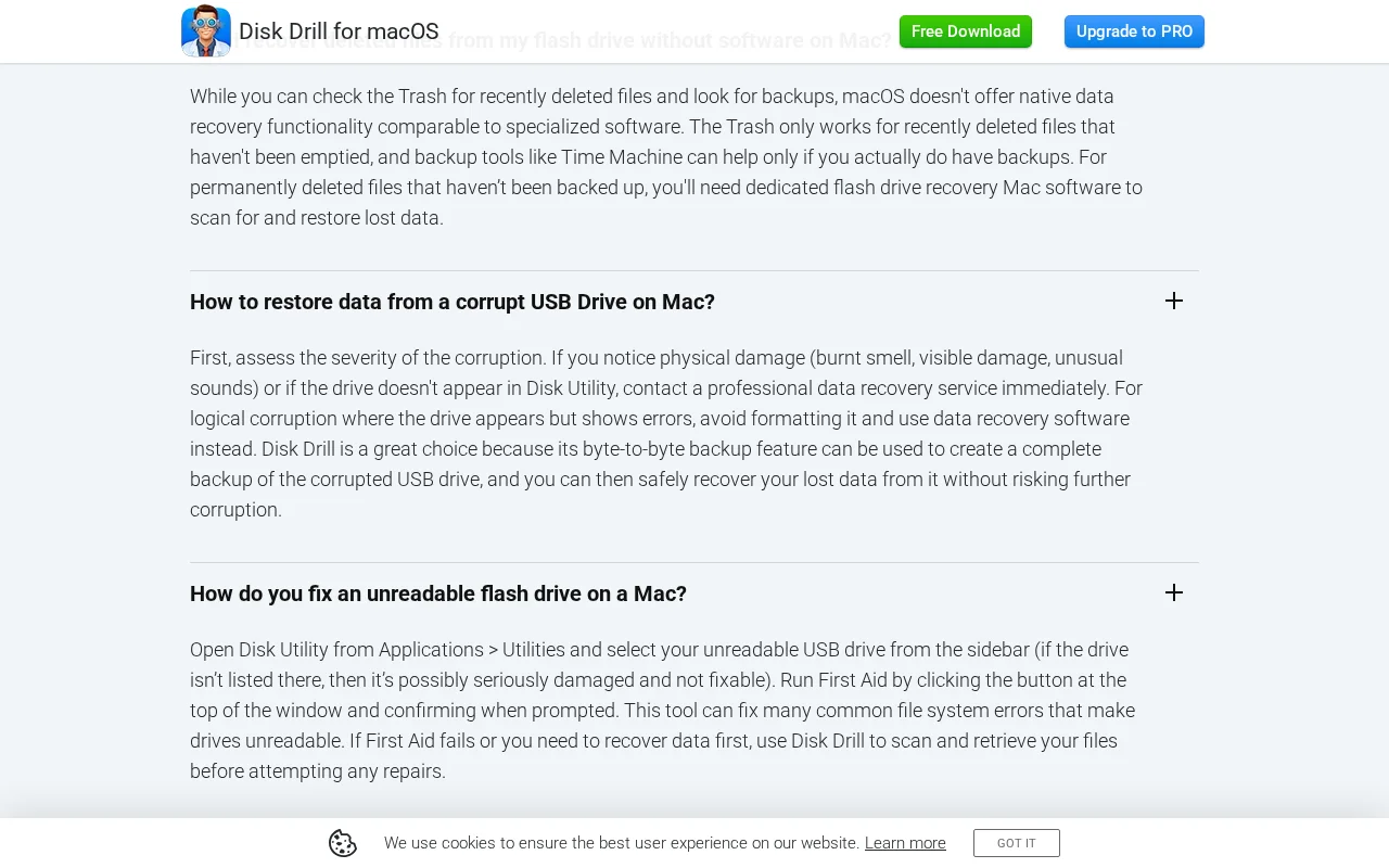

Myth 24
Can USB Flash Drives Make 'Unusual Sounds'?
Misconception
Disk Drill's USB flash drive recovery page copies HDD diagnostic advice onto a solid-state device page, advising users to listen for 'unusual sounds' from a device with no moving parts.
Reality
USB flash drives are solid-state devices with no moving parts. There is no motor, no actuator, no spinning platter. A USB flash drive is a PCB with a controller IC and NAND flash chips inside a plastic shell. It cannot produce sounds.
Disk Drill
“If you notice physical damage (burnt smell, visible damage, unusual sounds) or if the drive doesn't appear in Disk Utility, contact a professional data recovery service immediately.”
Screenshot of Disk Drill website showing the claim: "If you notice physical damage (burnt smell, visible damage, ..."
Why this matters
Customers waste time listening for sounds from a silent device, or falsely conclude their flash drive is fine because it is not making noise, when the actual failure indicators (not appearing in Disk Utility, no LED activity) go unaddressed.
USB flash drive failure diagnosis starts with checking whether the drive enumerates on the USB bus. If the controller responds but data is inaccessible, PC-3000 Flash can read the NAND directly. If the controller is dead, the NAND chips can be desoldered and read in a programmer.
SourceUSB mass storage class specification; NAND flash architecture

Myth 28
Does the Head Arm Make a Hard Drive Spin?
Misconception
Ontrack's Danish blog on clicking hard drives claims the clicking noise 'usually comes from the read head arm, a physical part of the device that allows the hard drive to spin.'
Reality
The read head arm (actuator) positions the heads over the correct track. The platters are spun by a separate spindle motor using fluid dynamic bearings. The actuator uses a voice coil motor to pivot; the spindle motor uses electromagnetic coils to rotate the platters.
Ontrack
“Selvom der er flere grunde til, at harddisken klikker, stammer selve støjen normalt fra armen på læsehovedet – en fysisk del af enheden, der lader harddisken snurre”
Screenshot of Ontrack website showing the claim: "Selvom der er flere grunde til, at harddisken klikker, stamm..."
Why this matters
A customer may incorrectly conclude that clicking means the spindle motor is failing, when the sound is the actuator resetting after it fails to acquire a servo track. That misdirects the diagnosis toward the motor and away from what the bench actually has to check.
The click is the actuator resetting after a failed servo acquisition, and damaged heads, Service Area firmware faults, and preamp failures all produce it. The correct response is to power off the drive immediately and send it to a professional lab, where PC-3000 separates a firmware fault from head damage before anything is opened on a 0.02 micron ULPA-filtered clean bench.
SourceHDD manufacturer service documentation; spindle motor and VCM specifications (Seagate, WD, Toshiba)
Clicking has at least six distinct causes: head preamp failure, seized bearings, firmware corruption, weak heads from manufacturing defects, service area read failures, and actuator arm damage. Read the full clicking drive investigation covering each cause, its diagnostic signature in PC-3000, and why assuming "clicking = dead heads" leads to misdiagnosis.

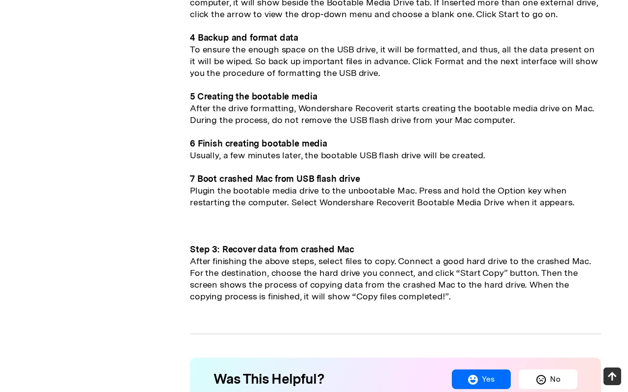

Myth 31
Can a Bootable USB Recover Data from a Dead Mac?
Misconception
Wondershare's Recoverit support page provides step-by-step instructions for creating a bootable USB to recover data from a "crashed Mac," with zero mention of T2 or Apple Silicon encryption.
Reality
If a T2 or Apple Silicon Mac is unbootable due to a hardware failure (dead PMIC, shorted power rail, failed SoC), it cannot boot from any USB drive because the logic board is not powering on. The Secure Enclave must initialize and authenticate before releasing volume encryption keys.
Wondershare
“Plugin the bootable media drive to the unbootable Mac. Press and hold the Option key when restarting the computer. Select Wondershare Recoverit Bootable Media Drive when it appears.”
Screenshot of Wondershare website showing the claim: "Plugin the bootable media drive to the unbootable Mac. Press..."
Wondershare page screenshot
Why this matters
Users who pay for and create bootable recovery media find it does nothing when the underlying issue is a hardware failure rather than a software crash.
For a dead Mac, recovery requires board-level diagnosis with a DC power supply (checking 5V vs 20V USB-C PD negotiation), FLIR thermal imaging to identify shorted components, and micro-soldering repair of the failed component so the original board boots with its Secure Enclave intact.
SourceApple Configurator 2 DFU mode documentation (support.apple.com)

How CHKDSK Destroys Data on Failing Drives
CHKDSK /r performs three destructive operations on a physically failing drive. First, it forces a sequential read of every LBA on the disk, maximizing head travel across degraded platters. Non-TLER drives (consumer models from Seagate, WD, Toshiba) retry each failing sector 10-20 times before reporting a read error, which means the degraded heads repeatedly stress the same damaged areas.
Second, CHKDSK walks the NTFS Master File Table ($MFT), cross-references it against the $Bitmap cluster allocation table, and restructures directory indexes ($INDEX_ROOT and $INDEX_ALLOCATION attributes). When it encounters unreadable MFT records, it orphans the file entries and truncates them into numbered .chk fragments in the FOUND.000 directory. The original file name, path, and metadata are destroyed.
Third, on SSDs, when CHKDSK marks clusters as free in $Bitmap, Windows sends TRIM commands for those LBAs. The SSD controller queues these blocks for garbage collection, which physically erases the NAND pages. Once erased, the data is permanently gone.
Professional recovery bypasses this entirely. PC-3000 Data Extractor and DeepSpar Disk Imager perform sector-level imaging with configurable per-sector timeouts, starting short and tightening further for severely degraded zones. The imaging process reads data in a non-linear pattern, prioritizing healthy zones first and returning to degraded zones with progressively aggressive parameters. No file system metadata is modified during imaging.

BitLocker and TPM Encryption Architecture
BitLocker Full Volume Encryption uses a layered key hierarchy. At the bottom layer, data is encrypted with the Full Volume Encryption Key (FVEK), which uses AES-128 or AES-256 in XTS mode. The FVEK is stored on disk, encrypted by the Volume Master Key (VMK). The VMK is sealed to the TPM using Platform Configuration Registers (PCRs) that reflect the boot chain state.
When the system boots normally, the TPM releases the VMK only if the PCR measurements match the expected values (meaning the boot firmware, bootloader, and OS kernel have not been tampered with). The VMK decrypts the FVEK, and the FVEK decrypts the volume transparently during read/write operations.
Clearing the TPM erases all sealed keys, including the VMK. The 48-digit recovery key is an independent backup of the VMK. If both the TPM and the recovery key are unavailable, the FVEK cannot be decrypted, and the volume data is permanently sealed behind AES encryption. No lab, no government agency, and no supercomputer cluster can brute-force AES-256 in any practical timeframe.
Disabling the TPM (as EaseUS advises) does not remove encryption; it prevents the TPM from releasing the VMK at boot. The system then demands the recovery key. If the user does not have the recovery key (common on consumer machines where Windows enabled BitLocker by default during OOBE), the data is locked permanently.

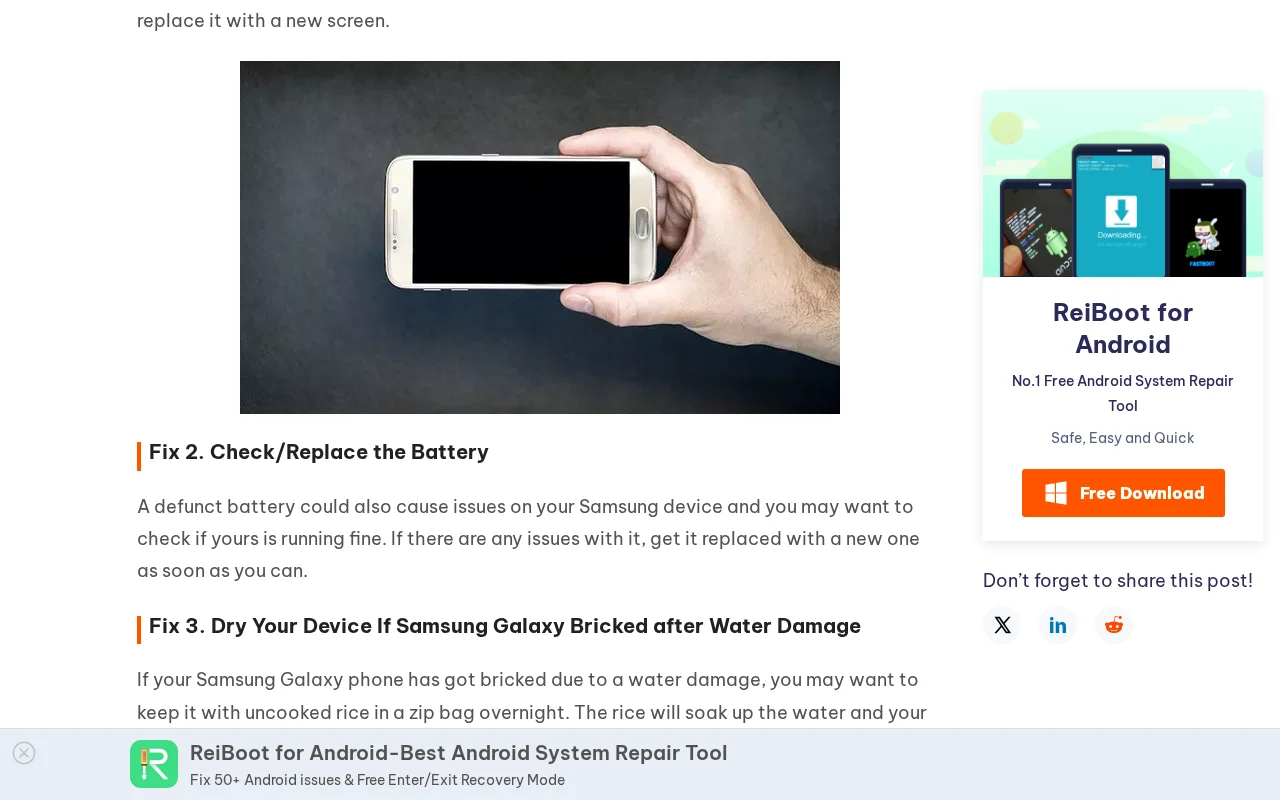

Can rice fix a water-damaged phone?
No. Rice absorbs ambient moisture from the air but cannot extract liquid trapped under BGA packages, EMI shields, or between PCB layers. While the phone sits in rice, electrolytic corrosion actively dissolves copper traces and tin solder joints. The correct response is immediate disassembly and ultrasonic cleaning in 99% isopropyl alcohol.

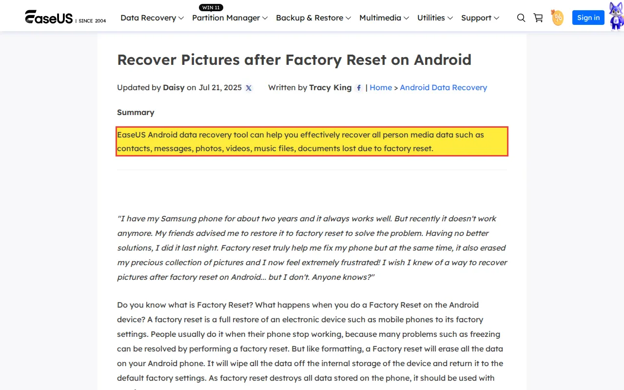

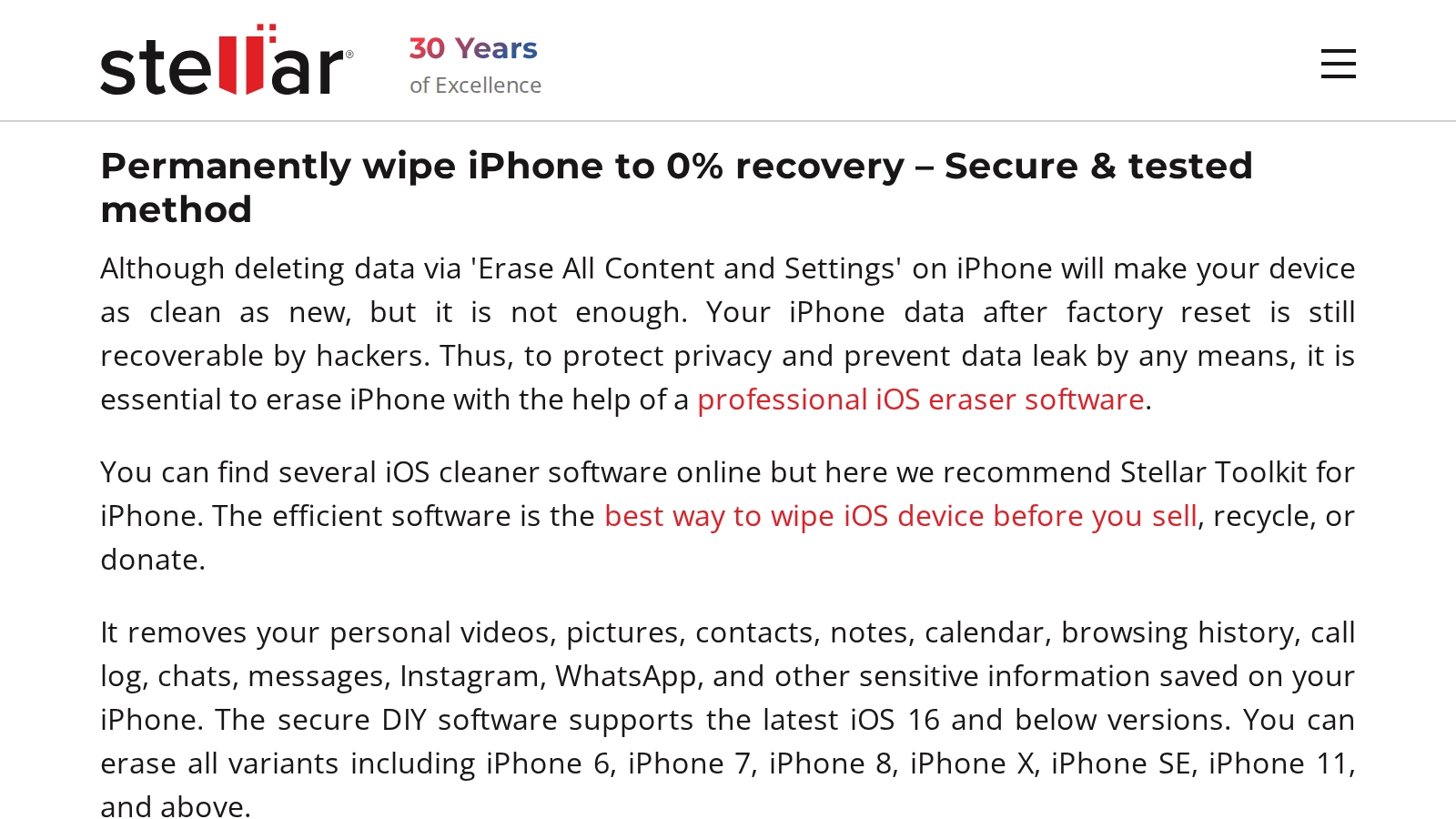

Can software recover data after a phone factory reset?
No. Modern Android (6.0+) and iOS (8+) devices use hardware-backed encryption. A factory reset performs a Cryptographic Erase that destroys the encryption keys stored in the secure element. The ciphertext remains on the NAND but is mathematically unrecoverable without the destroyed keys.

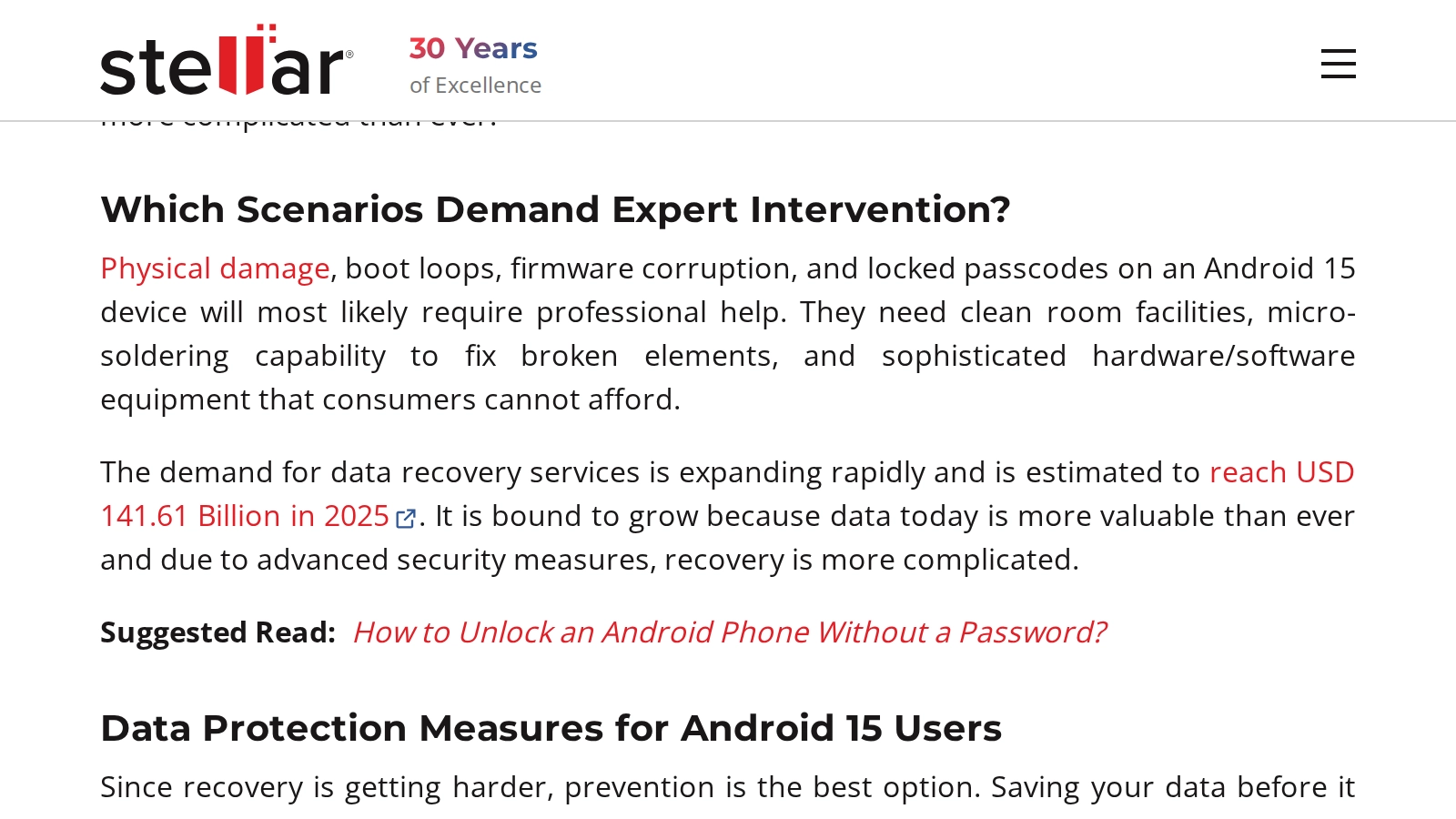

Does Android phone recovery require a cleanroom?
No. Android phones are solid-state devices with no exposed platters. There is nothing inside an Android phone that airborne particles can damage. Recovery requires board-level microsoldering to repair power delivery circuits so the SoC boots and the TEE releases decryption keys.
Should you open a hard drive and move the heads yourself?
No. Read/write heads keep a baseline aerodynamic clearance of a few nanometers and use thermal fly-height control to protrude the transducer to an active magnetic spacing of about 1 to 2 nanometers above the platters. Touching them with any tool scores the magnetic coating off the platter surface, permanently destroying data. Head replacement requires a ULPA-filtered clean bench, matched donor heads from a compatible drive, and calibrated tools designed to remove the head stack assembly without contacting the platter.

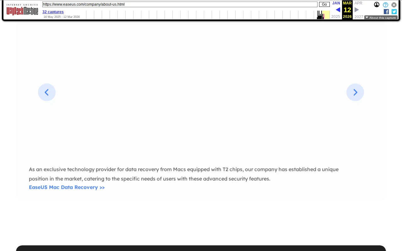

Does EaseUS have exclusive T2 Mac recovery technology?
No. T2 Macs use hardware-bound AES-256 encryption managed by the Secure Enclave Processor. Software cannot bypass this encryption. Recovery requires board-level repair so the original SoC boots and the SEP releases decryption keys. No software vendor has 'exclusive technology' to bypass hardware encryption.
Should you clear the TPM when BitLocker recovery key fails?
No. Clearing the TPM destroys the Volume Master Key (VMK) used to decrypt the BitLocker Full Volume Encryption Key (FVEK). If the recovery key is already not working, clearing the TPM eliminates the last remaining decryption path. The AES-256 encrypted volume becomes permanently sealed with no mathematical method to recover the data.
Does disabling the TPM disable BitLocker?
No. Disabling the TPM prevents it from releasing the Volume Master Key at boot, which triggers the BitLocker recovery screen. If the user does not have the 48-digit recovery key, they are permanently locked out of their data. Disabling the TPM creates a problem; it does not solve one.

Should you format a drive that shows hardware errors?
No. Formatting a drive with a fatal hardware error overwrites all user data, stresses failing heads across every track, and on SSDs sends TRIM commands that unmap NAND pages and queue them for erase. The correct response is to power off the drive and image it with a hardware write-blocker before any write operation.
Should you initialize a disk that is not showing up?
No. Initializing a disk writes a new partition table, overwriting the existing partition map. Creating a new volume then formats the partition, triggering TRIM on SSDs. The correct response is to image the drive with a hardware write-blocker, then reconstruct the partition table from backup headers.
