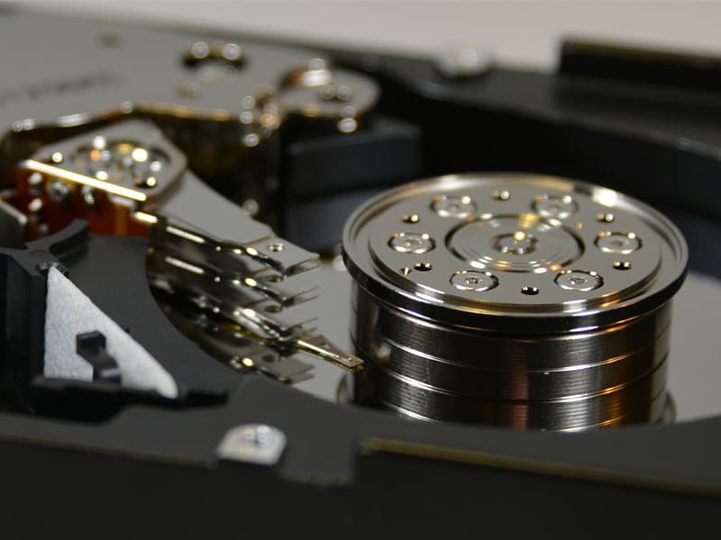

Open hard drive with its platter stack and head stack exposed
