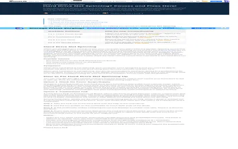

Can you open a hard drive and move the heads with a hook?
1The Claim
“Use a fitting screwdriver to remove the lid of the hard drive... You can use a hook to carefully drag the heads back.”
Screenshot of EaseUS page
2The Reality
Modern read/write heads fly 2-3 nanometers above the platter surface. A single particle of smoke is far larger than that gap. Opening a drive outside of a filtered environment introduces particulate contamination that causes head crashes when the drive is powered on. Dragging heads across platters with a hook scores the magnetic substrate, physically destroying the data tracks. Professional hard drive data recovery labs use precision head-comb tools that lift heads vertically off the platters without any lateral contact, inside a 0.02µm ULPA-filtered clean bench.
Consequence: Following this advice will permanently destroy the platter surface and render the drive unrecoverable by any lab.

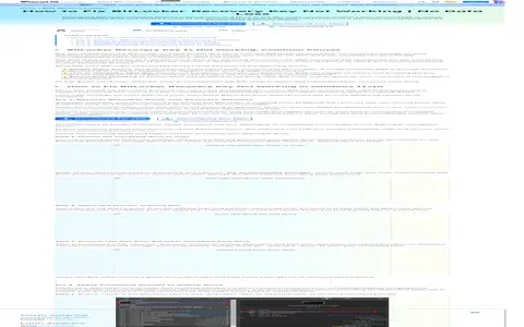

Can software unlock a BitLocker drive without a recovery key?
1The Claim
“Install EaseUS Data Recovery Wizard to unlock a BitLocker drive without a recovery key”
2The Reality
BitLocker uses AES-128 or AES-256 encryption. The Full Volume Encryption Key (FVEK) is wrapped by a Volume Master Key (VMK), which is sealed by the user's password or 48-digit recovery key. Without that key, the data is mathematically inaccessible. EaseUS's actual methodology instructs users to format the encrypted partition, which destroys the BitLocker volume header containing the encrypted VMK. This does not decrypt anything. It permanently destroys the only path to decryption. See our encrypted data recovery page for what is and is not possible with encrypted volumes.
Consequence: Following this advice formats the encrypted volume, destroying the volume header and making the data permanently inaccessible.

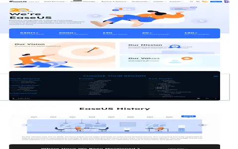

Does EaseUS have "exclusive technology" for T2 Mac recovery?
1The Claim
“As an exclusive technology provider for data recovery from Macs equipped with T2 chips...”
2The Reality
Apple T2 and M-series processors perform line-rate AES-256 encryption between the CPU and the NAND storage. The encryption key is bound to the Secure Enclave on the specific chip that wrote the data. No third-party software can access T2/M-series NAND independently of the original processor. Recovery requires repairing the logic board so the original CPU can decrypt the storage, or reviving the firmware via Apple DFU mode. Claiming "exclusive technology" to bypass hardware-bound encryption is a misrepresentation of what is physically possible.
Consequence: Users who purchase EaseUS expecting T2 Mac data recovery will receive no usable data. The encryption is hardware-bound and cannot be bypassed by any software.

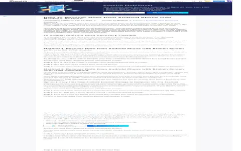

Can you recover data from a water-damaged phone via USB?
1The Claim
“Physical damage like cracked and broken screens, water damaged phones...”
2The Reality
Connecting a water-damaged phone via USB supplies 5V power to a board with active electrolytic corrosion. Water wicks underneath BGA packages and RF shields. Applying voltage accelerates the corrosion, causing shorts across power rails that can destroy the NAND storage, CPU, or power management IC within minutes. The correct response is immediate disassembly and ultrasonic cleaning in 99% isopropyl alcohol before applying any power. For devices that cannot boot, iPhone data recovery requires board-level microsoldering to repair the power path before data can be accessed.
Consequence: Plugging a water-damaged phone into USB accelerates corrosion and can destroy the storage chip, making data permanently unrecoverable.

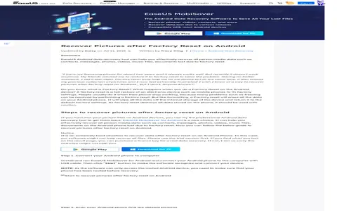

Can software recover data after a factory reset?
1The Claim
“EaseUS Android data recovery tool can help you effectively recover all personal media data... lost due to factory reset”
2The Reality
Modern Android and iOS devices encrypt storage by default with hardware-backed keys. Android has required device encryption since 6.0, moving to File-Based Encryption (FBE) from Android 7.0 and mandating it in Android 10. Each file or volume key is wrapped by a master key held in a hardware-backed key store: Apple's Secure Enclave, or a Trusted Execution Environment (or a dedicated security chip such as Titan M on Pixel) on Android. A factory reset performs a Cryptographic Erase: the device destroys the master encryption keys. The data remaining on the NAND is AES-256 ciphertext without a decryption key. No software can reconstruct the destroyed keys. This claim applied to legacy Android 4.x devices with unencrypted eMMC storage, which have been obsolete for over a decade.
Consequence: Users pay for software that returns only random ciphertext. The encryption keys were destroyed during the factory reset and cannot be reconstructed.

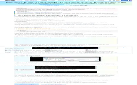

Should you run CHKDSK on a failing drive?
1The Claim
“chkdsk C: /f /r /x”
2The Reality
CHKDSK is a file system consistency tool, not a data recovery tool. It prioritizes making the volume mountable by Windows over preserving your files. On a failing drive, CHKDSK severs directory links, truncates partially unreadable files, orphans data into.chkfragments, and overwrites the Master File Table. The /r parameter forces a full surface scan that thrashes a dying actuator arm across every sector, generating heat and mechanical stress that pushes the hardware toward total failure.
Consequence: CHKDSK will overwrite file system metadata and can push a mechanically failing drive into complete hardware failure before any data is extracted.

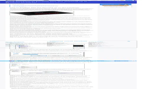

Should you format an SSD that is not detected in BIOS?
1The Claim
“Format SSD Drive... The only solution to clean your drive is to format it.”
2The Reality
An SSD that disappears from BIOS typically has a firmware panic or controller failure. Formatting writes a new partition table and triggers a global TRIM command, which instructs the controller to electrically erase all NAND flash cells. Once TRIM executes, the data is forensically unrecoverable by any tool. The correct response is to power down and seek SSD data recovery where the controller can be accessed directly via PC-3000 SSD vendor-specific commands.
Consequence: Formatting an SSD triggers TRIM, which electrically erases all NAND cells. The data is permanently destroyed.

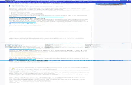

Does defragmenting an SSD improve performance?
1The Claim
“Too many fragments on your SSD will slow it down...”
2The Reality
SSDs have no moving parts. They access any NAND cell in the same amount of time regardless of physical location. Fragmentation is a mechanical hard drive problem where the actuator arm must physically seek between scattered data tracks. On an SSD, "defragmentation" generates thousands of unnecessary write cycles that consume the finite P/E (program/erase) cycle budget of the NAND cells, reducing the drive's lifespan without improving its speed. Since Windows 8, the operating system has managed SSD optimization automatically, issuing periodic TRIM and running only limited defragmentation on its own schedule, so a manual defrag pass for speed serves no purpose. For SSD data recovery, unnecessary write operations reduce the amount of recoverable data by overwriting sectors that still contained intact file content.
Consequence: Defragmenting an SSD wastes write cycles, shortens the drive's lifespan, and can overwrite data that was otherwise still recoverable.

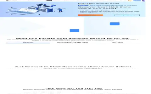

Can consumer software recover data from a failed NAS drive?
1The Claim
“Recover Lost NAS Data Easily and Safely... drive failure, formatting, disk damage.”
2The Reality
NAS devices use RAID arrays (RAID 0, 1, 5, 6, 10) or proprietary storage pools (Synology SHR, QNAP RAID). When a drive fails in a multi-disk array, recovery requires reading the surviving members, reconstructing the array geometry (stripe size, parity rotation, disk order), and rebuilding the logical volume from the raw block data. Consumer software running on a desktop cannot access the NAS's internal RAID controller or reconstruct proprietary array metadata. Claiming "NAS recovery" from "drive failure" misrepresents the fundamental architecture of network-attached storage.
Consequence: Users waste time and money on software that cannot reconstruct RAID array geometry. If the failed drive is connected directly and scanned, the software reads only one member of the array, producing fragmented and unusable output.
