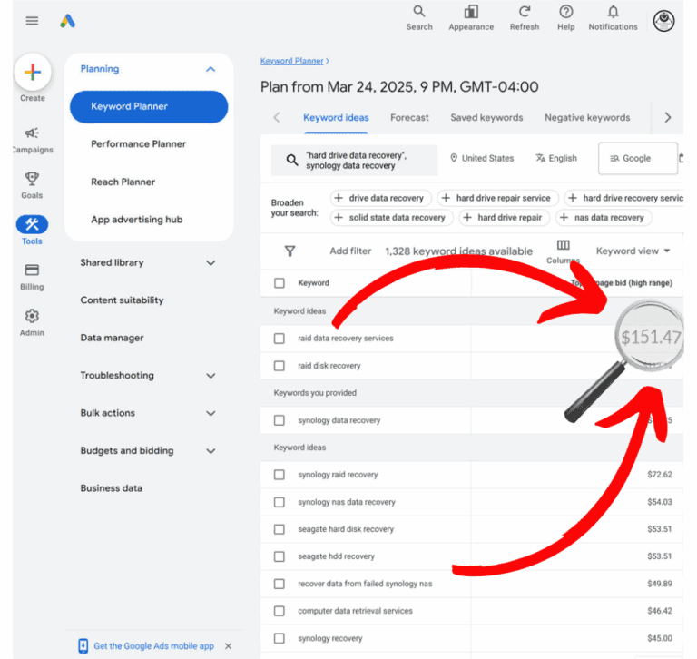

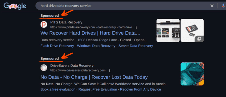

Why data recovery prices vary so much
Paid search for data recovery is expensive before a drive reaches the bench. If a lab buys most of its leads, that ad spend has to be recovered through successful jobs.
Sponsored Google results for data-recovery keywords
Sponsored placement
Placement at the top of the page is paid, not organic.
Google Ads keyword planner showing high CPC for data-recovery terms
High-range CPC
Paid ads
Paid search placement can make every data recovery lead expensive before a drive ever reaches the bench.
Back-of-the-napkin math
Paid ads raise quotes
every click adds cost before diagnosis
marketing overhead per paying customer
If your issue only needs a cheap part or a quick fix, a shop paying these ad costs can't offer you a reasonable price; they'd lose money before they start. We don't spend money on paid ads, which is part of why our quotes are what they are.
Add the cost of maintaining a room-scale ISO clean room on top of that ad budget. For a head swap that we quote at $1,200–$1,500, a room-scale cleanroom adds facility overhead before the drive reaches the bench. The work performed on the drive is the same. Extra facility overhead and advertising do not create better outcomes for your data. See how our pricing compares to DriveSavers.
