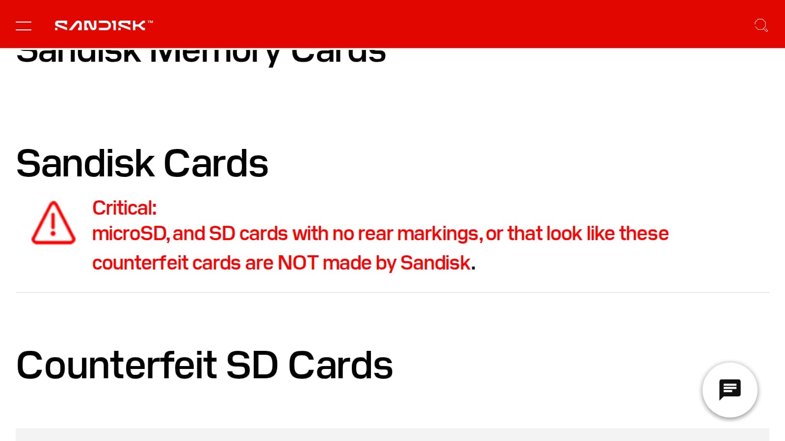

“microSD, and SD cards with no rear markings, or that look like these counterfeit cards are NOT made by Sandisk”
SanDisk support page headed Sandisk Cards, with a warning that microSD and SD cards with no rear markings are not made by Sandisk
SanDisk's own support article treats a blank card back as disqualifying.
SanDisk's own support article treats a blank card back as disqualifying.SanDiskhttps://support-en.sandisk.com/app/answers/detailweb/a_id/53313Read 2026-08-16. Archived copy

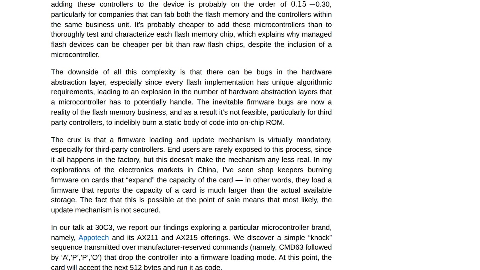

A memory card is a small computer. A controller inside it runs firmware that manages error correction, bad blocks, and the mapping between the addresses a host asks for and the physical flash pages that hold the data. Change that firmware and you change what the card says about itself.
Andrew Huang documented the mechanism in 2013 after watching it done in the electronics markets in Shenzhen. The tools involved are the mass production utilities that controller vendors ship for factory initialization, which set the vendor ID, the product ID, and the capacity the card reports.
“they load a firmware that reports the capacity of a card is much larger than the actual available storage”
Blog post text from bunnie Huang describing shop keepers in China burning firmware that expands the capacity a memory card reports
Huang's 2013 write-up of shop keepers reflashing capacity at the point of sale.
Huang's 2013 write-up of shop keepers reflashing capacity at the point of sale.bunnie's blog (Andrew Huang)https://www.bunniestudios.com/blog/2013/on-hacking-microsd-cards/Read 2026-08-16. Archived copy

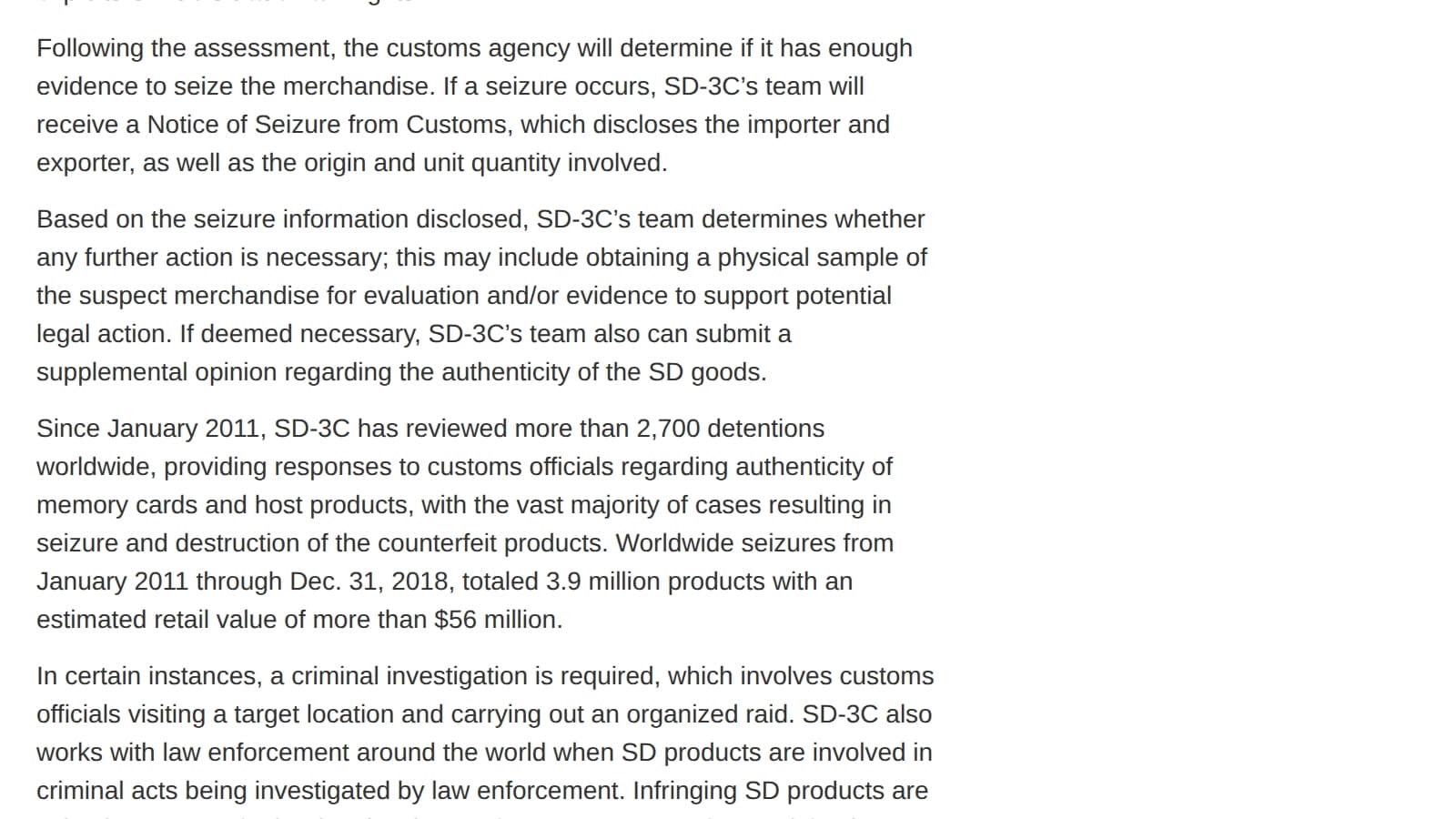

SD-3C customs seizures and enforcement figures
SD-3C licenses the SD trademarks and runs the brand protection programme behind them. Its published enforcement record is the best public measure of how much counterfeit memory moves through legitimate channels, with one caveat: the aggregate figures below were published in 2019 and have not been updated since.
“Since January 2011, SD-3C has reviewed more than 2,700 detentions worldwide, providing responses to customs officials regarding authenticity of memory cards and host products, with the vast majority of cases resulting in seizure and destruction of the counterfeit products. Worldwide seizures from January 2011 through Dec. 31, 2018, totaled 3.9 million products with an estimated retail value of more than $56 million.”
SD Association article passage giving SD-3C customs detention counts since 2011 and worldwide seizure totals through December 2018
Customs detention and seizure totals as SD-3C reported them through the end of 2018.
Customs detention and seizure totals as SD-3C reported them through the end of 2018.SD Associationhttps://www.sdcard.org/press/thoughtleadership/keeping-it-real-how-sd-3c-fights-counterfeit-sd-memory-cards/Read 2026-08-16. Archived copy
“Since 2013, SD-3C's brand protection team has successfully reported NOCIs on more than 125,000 ads offering counterfeit SD memory cards and host products on various e-commerce websites, resulting in their removal.”
Takedown notices filed against counterfeit listings on e-commerce sites.SD Associationhttps://www.sdcard.org/press/thoughtleadership/keeping-it-real-how-sd-3c-fights-counterfeit-sd-memory-cards/Read 2026-08-16. Archived copy
Enforcement did not stop when the reporting did. SD-3C records that in December 2025 customs authorities in the United Arab Emirates seized counterfeit SD cards with an estimated retail value of $330,000.

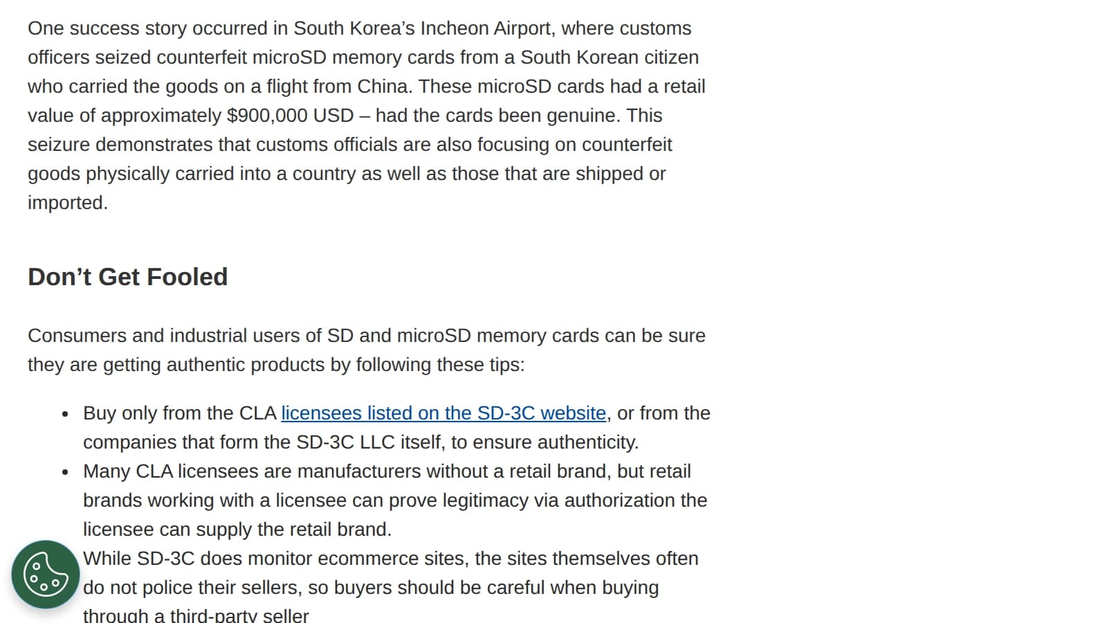

The reason these cards reach buyers through ordinary storefronts is that the marketplaces are not the ones checking. SD-3C says as much itself.
“While SD-3C does monitor ecommerce sites, the sites themselves often do not police their sellers, so buyers should be careful when buying through a third-party seller”
SD Association passage stating that SD-3C monitors ecommerce sites but the sites often do not police their own sellers
The licensor's own view of who is checking listings on marketplaces.
The licensor's own view of who is checking listings on marketplaces.SD Associationhttps://www.sdcard.org/press/thoughtleadership/keeping-it-real-how-sd-3c-fights-counterfeit-sd-memory-cards/Read 2026-08-16. Archived copy
One structural risk did get smaller in 2026. Amazon ran a stickerless commingled inventory system for years, where units from different sellers sharing a manufacturer barcode went into the same physical bin, so the unit shipped against an order was not necessarily the unit that seller supplied. For inventory shipped on or after 31 March 2026, Amazon requires resellers who are not the registered brand representative to apply Amazon barcodes to every unit, which keeps their stock physically separate. Brand owners enrolled as brand representatives can still use manufacturer barcodes under what Amazon calls virtual tracking.
That change narrows one specific path. It does not touch the more common one, which is a third-party seller listing counterfeit stock under its own account and shipping exactly what it received.

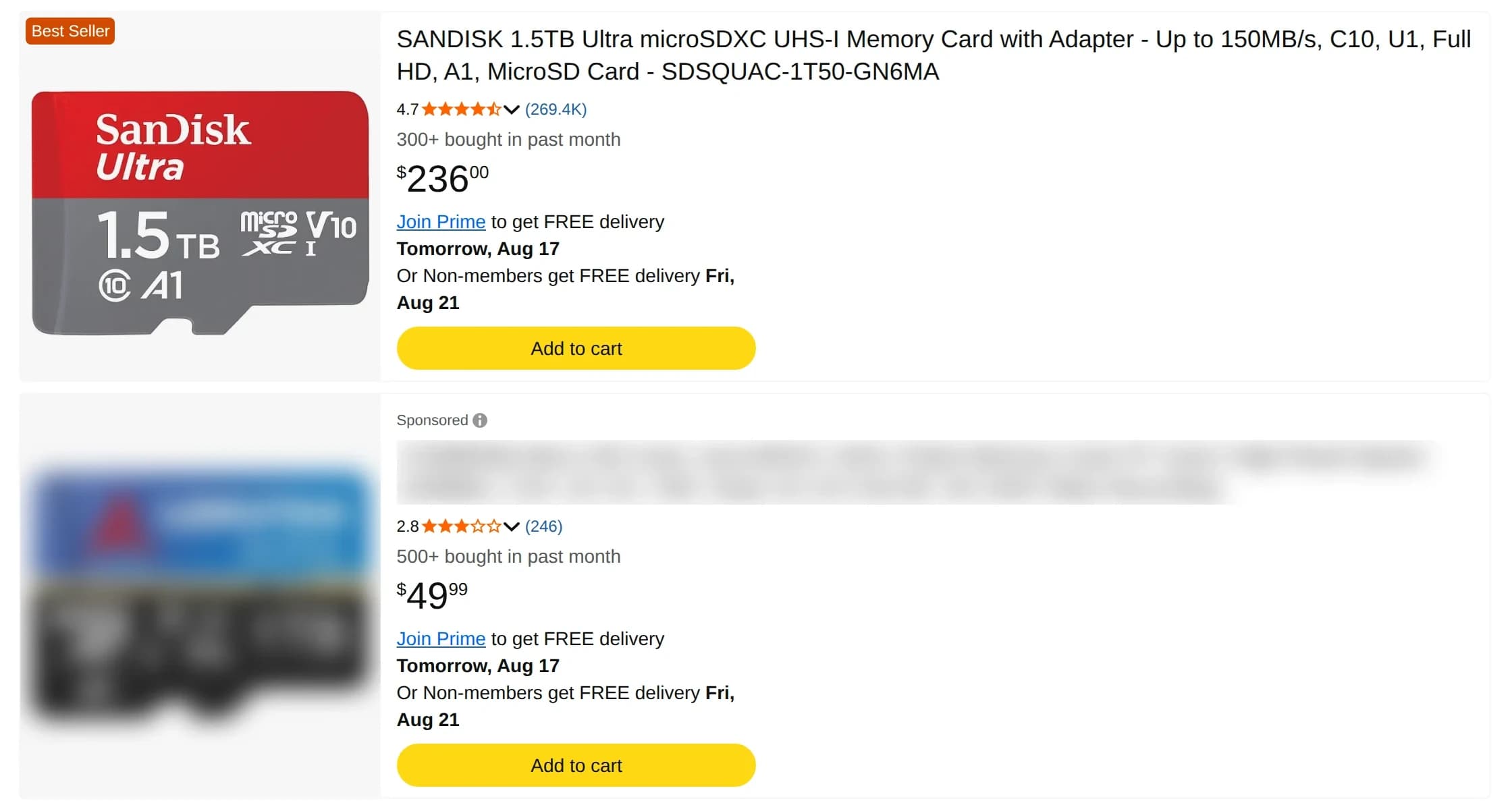

Buy a card you can verify
Counterfeit risk tracks one thing more than any other, which is how many hands the card passed through and whether you can name them. Buying from the manufacturer or from a retailer that is itself the seller of record removes the anonymous third party from the transaction.
  1. Buy from the manufacturer store or a specialist retailer. Manufacturer storefronts, camera specialists, and physical stores that stock their own inventory are the lowest risk channels, because the seller of record is a business with a name and a supply chain.
  2. Read the sold by and ships from line before you order. On a marketplace you want the retailer or the brand itself in the sold by field. A third-party seller name you do not recognise means the marketplace is providing logistics, not vetting.
  3. Check the capacity against what manufacturers ship. 2TB is the largest microSD capacity shipping as of August 2026. A listing above that is selling something that does not exist at retail.
  4. Price the card against the manufacturer store. A large discount is a reason to look harder at the seller. Full price is not a guarantee of anything, since counterfeits are sold at retail prices too.
