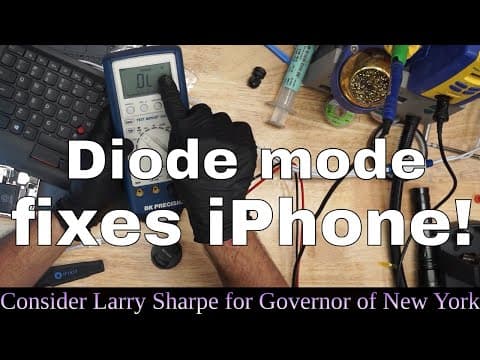

An iPhone 6S powers on and draws current normally, but the screen stays black. The display connector (J4200) carries 30+ pins for power, data, and control signals. Rather than guessing which of the thousands of possible failure points is responsible, the technician uses multimeter diode mode to compare pin-by-pin readings against a known-working board. 19 minutes of systematic diagnosis.

Diode mode pushes a small current (1-2mA) through a test point and measures the voltage drop. That voltage-drop reading is what makes the pin-by-pin comparison work; continuity/beeper mode only tells you whether a connection exists, not the diode signature of each pin. Both modes use low test currents and are safe on logic boards. Normal readings on the iPhone 6S display connector fall between 0.3V and 0.7V depending on the pin. A reading near 0.0V indicates a short to ground; OL (open line) indicates a broken connection.
The technique only works by comparison. A single reading is meaningless without knowing what the same pin reads on a working board. The technician tests every pin on both the broken and working iPhone 6S, records the values, and looks for pins where the numbers differ.
Summary04/06
The Finding: A Shorted Reset Signal
Most pins on the broken board matched the working one. The exception: AP_TO_LCM_RESET_L read 0.1V in diode mode (should be 0.3-0.5V) and 94 ohms in resistance mode. This is the display controller's reset line. When it is held low by a short, the display controller never initializes, and nothing appears on screen.
With one measurement, the technician narrowed the problem from "any of thousands of components" to "something on the reset signal circuit is pulling it to ground." The schematic shows which components sit on that line. That is where the repair starts.
