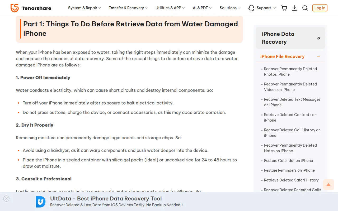

Rice Followed by USB Power: Combined Failure Mechanism
Two software vendors instruct users to first place a water-damaged phone in rice for 24 to 50 hours, then connect it to a computer via USB to run their recovery software. The rice period lets dissolved minerals crystallize into conductive bridges across the logic board. The subsequent USB connection drives 5V through those bridges, destroying the processor and its hardware-bound encryption keys in a single event.
Myth #1

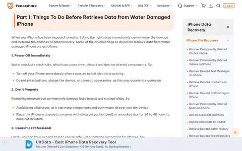

Tenorshare: Rice for 48 Hours, Then Connect to USB
The Misconception
Tenorshare's water damage recovery guide instructs users to place the iPhone in rice or silica gel for 24 to 48 hours, then connect it to a computer via USB to run their UltData software scan.
Source: Tenorshare
“Place the iPhone in a sealed container with silica gel packs (ideal) or uncooked rice for 24 to 48 hours to draw out moisture.”
Screenshot of Tenorshare website showing the claim: "Place the iPhone in a sealed container with silica gel packs..."Click to enlarge screenshot
Tenorshare page screenshot
View archived copy
Original: https://www.tenorshare.com/iphone-recovery/recover-data-from-water-damaged-iphone.html
Captured 2026-03-23

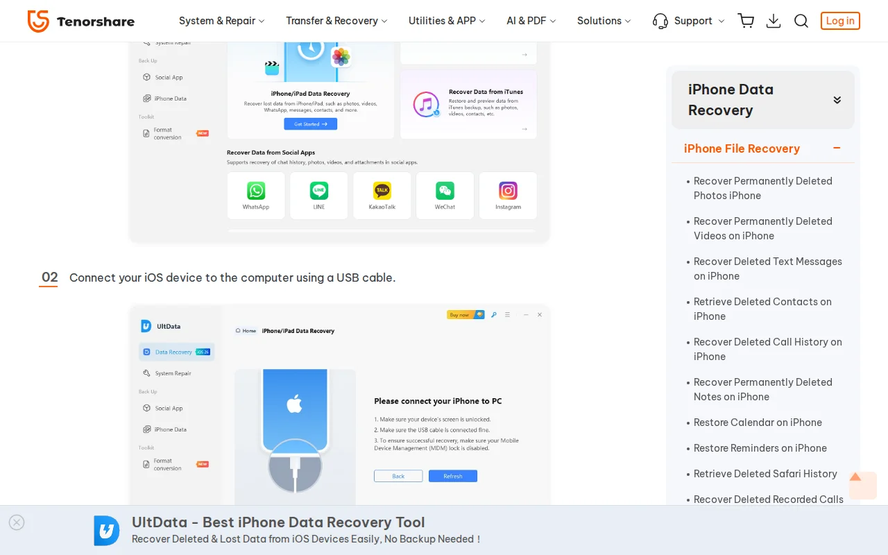

Source: Tenorshare
“Connect your iOS device to the computer using a USB cable. Pick the data types to recover and click Scan.”
Screenshot of Tenorshare website showing the claim: "Connect your iOS device to the computer using a USB cable. P..."Click to enlarge screenshot
View archived copy
Captured 2026-03-21
The Reality
The 48-hour waiting period in rice ensures complete evaporation of the solvent, precipitating dissolved mineral solutes across the pins of the CPU, NAND, and PMIC into highly conductive crystalline bridges. When the user connects the 5V USB cable, the Tristar/Hydra logic IC authentication is bypassed by these mineral bridges, driving 5V directly into the 1.8V logic rails. The Secure Enclave Processor is destroyed on contact.
Why This Matters
The iPhone's CPU is permanently destroyed by overvoltage, and the hardware-fused encryption keys inside the Secure Enclave are physically destroyed. The encrypted data becomes mathematically unrecoverable because the key no longer exists.
Correct Recovery Procedure
Immediate disassembly, EMI shield removal, and ultrasonic cleaning of the bare logic board in 99% IPA. After cleaning, microscopic inspection and component-level repair using a Hakko FM-2032 microsoldering iron before any power is applied. Full Tenorshare technical analysis.
Source: Electrochemical migration: dendritic growth mechanism under DC bias in presence of dissolved ionic contaminants

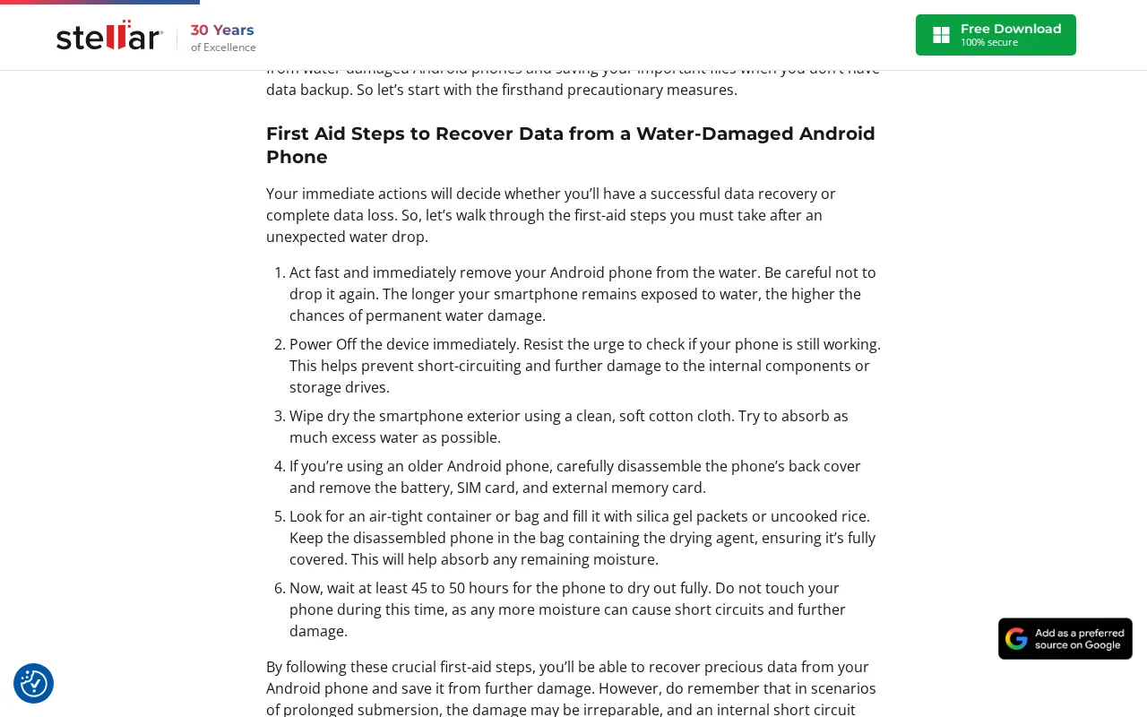

Stellar: Rice for 50 Hours, Then Boot Android and Enable USB Debugging
The Misconception
Stellar's guide instructs users to keep a water-damaged phone in rice or silica gel for 45 to 50 hours, then boot into Android, navigate the UI, tap "File Transfer," enable USB Debugging in Settings, and connect to their desktop software.
Source: Stellar
“Look for an air-tight container or bag and fill it with silica gel packets or uncooked rice. Keep the disassembled phone in the bag containing the drying agent... wait at least 45 to 50 hours for the phone to dry out fully”
Screenshot of Stellar website showing the claim: "Look for an air-tight container or bag and fill it with sili..."Click to enlarge screenshot
Stellar page screenshot
View archived copy
Original: https://www.stellarinfo.com/blog/recovering-data-from-water-damaged-phone/
Captured 2026-03-23
The Reality
This procedure is physically impossible to execute safely. Tapping File Transfer requires the device to be fully booted into Android with the screen backlight drawing 15V to 25V through the display driver IC. Applying USB power while forcing the backlight driver to operate under a mineral-crusted, corroded load guarantees a high-voltage short across the logic board.
Why This Matters
The 50-hour rice period maximizes mineral crust formation across all solder joints. Booting the phone and connecting USB drives battery plus USB current through those crusts, burning through PCB substrate layers and destroying the SoC encryption keys.
Immediate disassembly and ultrasonic cleaning. FLIR thermal imaging to identify shorted components. Targeted rework using a Hakko FM-2032 on an FM-203 base station. Full Stellar safety analysis.
Source: PCB electrochemistry: hygroscopic mineral crust conductivity after solvent evaporation

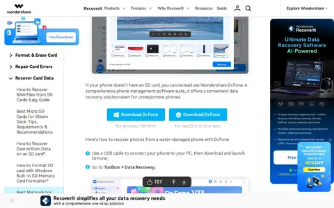

Myth #3
Wondershare: Connect Water-Damaged Phone and Force Download Mode
The Misconception
Wondershare instructs users to connect a water-damaged phone to a PC via USB, launch Dr.Fone, and force the device into Download Mode. The same page also recommends leaving the phone in silica packets overnight.
Source: Wondershare
“Use a USB cable to connect your phone to your PC, then download and launch Dr.Fone... Follow the on-screen instructions to put your device in download mode, then click Next;”
Screenshot of Wondershare website showing the claim: "Use a USB cable to connect your phone to your PC, then downl..."Click to enlarge screenshot
Wondershare page screenshot
View archived copy
Original: https://recoverit.wondershare.com/memorycard-recovery/recover-data-from-water-damaged-phone.html
Captured 2026-03-23
The Reality
Forcing a water-damaged device into Download Mode wakes the Application Processor from its low-power sleep state, energizing the high-current CPU core voltage rails (0.9V to 1.2V). Simultaneously connecting the 5V USB cable across a wet, mineral-bridged board forces rapid copper trace dissolution. The dissolved copper precipitates as green copper chloride deposits visible under a stereo microscope.
Why This Matters
The phone's processor is destroyed within seconds of USB connection, permanently sealing the hardware-encrypted user data.
Power off the phone. Do not charge it. Send to a board-level repair lab for ultrasonic cleaning and component-level diagnosis before any power source is connected.
Source: Anodic dissolution: copper chloride precipitation under 5V DC bias across dissolved ionic contaminants

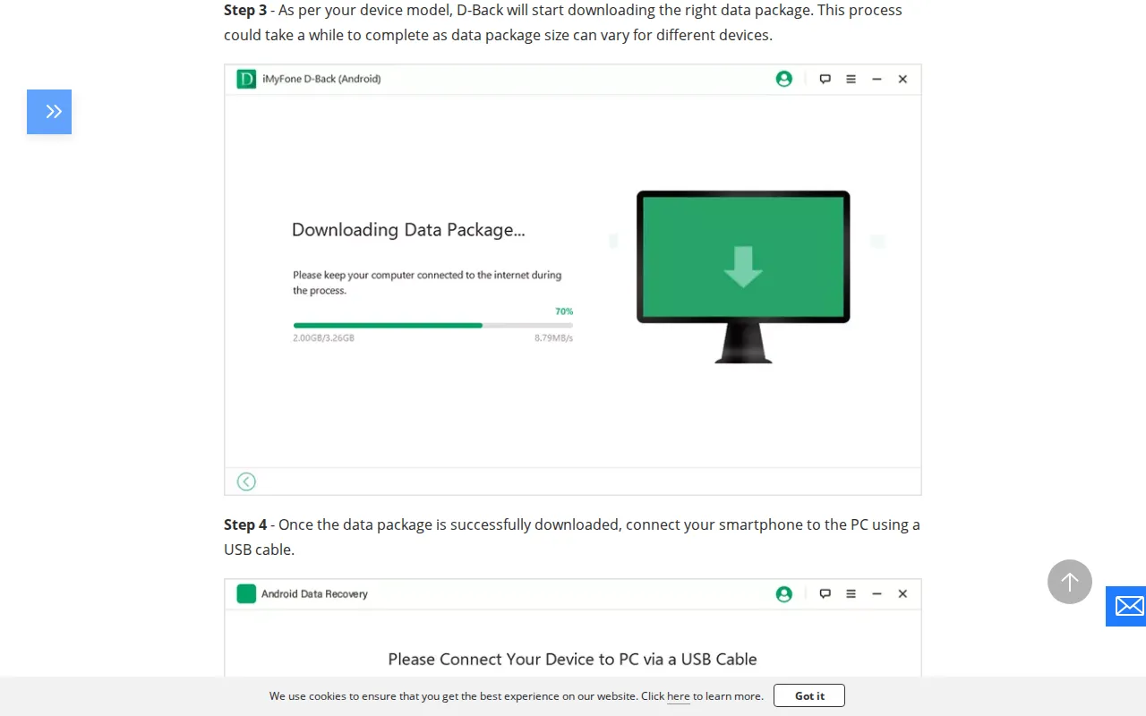

Myth #4
iMyFone: USB Connection for a Phone That Will Not Turn On
The Misconception
iMyFone instructs users to connect a water-damaged Android phone that "won't turn on" to a PC via USB cable to run their D-Back recovery software.
Source: iMyFone
“Once the data package is successfully downloaded, connect your smartphone to the PC using a USB cable.”
Screenshot of iMyFone website showing the claim: "Once the data package is successfully downloaded, connect yo..."Click to enlarge screenshot
iMyFone page screenshot
View archived copy
Original: https://www.imyfone.com/android-recovery-tips/recover-data-from-water-damaged-android/
Captured 2026-03-23
The Reality
A device that refuses to power on after water exposure has already triggered an overcurrent protection circuit or suffered a hard short to ground on a primary rail. Applying external 5V USB power forces unmetered current into these failed protection circuits. Under thermal imaging with a FLIR camera, the shorted component glows as a hotspot on the board.
Why This Matters
The 5V USB power drives current through already-failed protection circuits directly into the CPU data lines, destroying the processor and its hardware-fused encryption keys.
Board-level diagnosis: remove EMI shields, probe voltage rails with a multimeter, identify the shorted component under a microscope, and replace it with a Hakko FM-2032 microsoldering iron before any power is applied.
Source: Overcurrent protection circuit failure mode: 5V bypass of failed PMIC protection FETs

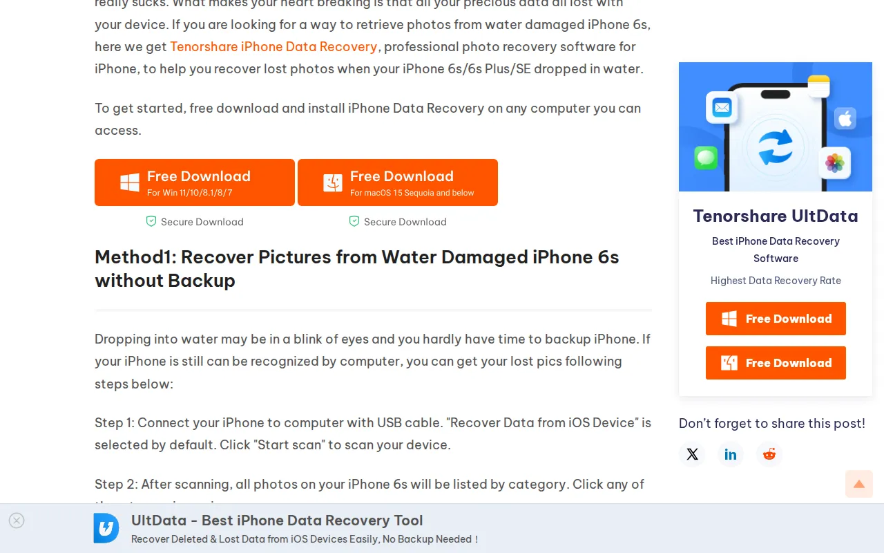

Myth #5
Tenorshare iOS: Connect Water-Damaged iPhone 6s via USB
The Misconception
Tenorshare's iPhone Data Recovery page instructs users to "Connect your iPhone to computer with USB cable" and "Click Start scan" as the first step for recovering photos from a water-damaged iPhone 6s.
Source: Tenorshare
“Step 1: Connect your iPhone to computer with USB cable. Recover Data from iOS Device is selected by default. Click Start scan to scan your device.”
Screenshot of Tenorshare website showing the claim: "Step 1: Connect your iPhone to computer with USB cable. Reco..."Click to enlarge screenshot

The Reality
Apple's Lightning architecture relies on the Tristar (or Hydra on later models) logic IC to authenticate the USB handshake before allowing voltage to pass to the main board. Liquid bridging the Tristar IC's pins allows the incoming 5V VBUS to jump the authentication gate entirely, sending unmetered 5V power into the 1.8V I2C communication lines. The A-series processor's silicon gates blow instantly.
Why This Matters
The Secure Enclave is permanently dead. All photos, messages, and data on the iPhone are cryptographically sealed forever.
Ultrasonic cleaning of the bare logic board in 99% IPA. Tristar/Hydra IC inspection under a stereo microscope at 20x magnification. Component replacement using a Hakko FM-2032 if charred pads are found around the IC footprint.
Source: Apple Lightning architecture: Tristar/Hydra IC voltage authentication gate bypass via liquid bridging

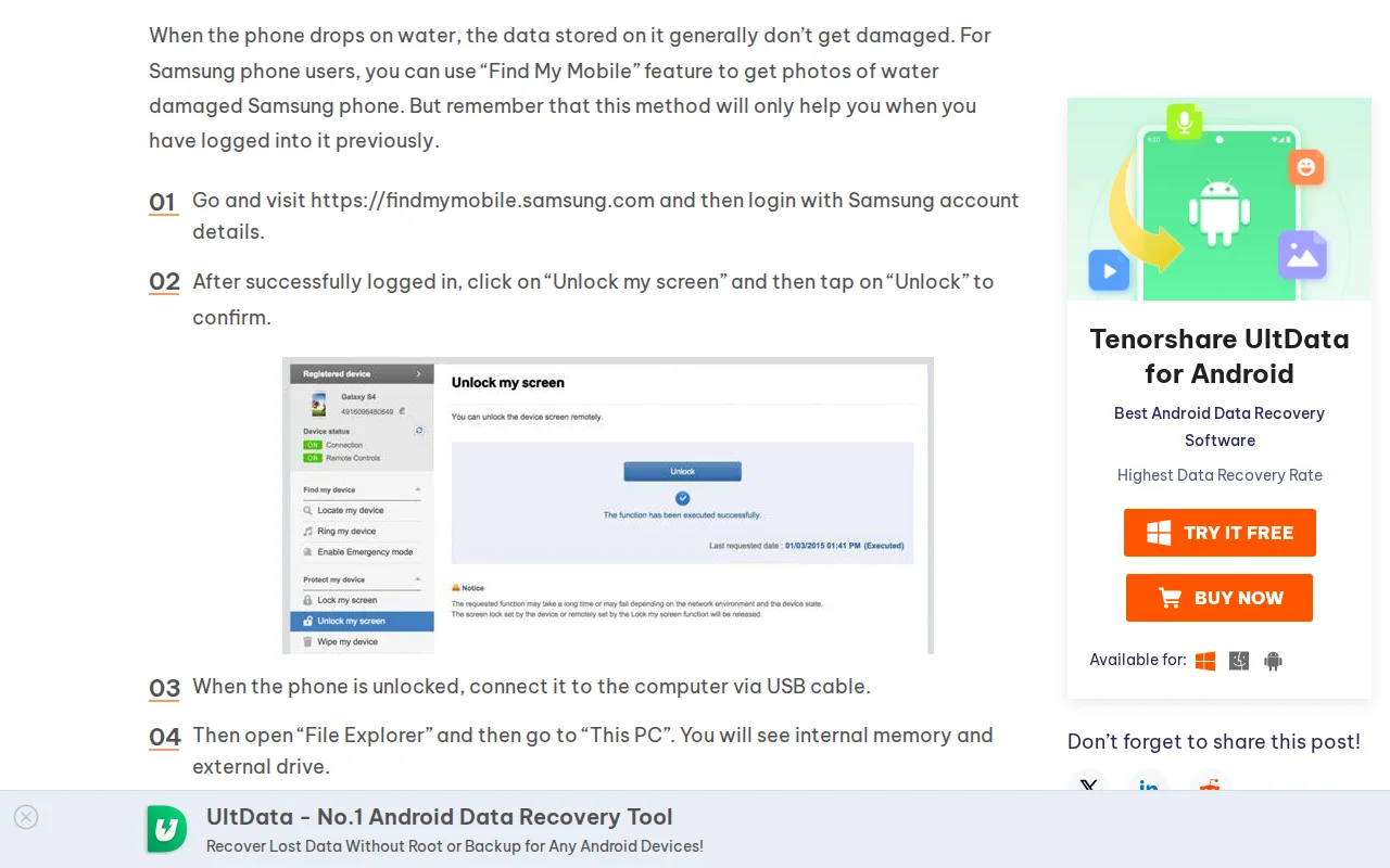

Myth #6
Tenorshare Android: Connect Wet Samsung via USB While Display Is Active
The Misconception
Tenorshare instructs users of a water-damaged Samsung Galaxy S6 to unlock the phone and "connect it to the computer via USB cable. Then open File Explorer and then go to This PC."
Source: Tenorshare
“When the phone is unlocked, connect it to the computer via USB cable. Then open File Explorer and then go to This PC.”
Screenshot of Tenorshare website showing the claim: "When the phone is unlocked, connect it to the computer via U..."Click to enlarge screenshot
View archived copy
Original: https://www.tenorshare.com/samsung/how-to-recover-photos-from-water-damaged-samsung.html
Captured 2026-03-23
The Reality
This instruction requires the Samsung device to be fully powered on, unlocked, and operating its high-voltage display circuits while wet. Connecting the USB cable introduces an external 500mA to 2000mA current source, supercharging the rate of electrochemical corrosion. As the copper traces dissolve under this load, the connections between the CPU and the UFS storage chip sever completely.
Why This Matters
The electrical connections between the CPU and storage are permanently severed by accelerated corrosion, and the hardware encryption keys become unreachable.
Power off immediately. Do not unlock or interact with the screen. Send the device for ultrasonic cleaning and board-level inspection.
Source: UFS data line copper trace dissolution under externally applied 5V USB current load

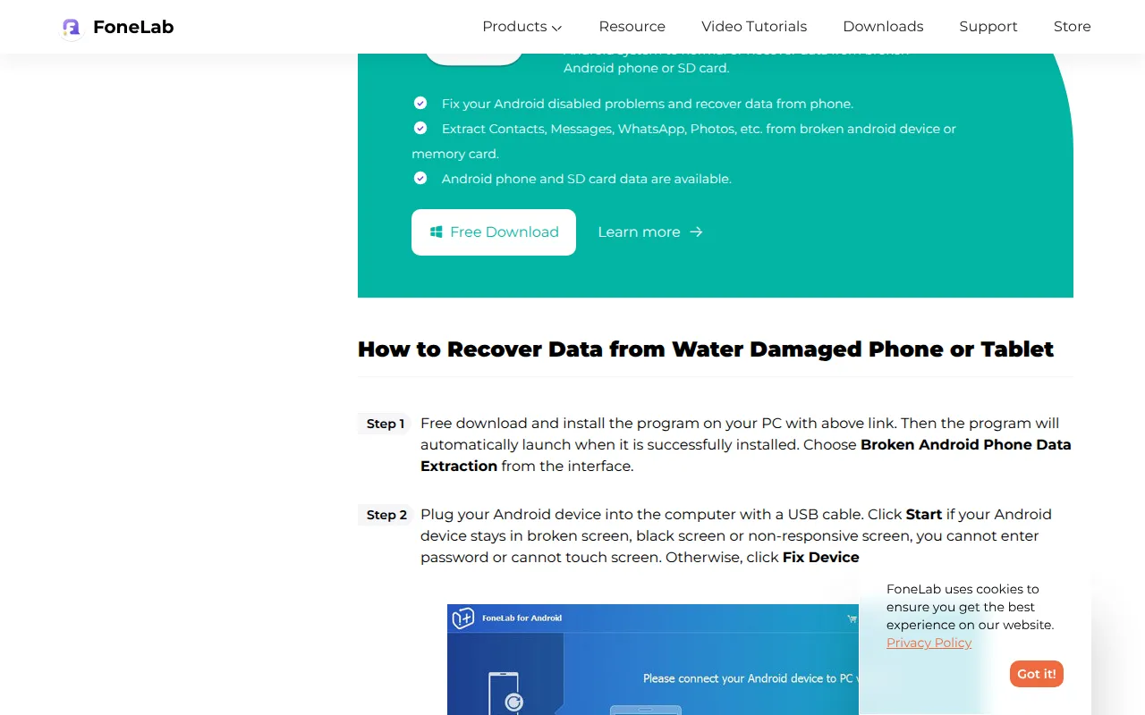

FoneLab: USB Connection With Forced Download Mode Button Combo
The Misconception
FoneLab instructs users to plug a water-damaged Android phone into a computer via USB, then force it into Download Mode by pressing "Volume Down + Home + Power" simultaneously on the wet device.
Source: FoneLab
“Step 2 Plug your Android device into the computer with a USB cable... This step will lead your Samsung phone to enter Download mode. Follow the on-screen instruction to enter: power off the phone – press and hold the Volume Down + Home + Power button together...”
Screenshot of FoneLab website showing the claim: "Step 2 Plug your Android device into the computer with a USB..."Click to enlarge screenshot
FoneLab page screenshot
View archived copy
Original: https://www.fonelab.com/resource/retrieve-media-files-from-water-damaged-android-phone-and-tablet.html
Captured 2026-03-23
The Reality
Manually depressing hardware buttons on a wet device forces mechanical switch contacts to close through liquid. If liquid is present in the switch membranes, the electrical resistance drops, causing unpredictable current paths. Commanding the user to apply USB power while pressing wet hardware switches to force Download Mode guarantees that massive electrical loads are drawn across liquid-bridged circuits.
Why This Matters
The combination of USB power and forced Download Mode activation on a wet board causes cascading short circuits that destroy the SoC and its encryption keys.
Do not press any buttons on a wet phone. Do not connect USB. Send to a board-level repair lab for proper disassembly and cleaning.
Source: Mechanical switch contact resistance variation in presence of liquid electrolyte

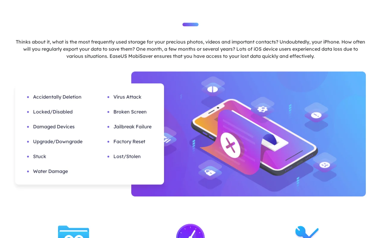

EaseUS: Water Damage Listed as Recoverable via USB Software
The Misconception
EaseUS lists "Water Damage" alongside "Broken Screen" and "Damaged Devices" as a supported recovery scenario for their MobiSaver software, which requires connecting the iPhone to a PC via USB.
Source: EaseUS
“Accidentally Deletion, Locked/Disabled, Damaged Devices, Upgrade/Downgrade, Stuck, Water Damage, Virus Attack, Broken Screen, Jailbreak Failure, Factory Reset, Lost/Stolen”
Screenshot of EaseUS website showing the claim: "Accidentally Deletion, Locked/Disabled, Damaged Devices, Upg..."Click to enlarge screenshot
EaseUS page screenshot
View archived copy
Original: https://www.easeus.com/mobile-tool/iphone-data-recovery-pro.html
Captured 2026-03-23
The Reality
The software's fundamental workflow requires plugging the water-damaged device into a PC. Subjecting a wet Apple logic board to active USB polling triggers the Tristar IC to attempt an electrical handshake, causing liquid to bridge the 5V VBUS into the processor's logic grid. The silicon gates blow, and the hardware encryption keys are permanently destroyed.
Why This Matters
The USB handshake attempt on a wet board bridges 5V into the 1.8V logic domain, destroying the Secure Enclave and all hope of data recovery.
Ultrasonic cleaning of the bare logic board in 99% IPA, followed by component-level diagnosis and Hakko FM-2032 microsoldering to replace any damaged ICs. Full EaseUS safety analysis.
Source: USB polling handshake: Tristar IC voltage gate bypass via liquid bridge on 5V VBUS rail

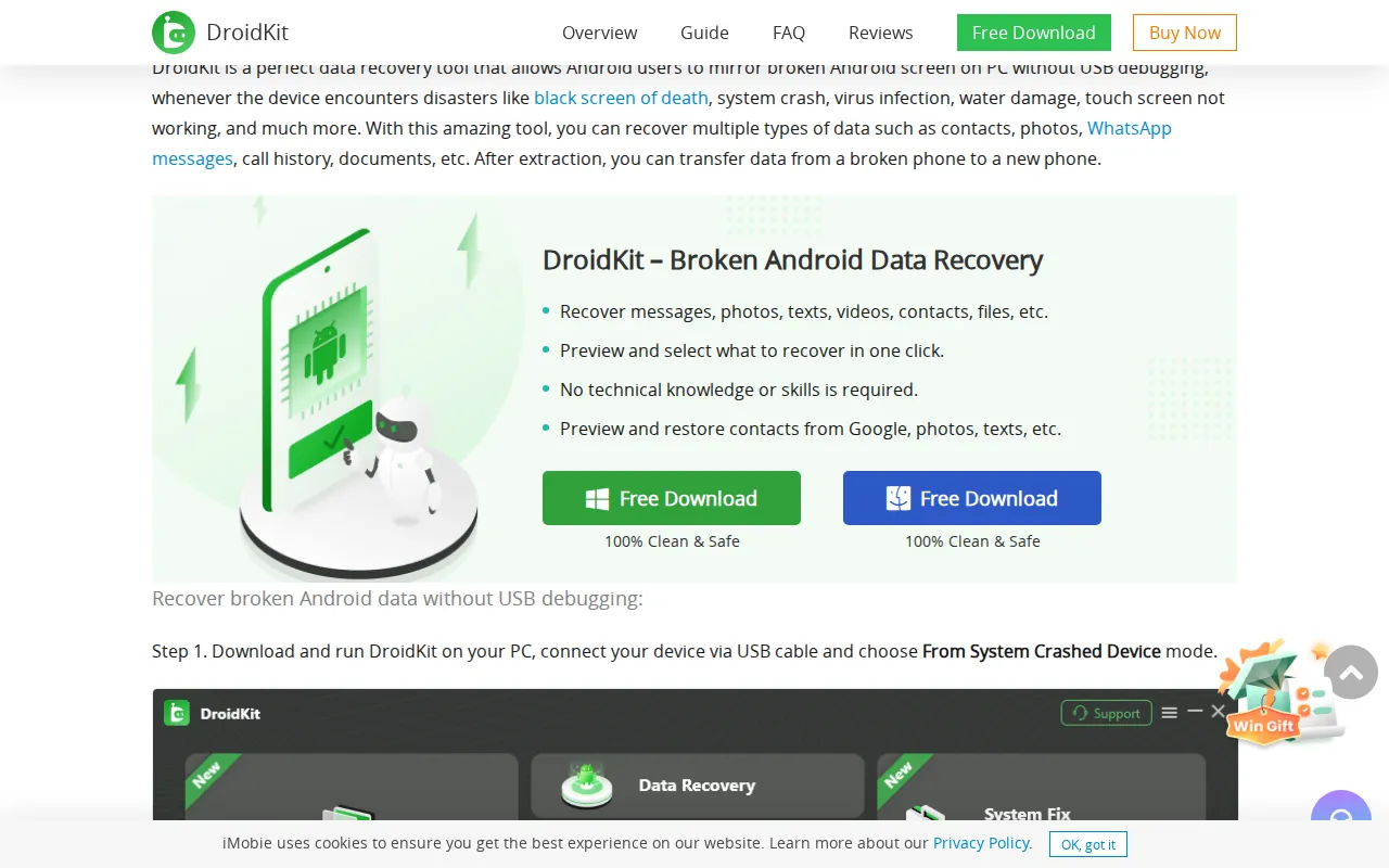

Myth #9
iMobie: USB Connection for Water-Damaged Android With Black Screen
The Misconception
iMobie's DroidKit page lists "water damage" as a supported scenario and instructs users to "connect your device via USB cable and choose From System Crashed Device mode" to recover data from a phone with a black screen.
Source: iMobie
“Download and run DroidKit on your PC, connect your device via USB cable and choose From System Crashed Device mode.”
Screenshot of iMobie website showing the claim: "Download and run DroidKit on your PC, connect your device vi..."Click to enlarge screenshot
iMobie page screenshot

The Reality
A black screen caused by water damage indicates the display driver or backlight circuitry (which operates at 15V to 25V) has failed due to liquid shorts. Injecting a 5V USB signal into this unstable, wet electrical environment guarantees that high-voltage shorts cascade across the logic board, destroying components in multiple voltage domains simultaneously.
Why This Matters
High-voltage display driver shorts cascade into the low-voltage CPU domain, destroying the SoC and its hardware-bound encryption keys.
Full disassembly, ultrasonic cleaning, and systematic voltage rail diagnosis with a multimeter before applying any external power.
Source: OLED/LCD backlight driver IC: 15V-25V boost converter short propagation into 1.8V logic domain

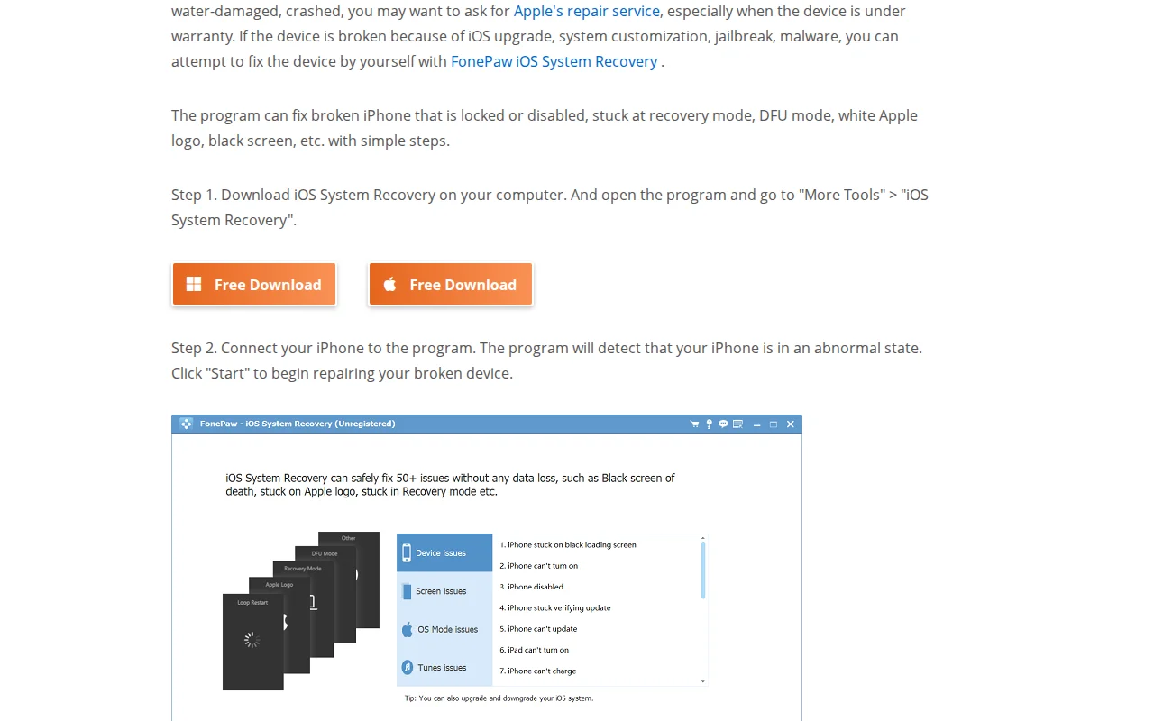

FonePaw: USB Connection and DFU Mode on Water-Damaged iPhone
The Misconception
FonePaw instructs users with "water-damaged" iPhones to connect to their software via USB, then enter "recovery mode or DFU mode" to re-flash the operating system as a repair step.
Source: FonePaw
“Connect your iPhone to the program. The program will detect that your iPhone is in an abnormal state. Click Start to begin repairing your broken device. Your iPhone need to be fixed under recovery mode or DFU mode.”
Screenshot of FonePaw website showing the claim: "Connect your iPhone to the program. The program will detect ..."Click to enlarge screenshot
FonePaw page screenshot
View archived copy
Original: https://www.fonepaw.com/tutorials/recover-data-from-broken-iphone.html
Captured 2026-03-23
The Reality
DFU mode is a low-level hardware state where the bootrom awaits a firmware image transfer over USB. On a water-damaged board, the firmware flash forces sustained high-bandwidth data transfer across corroded, liquid-bridged traces. When the board crashes mid-flash due to physical shorts severing the NAND data lines, the file system is permanently bricked.

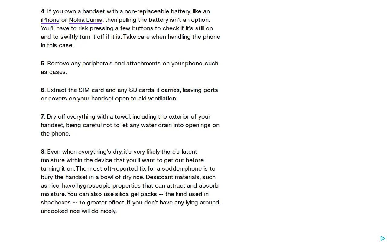

CNET: 24 to 48 Hours in Rice, Then Power On
The Misconception
CNET instructs readers to "Place your phone in an airtight container and completely cover it with your choice of desiccant. Leave the container for 24-48 hours." The article also recommends removing the battery, which is physically impossible on modern sealed smartphones without specialized heat plates.
Source: CNET
“If you don't have any lying around, uncooked rice will do nicely. Place your phone in an airtight container and completely cover it with your choice of desiccant. Leave the container for 24-48 hours for the material to draw all the moisture out of your handset.”
Screenshot of CNET website showing the claim: "If you don't have any lying around, uncooked rice will do ni..."Click to enlarge screenshot
CNET page screenshot
View archived copy
Original: https://www.cnet.com/tech/mobile/how-to-save-a-wet-mobile-phone-and-what-not-to-do/
Captured 2026-03-23
The Reality
Passive desiccants absorb ambient humidity from the surrounding air. They have zero physical mechanism to extract liquid from the microscopic capillary voids (less than 0.05mm) between the PCB substrate and the underside of BGA chip packages. The surface tension holding fluid in these capillary gaps is orders of magnitude stronger than any osmotic gradient rice can generate.
Why This Matters
24 to 48 hours of unchecked corrosion dissolves copper traces and forms conductive mineral bridges. Powering on after rice drives current through those bridges, destroying the board.
Immediate professional disassembly and ultrasonic cleaning. Time spent in rice is time surrendered to unchecked corrosion.
Source: Capillary fluid dynamics: surface tension vs. osmotic gradient in BGA underfill voids

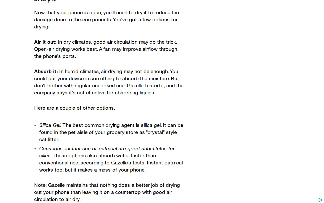

Myth #12

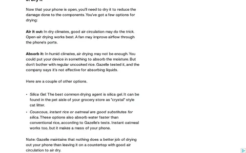

CNET: Oatmeal and Couscous as Phone Desiccants
The Misconception
A second CNET article recommends "Couscous, instant rice or oatmeal" as "good substitutes for silica" and notes that "Instant oatmeal works too, but it makes a mess of your phone."
Source: CNET
“Couscous, instant rice or oatmeal are good substitutes for silica. These options also absorb water faster than conventional rice, according to Gazelle's tests. Instant oatmeal works too, but it makes a mess of your phone.”
Screenshot of CNET website showing the claim: "Couscous, instant rice or oatmeal are good substitutes for s..."Click to enlarge screenshot
View archived copy
Original: https://www.cnet.com/tech/mobile/splish-splash-what-if-your-phone-takes-a-bath/
Captured 2026-03-23
The Reality
Fine particulate dust from oatmeal and couscous acts as an organic adhesive when mixed with water, forming a starchy paste that infiltrates charge ports, speaker grilles, and SIM tray seals. This paste solidifies as it dries, creating a hardened crust that is far more difficult to remove during professional ultrasonic cleaning than the original liquid damage alone.
Why This Matters
The starchy paste from food-grade desiccants contaminates the board far worse than water alone, while the underlying corrosion continues unchecked.
Do not place any food products near a wet phone. Oatmeal-contaminated boards require extended ultrasonic bath cycles and manual brushing under a microscope to remove starch residue from underneath BGA packages.
Source: Organic particulate contamination: starch gelatinization in PCB capillary voids

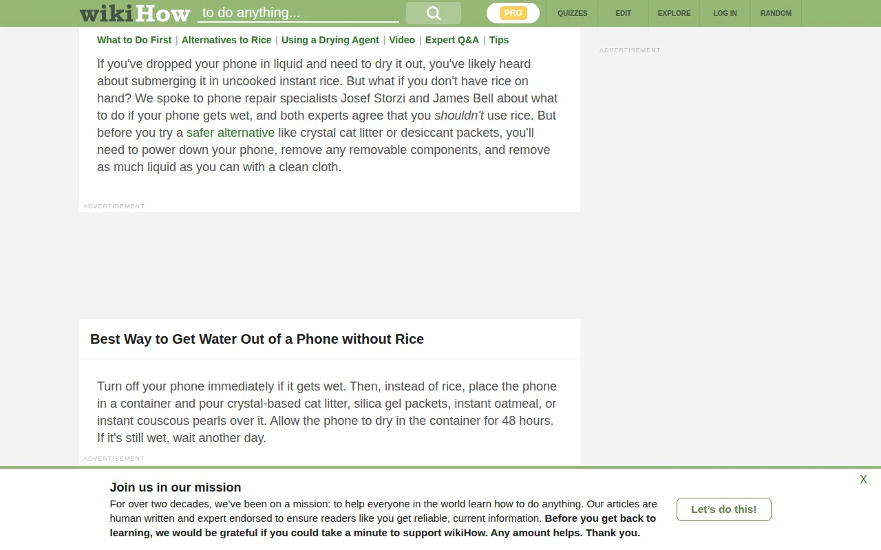

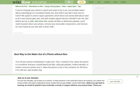

Myth #13
WikiHow: 48 to 72 Hours in Cat Litter or Couscous
The Misconception
WikiHow instructs users to "Place the phone in a large container and pour crystal-based cat litter, instant oatmeal, silica gel beads inside synthetic desiccant packets, or instant couscous pearls over it. Check to see if the phone is dry after 48 hours. If it's still wet, wait another day."
Source: WikiHow
“Place the phone in a large container and pour crystal-based cat litter, instant oatmeal, silica gel beads inside synthetic desiccant packets, or instant couscous pearls over it. Check to see if the phone is dry after 48 hours. If it's still wet, wait another day.”
Screenshot of WikiHow website showing the claim: "Place the phone in a large container and pour crystal-based ..."Click to enlarge screenshot
WikiHow page screenshot
View archived copy
Original: https://www.wikihow.com/Dry-Out-a-Phone-Without-Rice
Captured 2026-03-23
The Reality
By instructing the user to wait up to 72 hours, this guide maximizes the duration of unchecked electrolytic corrosion. Even with the device powered off, the internal battery remains connected to the primary power rail (VDD_MAIN), and liquid bridging this rail to ground actively dissolves copper traces via anodic dissolution for the entire three-day waiting period.
Why This Matters
Three days of battery-powered corrosion dissolves copper traces to the point where board-level repair becomes far more complex. Crystal cat litter introduces silica dust particles into charge ports and speaker openings.
Never wait days before seeking professional help. Every hour of delay allows corrosion to spread to additional solder joints and traces.
Source: Anodic dissolution rate: copper trace mass loss vs. time under battery-supplied VDD_MAIN potential

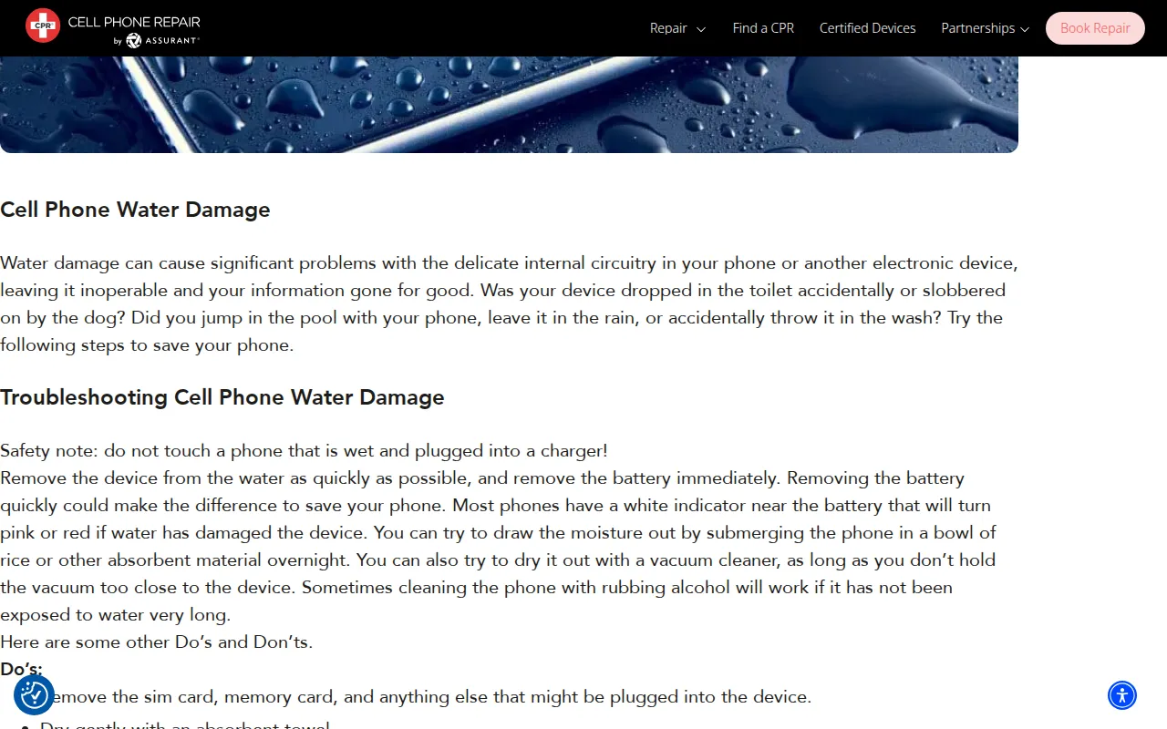

CPR Cell Phone Repair: Rice Overnight and Vacuum Cleaner
The Misconception
CPR Cell Phone Repair instructs customers to "draw the moisture out by submerging the phone in a bowl of rice or other absorbent material overnight" and also recommends drying it "with a vacuum cleaner."
Source: CPR Cell Phone Repair
“You can try to draw the moisture out by submerging the phone in a bowl of rice or other absorbent material overnight.”
Screenshot of CPR Cell Phone Repair website showing the claim: "You can try to draw the moisture out by submerging the phone..."Click to enlarge screenshot
CPR Cell Phone Repair page screenshot
View archived copy
Original: https://www.cellphonerepair.com/common-issues/11494-water-liquid-damage-d146c
Captured 2026-03-23
The Reality
The rice recommendation suffers from the same physics failure as every other passive desiccant: no osmotic gradient can extract liquid from BGA capillary voids. The vacuum cleaner recommendation introduces a separate risk: electrostatic discharge (ESD). The rapidly moving air and plastic nozzle generate massive static voltage potentials. Bringing this nozzle close to a smartphone charge port can inject thousands of volts of static electricity directly into the power management IC.
Why This Matters
The rice does nothing to stop corrosion, and the vacuum cleaner introduces ESD that can blow the PMIC or CPU in a single static discharge event.
A household vacuum is the opposite of a controlled ESD environment.
Source: Electrostatic discharge: triboelectric charging from high-velocity air through plastic nozzle geometry

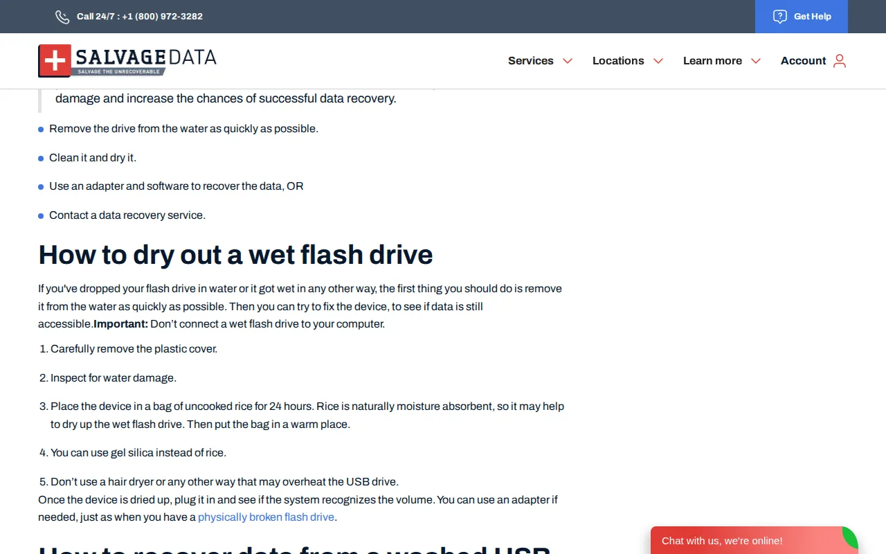

Myth #15
SalvageData: Rice for 24 Hours Plus Heat for a Wet Flash Drive
The Misconception
SalvageData instructs users to "Place the device in a bag of uncooked rice for 24 hours" and "Then put the bag in a warm place." While this finding targets USB flash drives, the physics are identical to phone recovery.
Source: SalvageData
“Place the device in a bag of uncooked rice for 24 hours. Rice is naturally moisture absorbent, so it may help to dry up the wet flash drive. Then put the bag in a warm place.”
Screenshot of SalvageData website showing the claim: "Place the device in a bag of uncooked rice for 24 hours. Ric..."Click to enlarge screenshot
SalvageData page screenshot
View archived copy
Original: https://www.salvagedata.com/blog/wet-flash-drive-what-to-do
Captured 2026-03-23
The Reality
The additional instruction to put the bag in a warm place actively accelerates the electrochemical corrosion. Heat acts as a catalyst for anodic dissolution, meaning the copper trace dissolution occurring between the tightly packed pins of the NAND flash controller IC is accelerated by the thermal input.
Why This Matters
The heat accelerates corrosion on the flash controller's solder joints, and the rice provides a false sense of security while the real damage progresses.
Dry the flash drive at room temperature. If it shows read errors after drying, image it with a hardware write-blocker before attempting any data extraction.
Source: Arrhenius equation: electrochemical corrosion rate doubling per 10C temperature increase
