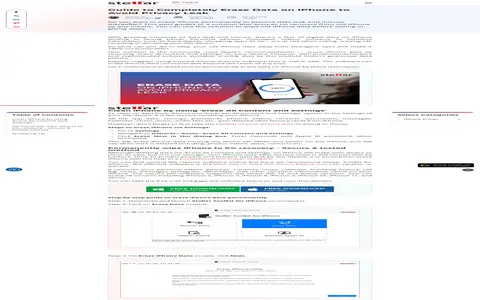

Is factory-reset iPhone data recoverable by hackers?
1The Claim
“Your iPhone data after factory reset is still recoverable by hackers.”
Screenshot of Stellar page showing the quoted claim
2The Reality
Modern iOS devices use hardware-backed AES-256 encryption managed by the Secure Enclave Processor. Every file on the device is encrypted with a unique key derived from the hardware and the user's passcode. When a user executes "Erase All Content and Settings," the device performs a Cryptographic Erase: it destroys the master encryption keys. Without those keys, the data remaining on the NAND is mathematically indistinguishable from random noise. This is not a theoretical limitation; it is the same AES-256 standard used by military and financial institutions. Claiming this data is "recoverable by hackers" is a fabrication designed to sell redundant erasure software. See our iPhone data recovery page for what is and is not possible with encrypted devices.
Consequence: Users purchase unnecessary erasure software based on a fabricated security threat. The factory reset already destroyed the encryption keys; no additional software changes that outcome.

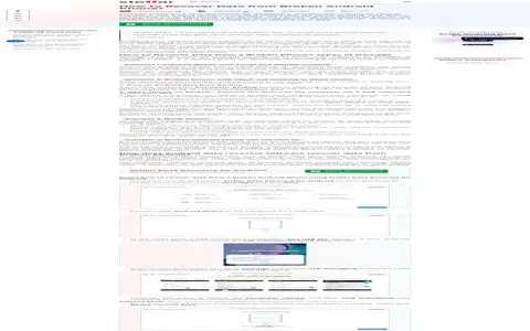

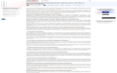

Does Android phone recovery require a cleanroom?
1The Claim
“They need clean room facilities, micro-soldering capability”
2The Reality
Android phones are solid-state devices. There are no exposed platters, no read/write heads, and nothing that airborne particles can damage. A cleanroom or clean bench filters airborne particles to protect hard drive platters during head swaps. Android phone recovery requires board-level microsoldering to repair power delivery circuits (PMIC, charging IC, USB controller) so the SoC boots and the Trusted Execution Environment releases decryption keys. This work is performed on an electronics workbench with a microscope and hot air rework station, not in a cleanroom. See our analysis of cleanroom requirements for a breakdown of when filtered environments are and are not necessary.
Consequence: Users overpay for unnecessary cleanroom facilities or avoid recovery entirely based on fabricated infrastructure requirements. Android phone recovery does not require particle filtration.
