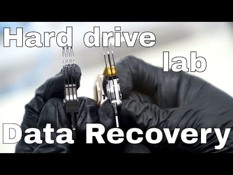

Inside the laminar flow cabinet, the technician removed the read/write heads using a head comb to keep the sliders from sticking together. Without a head comb, the sliders stick to each other and tear when separated; that destroys them.

The platters went onto the donor's functional spindle, the retaining nut was tightened, the tape came off, and the platters spun freely. The drive's original heads were reinstalled, the drive was reassembled, and on first power-up it came up silent; no grinding, no clicking. PC-3000 detected it as ready immediately.
