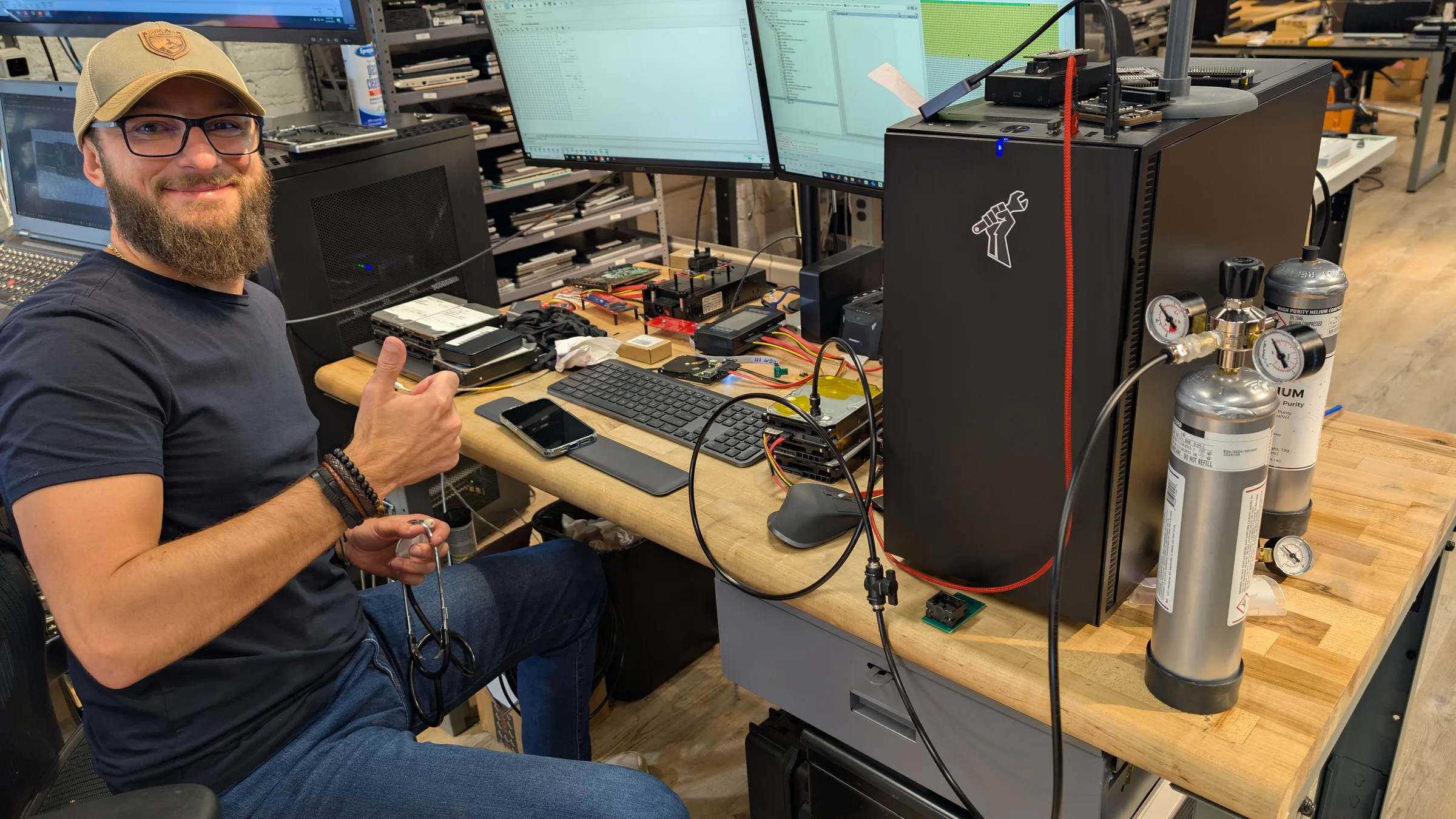

Chris at the helium drive recovery workstation with helium tank and PC-3000 equipment at Rossmann Repair Group Austin lab
Open full-size photo of Chris at the helium drive workstation
Our Austin lab: helium tank (right), PC-3000 imaging stations (background), and 0.02µm ULPA-filtered clean bench used for helium drive head swaps. Photo taken August 2025.

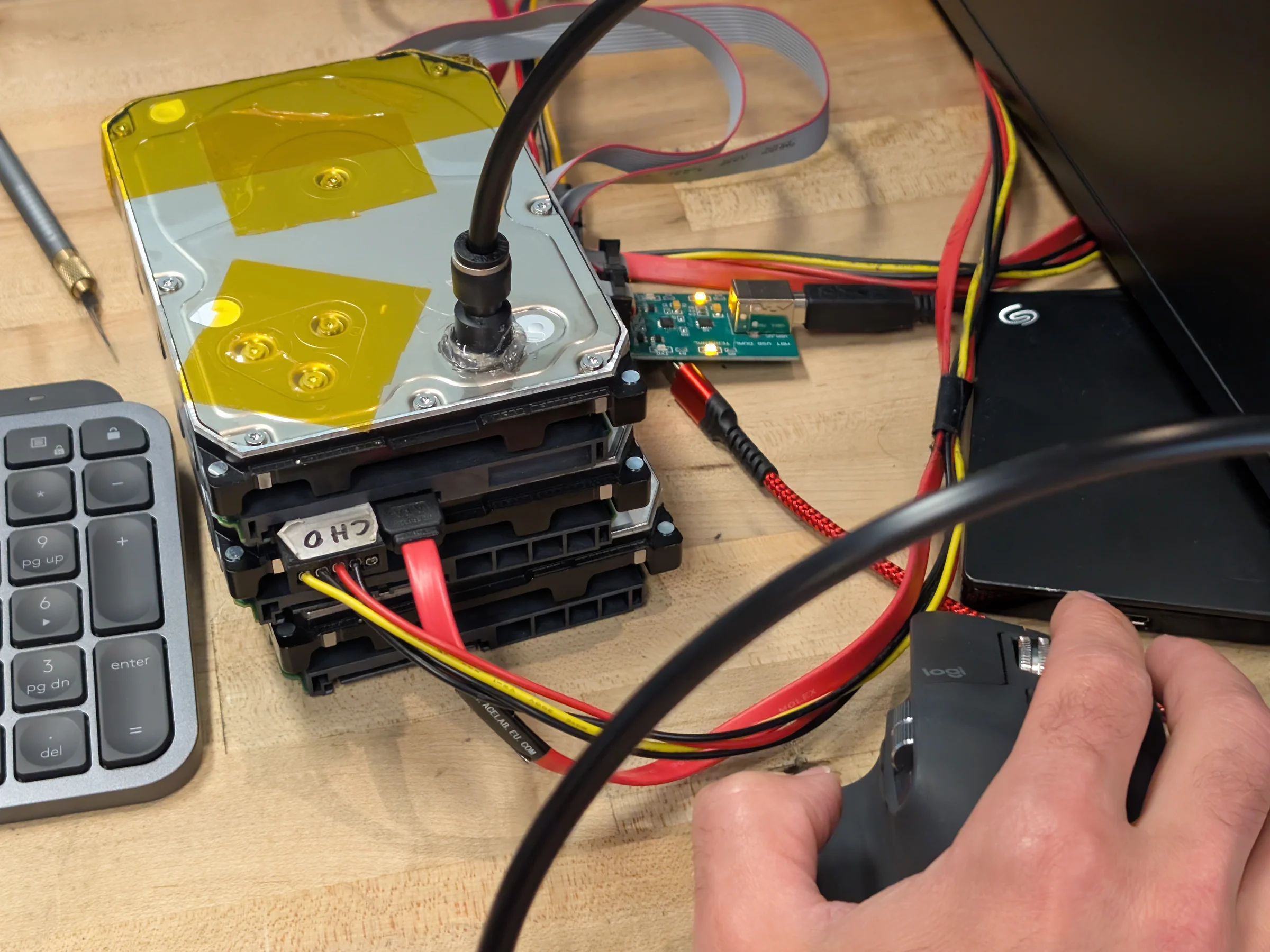

Opened helium hard drive connected to helium tank and PC-3000 during active data recovery at Rossmann Repair Group
Open full-size photo of opened helium drive with helium tank and PC-3000
An opened helium drive connected to our helium tank during an active head swap recovery. The drive is connected to PC-3000 for immediate imaging after helium refill. August 2025.
