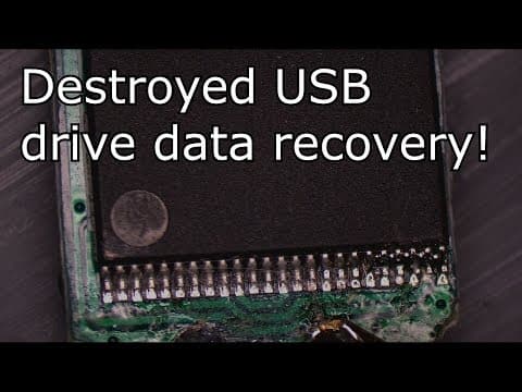

Watch: USB Flash Drive Recovery in Our Lab
Louis walks through a USB flash drive recovery after the customer destroyed the drive during a DIY chip-off attempt. Micro-soldering repairs on ripped pads, bent pins, and damaged traces, followed by NAND chip swapping.
