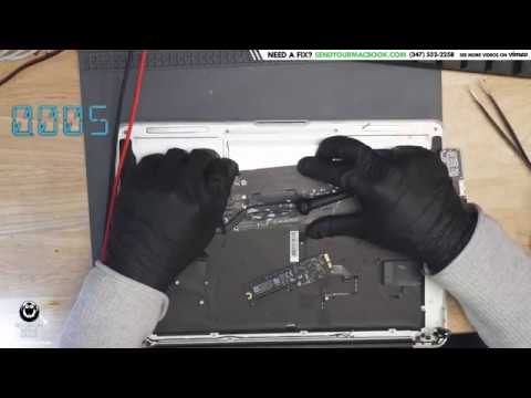

MacBook SSD Catches Fire: Can the Data Be Recovered?
MacBook Air (Soldered Apple SSD) | Short circuit / thermal runaway
FLIR Thermal CameraHakko Microsoldering StationMultimeter
MacBook Air produced visible smoke from the SSD area on power-up. Multimeter confirmed 0.4 ohms across SSD pins: a direct short causing thermal runaway. Video covers damage assessment, T2/Apple Silicon encryption implications, and the only viable recovery path: repairing the logic board at the component level so the Secure Enclave can power on and decrypt in place. NAND desoldering produces only AES-256 ciphertext without the board functioning.

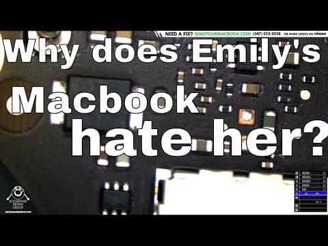

MacBook A1706: Corroded Resistor Kills SSD Detection
MacBook Pro A1706 (Soldered SSD) | Liquid damage / corroded resistor R9350
MultimeterHakko Microsoldering StationBoardview
MacBook A1706 boots to question mark folder after liquid spill. SSD physically intact; the problem was corroded resistor R9350 on the SSD power delivery circuit. The resistor (1.3 megohm pull-up on the IUVD pin of U9300 Piccolo PMIC) read open line. Replacement restored SSD detection. NAND was undamaged; only macOS installation needed reinstall.

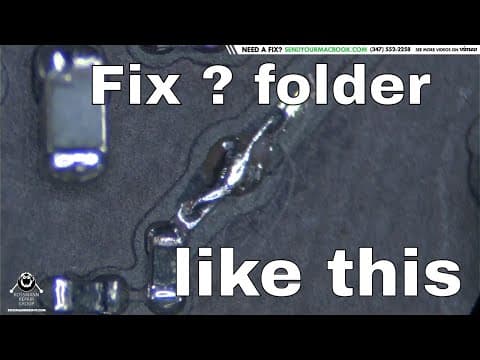

A1706 Probe Point Corrosion: Same Board, Same Spot, Every Time
MacBook Pro A1706 (Soldered SSD) | Liquid damage / corroded probe point on V2.7 NAND rail
MultimeterHakko Microsoldering StationMicroscope
Liquid enters through the keyboard and flows to the same corner where a probe point sits on the V2.7 NAND power rail. The gold-plated surface looks intact, but the copper trace underneath corrodes and disintegrates. The Mac boots, finds no storage, shows the question mark folder. Fix: jumper wire bypass from a good PPBUS source to the buck converter input. Data fully intact after repair.
