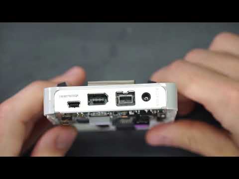

How Do We Recover External Hard Drives with PCB Failures?
External hard drive PCB failures are diagnosed by inspecting board-level components for burnt TVS diodes, failed voltage regulators, or cracked solder joints. Recovery may require preserving ROM data, repairing the original board, or pairing the drive with a compatible donor board before imaging the drive directly via PC-3000.
Here's the PCB from an older LaCie Rugged external drive. The enclosure failed, but the drive inside was fine.

How Do You Safely De-Shell a Sealed External Hard Drive Enclosure?
Don't. If you haven't opened the enclosure yet, ship it to us intact.
Seagate Backup Plus Slim
Inside the Slim is a standard 2.5-inch SATA drive on a separate USB-to-SATA bridge board. That's the older modular design, & it makes bridge bypass straightforward.
Toshiba Canvio
Canvio units built on the MQ04UBB400 or MQ01UBD100 are native USB. The USB connector and bridge sit on the drive's own logic board, so you can't shuck one of these & plug it into SATA. Triage starts by inspecting whether the internal drive has a SATA edge connector or only USB pads.
Rule. If the customer has not opened the enclosure already, ship it to us intact. A cracked PCB on a MyPassport Ultra escalates a straightforward recovery into a costly firmware-tier donor-board and ROM-transfer case. There is no upside to opening a sealed enclosure at the kitchen table.
