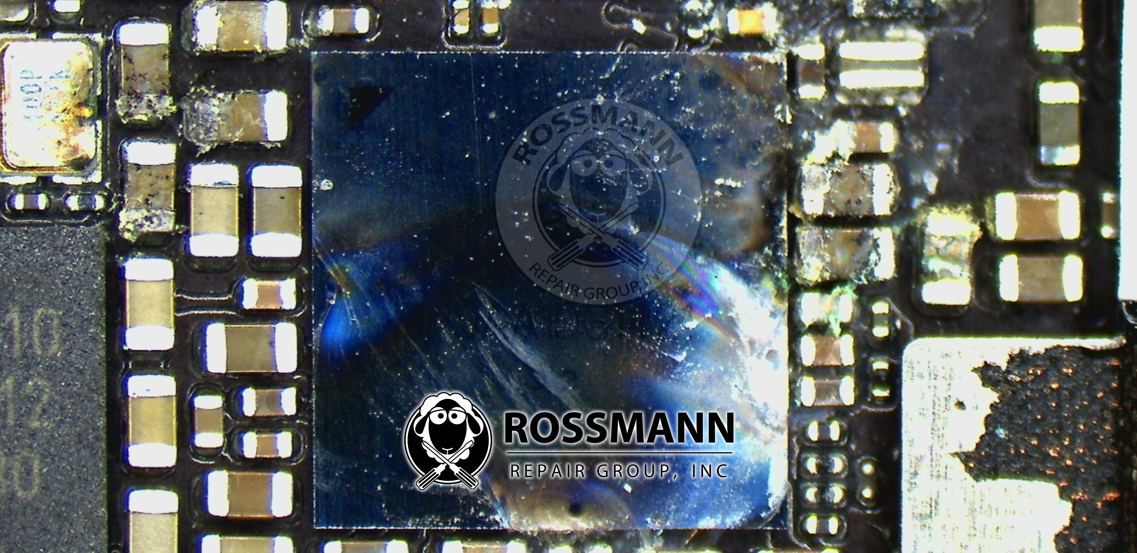

Board-level iPhone repair for data recovery at Rossmann Group Austin lab

Water Damage Diagnostics: Power Rail Short Circuits on iPhone Logic Boards
Liquid does not destroy data directly; it creates short circuits on the logic board power rails that prevent the CPU from booting. The most common failure is a short to ground on VDD_MAIN. We identify the shorted component using a FLIR thermal camera and remove it with a Hakko FM-2032 iron to restore normal current draw.
When water bridges two exposed pads under an RF shield, the resulting electrolytic corrosion creates a direct path to ground that drains the battery and collapses the voltage feeding the Power Management IC (PMIC). Without stable VDD_MAIN, the PMIC cannot generate the secondary step-down voltages required to power the CPU and NAND.
Our diagnostic procedure: after confirming a short using a multimeter in diode mode, we inject a low, current-limited voltage directly onto the shorted rail, bypassing the battery connector to prevent the charging MOSFET from absorbing the heat and masking the fault. We then use a thermal camera to identify the specific surface-mounted ceramic capacitor that is conducting to ground. Removing that shorted component with a microsoldering iron restores normal current draw and allows the PMIC to sequence the power rails.
Once VDD_MAIN and VDD_BOOST are stable, the CPU initializes the Secure Enclave, mounts the encrypted NAND, and the phone boots to the passcode screen.
Software tools like Dr.Fone and Tenorshare instruct users to plug wet phones into a computer via USB. This sends 5V through the Hydra IC into a board with active liquid bridging, accelerating the very electrolytic corrosion that is already destroying components. The hard drive data recovery industry has similar misconceptions; users run consumer software on failing mechanical drives instead of seeking professional board-level diagnosis first.

Why "Rice" and Drying Don't Work
Water corrodes components under shields. Drying doesn't fix electrical damage.
Water wicks under RF shields where it corrodes capacitors and IC pins on critical power lines. That's why "rice" or simple drying fails. The corrosion causes electrical shorts that prevent the phone from booting.
Corroded iPhone logic board
Proper treatment: Remove shields, ultrasonic clean the board, diagnose and repair damaged power paths, then boot long enough to copy your data.
