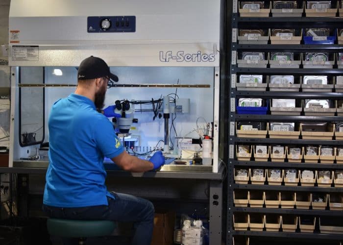

Clean bench
0.02 micron ULPA-filtered laminar flow bench for head stack work, platter handling, and helium refill on sealed drives.

Every incoming HDD is imaged before any repair is attempted. The PC-3000 Portable III and DeepSpar Disk Imager pull a head-by-head, sector-by-sector image with head-map control, so good surfaces are read first and weak surfaces last. A head swap is only performed when imaging confirms the read/write heads are the bottleneck, not the firmware: stuck heads, classic clicking-on-spin-up, or zero servo response from one or more head positions.
Head swaps run on a 0.02 micron ULPA-filtered laminar flow bench with a donor matched to the family, head map, and firmware revision; platter handling stays inside that bench from de-lid to image. Firmware faults are addressed through SA module access on the PC-3000 rather than mechanical work. Pricing tiers run $100–$2,000; under our no-data, no-recovery-fee policy, you pay nothing if the files cannot be read off.

Laminar flow vs walk-in cleanroom13a/39
Why a Validated Laminar Flow Bench, Not a Walk-In ISO Class 5 Room, Is the Correct Control for a Head Stack Swap
The only air a head-stack swap cares about is the 12 to 24 inch column directly above the open chassis. Our 0.02 micron ULPA laminar flow bench, validated with a TSI P-Trak counter, delivers an ISO Class 4 equivalent envelope in that volume without the overhead of a walk-in cleanroom.
ULPA laminar flow bench: vertical filtered air across the open chassis.
Particle validation at the work surface
Sub-micron particle counts on the bench are validated with a TSI P-Trak Ultrafine Particle Counter Model 8525. The P-Trak is a condensation nuclei counter: it grows ultrafine particles inside an isopropanol-saturated chamber until they are large enough to scatter laser light, which lets it count particles from 0.02 micron (20 nanometers) up through 1 micron and larger.

The baseline engineering requirement for open-chassis HDD work is an environment meeting ISO 14644-1 Class 5 particulate limits or better. A walk-in ISO Class 5 room is a facility-scale implementation that photographs well, but the functional requirement at the platter level is localized vertical laminar flow with HEPA or ULPA filtration validated at the work surface, ESD-controlled surfaces, and contamination-handling discipline.
The slider does not care whether the clean envelope is delivered by a 600 square foot walk-in room or by the air column directly over the bench.
All head-stack work, helium reseal, and platter cleaning happen on this bench in Austin. For the longer-form physics breakdown see cleanrooms vs laminar flow benches, and for the step-by-step bench procedure see what a head swap involves.
Clicking drive procedure14/39
What Equipment Does the Austin Lab Actually Use to Recover a Clicking 3.5 Inch Hard Drive?
A clicking 3.5 inch drive is treated as a mechanical failure: head stack damage, preamp failure, or platter contact. Procedure: electrical triage with FLIR thermal imaging, donor head matching, head stack transplant on the 0.02 micron ULPA-filtered clean bench, ROM adaptive transfer via PC-3000 Portable III, and selective head-map imaging that pulls healthy surfaces before retrying degraded zones.
Electrical triage on the PCB.Before opening the head stack assembly, the controller board is isolated and probed for shorted TVS diodes on the 5V and 12V rails, blown buck converter outputs, and burned preamp supply lines. A FLIR thermal camera flags hot spots invisible to the eye. If the failure is electrical rather than mechanical, board-level repair with a Hakko FM-2032 microsoldering iron on an FM-203 or FX-951 base station completes the recovery without ever cracking the lid.
Environmental preparation on the ULPA bench.The drive is moved to the 0.02 micron ULPA-filtered clean bench, which generates a vertical laminar airflow envelope over the work surface. ULPA filter media captures 99.999 percent of particles at 0.12 microns through a combination of diffusion, interception, and inertial impaction. That matters because modern read/write heads fly within a few nanometers of the platter surface; any particle larger than the flying height causes a head crash.
Donor head matching against six criteria.A model-number match is not sufficient. The donor drive is verified against six vectors before any swap: head map and head count, preamp silicon revision, firmware family and revision, platter density and tracks-per-inch geometry, serial range or site code (kept within roughly a 90 day window), and ROM adaptives including microjog offsets. On Western Digital Marvell drives the DCM code and Module 47 microjog delta must align within a tight tolerance; on Seagate F3 drives the preamp variant and head configuration strongly correlate with the second and third serial-number characters, with absolute confirmation requiring an F3 terminal read. Driving patient heads with the wrong bias voltages programmed for a different preamp revision crashes them on contact.
Head stack transplant inside the bench.Heads are parked off the load/unload ramps using head combs, the damaged head stack assembly is lifted, and the donor stack is seated without letting any slider contact platter media. On helium-sealed drives the lid gasket is replaced, the chamber is resealed, and helium is recharged in-house; the helium refill cost is captured in the helium HDD pricing tier.
ROM adaptive transfer.The original PCB ROM holds microjog offsets, thermal fly-height values, and channel-gain calibration unique to the patient drive. The PC-3000 Portable III extracts the original ROM adaptives and writes them to the donor PCB; if the Service Area itself is corrupted, a loader is uploaded into controller RAM via the vendor-specific diagnostic port so the firmware can be repaired in place. On WD architectures, Module 47 SA adaptives must load cleanly before the drive will respond to a standard ATA identify command.
Selective head map imaging via PC-3000.Once mechanical stability is confirmed, the PC-3000 issues vendor-specific commands to log per-head read stability. Weak heads are disabled in the firmware head map and read requests are throttled via imaging-utility timeouts; healthy surfaces are imaged first onto safe destination media; degraded zones are revisited at reduced read-channel gain only after the rest of the image is locked. The DeepSpar Disk Imager handles the same role for drives that respond to ATA but degrade quickly under sustained imaging load.
File extraction from the clone, not the patient.File system parsing and file extraction run from the cloned image, never from the patient drive. If the image cannot be produced the no-data-no-recovery-fee guarantee applies and the customer pays nothing except optional return shipping. The original drive is held under the customer's shipping instruction.

Platter cleaning procedure inside the 0.02 micron ULPA-filtered clean bench
All platter handling happens inside the 0.02 micron ULPA-filtered laminar flow bench. The ULPA filter on our bench captures particulates down to 20 nanometers. Modern read/write heads fly within a few nanometers of the platter surface; any particle larger than that flying height causes a head crash. A standard HEPA filter is rated at its most penetrating particle size of 0.3 microns (300 nanometers), which is larger than the flying height and introduces unnecessary contact risk on an open drive.
Platter surface inspection under magnification.The damaged head stack is removed using head combs to prevent any slider from contacting platter media during extraction. Platter surfaces are then inspected under magnification to map zones with visible scoring or magnetic layer removal. Cleaning cannot recover data from an abraded zone; it prepares surviving tracks for the incoming donor heads.
Debris and displaced lubricant removal.Metallic shavings from scored platters and carbon debris from the overcoat are removed using lint-free cleanroom wipes along the track circumference. Displaced lubricant that has pooled or re-deposited across the platter surface is cleared in the same pass. Every step runs inside the laminar flow zone of the 0.02 micron ULPA bench where filtered air flows down across the open chassis.
Donor head installation via head combs.A matched donor head stack assembly, verified against head count, preamp revision, firmware family, and serial range, is guided onto the load/unload ramps using head combs so no slider contacts platter media during seating. On helium-sealed drives the lid gasket is replaced and helium is recharged directly in-house at our Austin lab.
Read-channel tuning before imaging.After the donor heads are seated, the PC-3000 Portable III accesses the drive service area to adjust adaptive parameters so the new heads can read weak sectors adjacent to cleaned damage zones. Head-map imaging on the DeepSpar Disk Imager then sequences clean surfaces first, leaving degraded zones for the end of the imaging session to maximize data yield before the donor heads potentially degrade.
All clean bench mechanical work, including head stack assembly transfers, platter cleaning, and helium reseal, is performed in our Austin lab. For the full head swap workflow, see the clicking drive procedure section above.
Six-head stack inspection: every slider, preamp, and ramp checked before swap.

Do You Need a Clean Room for Hard Drive Recovery?
No. A ULPA-filtered laminar-flow clean bench provides the same particle protection as a full clean room. The bench creates a localized ISO 14644-1 Class 4 equivalent environment directly over the platters during a head swap. The drive is only open for 10 to 30 minutes under directed airflow.
Competitors advertise multi-million-dollar “ISO Class 5 certified clean rooms” populated by technicians in full spacesuits. Clean room classifications are defined by ISO 14644-1, which specifies maximum allowable airborne particle concentrations.
For data recovery, that level of whole-room infrastructure is marketing theater, not a technical requirement. What actually protects your platters is a validated laminar-flow clean bench with proper ULPA particle filtration and an image-first workflow.
Clean Room Standards vs Our Clean Bench
Standard
Max Particles ≥0.5µm per ft³
Filtration Level
Required For HDD Work?
ISO 14644-1 Class 5 (Class 100)
100 particles
0.3µm HEPA
Industry marketing standard
ISO 14644-1 Class 4 (Class 10)
10 particles
0.1µm ULPA
Semiconductor manufacturing
Our Laminar Bench
Near-zero particles (validated)
0.02 µm particle count
Localized ISO 14644-1 Class 4 equivalent
Our ULPA-filtered laminar-flow clean bench achieves zero particle count at 0.02 µm during validation. ULPA filters are rated 99.9995% efficient at their most penetrating particle size, about 0.12 µm; the 0.02 µm reading comes from our particle counter. We validate our bench before every open-drive procedure and publish the results.
The reading: localized ISO 14644-1 Class 4 equivalent conditions.
A full clean room is designed for semiconductor wafer fabrication where you need an entire facility held at ISO 14644-1 Class 5 or better continuously. You only need clean air in the immediate work zone during the brief window when platters are exposed. A validated laminar bench provides that. The spacesuits and airlocks are theatrical overhead built into your invoice.
Our particle counter reading during validation: localized ISO 14644-1 Class 4 equivalent conditions at 0.02 µm sensitivity
Watch us validate our clean bench environment before a head swap procedure.
Bottom line: We use the same imaging equipment (PC-3000, DeepSpar) and the same donor-matching procedures as the labs charging $3,000+. Our clean bench achieves localized conditions that exceed ISO 14644-1 Class 5 particle standards. The difference in price is marketing overhead and real estate, not capability. We show our validation on video; ask competitors to show theirs.
Competitors charge $3,000+ and justify it with photos of technicians in full cleanroom suits. In this video, Louis demonstrates our laminar flow bench particle test side-by-side with a competitor's marketed cleanroom. The bench validates to localized ISO 14644-1 Class 4 equivalent conditions at 0.02 µm sensitivity.
The cleanroom is designed for semiconductor fabs, not 30-minute head swaps. The difference in your invoice is real estate and marketing, not science.

Before removing the failed heads, we inspect the platters under our 0.02 µm ULPA-filtered clean bench. We look for three things: scoring (visible scratches from a head crash), particulate contamination (debris from degraded heads circulating inside the HDA), and stiction marks (areas where heads adhered to the platter surface on 2.5-inch drives).
If scoring is present, the damaged zones are mapped before the swap. Those zones will produce read errors regardless of how good the donor heads are, and the imaging strategy must account for them from the first sector. If contamination is visible, the platters are cleaned before installing donor heads. Inserting new heads into a contaminated HDA will destroy the donor stack within minutes.
Removing and installing the head stack assembly requires separating the heads from each other without letting them contact platter surfaces. We use duralumin head combs, CNC-machined to sub-0.01mm tolerances, sized specifically for each drive family. Duralumin (an aluminum-copper alloy) holds dimensional accuracy under the mechanical stress of separating spring-loaded heads.
Plastic head separation tools, common in consumer data recovery kits, suffer from plastic deformation: they flex under load, allow heads to shift during extraction, and can cause the slider to contact and score the platter during what should be a non-contact procedure.
PC-3000 Head Map and Selective Imaging
After the donor heads are installed, we connect the drive to PC-3000 and build a head map. The head map tests each head individually across the full LBA range and rates its read stability. Heads that produce consistent reads across their assigned platter surfaces are marked stable. Heads that throw repeated read errors or trigger drive resets on specific zones are marked degraded for those zones.
PC-3000's Data Extractor uses the head map to prioritize imaging. Stable heads read their zones first while the donor stack is freshest. The head map also accounts for servo-related instability: each embedded servo wedge contains Gray-coded track numbers & servo burst A/B/C/D patterns that generate the Position Error Signal (PES) for track following.
When servo bursts are damaged or the MR element is too weak to demodulate the servo pattern cleanly, the drive loses servo lock & aborts the read. Data Extractor can be configured to skip damaged servo wedges, interleave reads, or apply a deliberate PES bias (micro-jog offset) to read slightly off-center, bypassing physical scoring on the track center.
Degraded heads are deferred to later passes with adjusted read timeouts and retry counts. If a head begins failing mid-image, the task skips to the next head rather than hammering the failing one until it scores the platter.
Firmware-Level Head Disabling Before Physical Swap
Not every clicking drive needs a full mechanical head swap. Before opening the HDA, we can diagnose head viability through the drive's UART diagnostic terminal. On Seagate F3 drives, PC-3000's Level 7 diagnostic monitor exposes the 7>X command, which measures the differential resistance of each MR read element.
A healthy MR element reads between 30 & 500 ohms depending on the technology generation (AMR, GMR, TMR); TMR heads in current production drives trend toward the higher end. A near-zero reading indicates a short circuit from ESD or head crash; an open-circuit reading (thousands of ohms) means the MR sensor has been physically sheared from the slider or the flex trace has fractured.
This electrical test confirms head viability without opening the drive, informing the decision between firmware-only recovery & a full mechanical swap.
When one head in a multi-head stack fails, PC-3000 can disable the failed head in the drive's MCU RAM so the remaining healthy heads continue reading their assigned platter surfaces. We build a head map to identify which specific head is degrading. If heads 0, 1, and 3 are stable but head 2 produces read errors or triggers drive resets, we disable head 2 in firmware and image the data accessible to the three surviving heads.
This firmware-first approach recovers a partial image with zero mechanical risk to the platters. Once the stable heads have been fully imaged, we proceed with a physical head swap to attempt recovery of the data under the failed head. The swap targets only the remaining unimaged zones. This two-phase strategy is safer than an immediate full swap because the majority of the data is already extracted before any mechanical intervention occurs.
Manufacturer-Specific Head Swap Patterns
Seagate Rosewood (2.5-inch portable drives): These single-platter, two-head drives are a high-volume head swap case for any data recovery lab. The top magnet is bonded to the lid with a foil seal, which must be separated without bending the lid or contaminating the platter. Rosewood drives have low motor torque, so stiction (heads stuck to platter) is a frequent co-occurring failure. If the heads are stuck, we free them manually before assessing whether the original heads can image or if a donor swap is necessary.
Western Digital (Marvell-based 3.5-inch desktop and NAS drives): WD drives store adaptive calibration data both in the service area on the platters and in the Marvell controller ROM on the PCB. After a head swap, the new heads read the patient drive's service area parameters, but ROM-stored parameters on the PCB still reference the original heads. On some WD families, this mismatch causes intermittent read instability. We use PC-3000's WD module to read the service area adaptive data and compare it against the ROM values, patching discrepancies when possible before starting the imaging task.
When an exact donor match cannot be sourced and the donor heads click on the patient drive, the micro-jog values stored in WD ROM Module 47 are the first thing we check. Module 47 stores per-head fly height offsets and read/write positioning parameters.
If the patient's original micro-jog values and the donor's values are both known (extracted before the swap via PC-3000's WD ROM editor), we calculate an averaged configuration: splitting the difference between each parameter pair. Writing the averaged Module 47 back to the drive's service area can stabilize the read channel enough for the donor heads to track the patient's servo patterns.
This procedure does not work on every drive; it depends on how far apart the two head stacks are in their factory calibration. But when the alternative is sourcing another donor and performing a second mechanical swap, parameter averaging is the lower-risk first attempt.
Helium drives (8TB+ enterprise): Head swaps on helium-sealed drives are single-attempt procedures. Once the hermetic seal is broken, the helium escapes and the heads lose their designed fly-height environment. Helium's lower density also changes the Air Bearing Surface (ABS) aerodynamics: the slider design is tuned for helium's reduced viscous drag, generating different pressure differentials than it would in air.
Installing air-environment donor heads into a helium drive produces incorrect fly height regardless of firmware matching, so the donor must also be a helium drive of the same family. After installing the donor heads, we refill the drive with helium & connect to PC-3000 immediately.
There is no pause for extended head map testing on helium drives; the map is built live during the first imaging pass because the refilled helium charge is finite & the resealed environment degrades over hours to days.
Platter Decontamination Before Donor Installation
When heads crash, the slider gouges the ferromagnetic coating off the platter surface. The resulting debris circulates inside the sealed HDA and embeds itself in undamaged tracks. Installing donor heads into a contaminated enclosure destroys the new stack within minutes; the particles act as microscopic abrasives between the head and the platter surface.
Some labs market "platter burnishing" as a recovery technique, claiming they shave damaged surfaces smooth with a precision tool. The data is physically stored in that ferromagnetic layer. Shaving it removes the data along with the damage. Burnishing recovers nothing from the abraded zone; it only prevents further contamination from raised debris on that specific track.
Our approach is non-destructive. Under the 0.02 µm ULPA-filtered clean bench, we lift loose particulate from surviving platter surfaces using lint-free cleanroom wipes and isopropyl alcohol applied in a circumferential motion following the track curvature. Zones where the coating is physically gone are mapped and excluded from the imaging plan. After cleaning, we disable the head assigned to the destroyed surface via PC-3000 firmware and image only the surviving platters with the donor stack.
The lab documents non-destructive decontamination and head-stack work through filmed platter swaps. If decontamination and donor imaging do not return the data, the no data, no recovery fee guarantee means the evaluation and mechanical attempt cost nothing. Lab-wide customer feedback sits at 4.9 stars across 1,837+ Google reviews, which aggregates outcomes across all recovery workflows.

Clean-bench head swaps30a/39
Clean-Bench Head Swaps: ULPA Filtration, Donor Matching, and HSA Azimuth Alignment
A clean-bench head swap replaces a failed head stack assembly inside a 0.02 micron ULPA-filtered laminar flow bench. Donor selection requires matching the HSA by model family, firmware revision, and preamp silicon revision. Micro-jog servo lock tolerance sits at approximately plus or minus 300 points; a donor outside that window produces click-on-spin-up and platter scoring.
ULPA filtration at 0.02 microns captures particles down to 20 nanometers. Modern read/write heads fly 1 to 5 nanometers above the platter surface, so any particle that size causes a head crash on spin-up. A standard HEPA filter passes particles down to 300 nanometers, which exceeds the flying height and introduces unnecessary contact risk on an open chassis.
Head combs keep each slider off platter media during extraction and seating. On helium-sealed designs, the head comb geometry must match the platter spacing exactly; a 9-platter Seagate Exos and a 7-platter WD Ultrastar use different spacings and therefore different comb fixtures. Azimuth alignment after installation is confirmed via PC-3000: the firmware reads per-head servo lock status and flags any head whose micro-jog value falls outside the tolerance window before imaging begins.

All of this work happens in-house in our Austin, TX lab on the same 0.02 micron ULPA-filtered clean bench, PC-3000, & DeepSpar hardware we use for conventional drives. Single location, no franchises, no outsourcing, & the same no-data-no-recovery-fee guarantee applies. We don't charge a diagnostic fee to tell you a HAMR drive needs a donor with matched optics.

Watch Our Engineers Work
We film our recoveries so you can see the tools and procedures before sending your drive. Filmed cases cover head swaps, firmware rebuilds, PCB transplants, and sector-by-sector imaging on real drives. Each video shows the named equipment, the specific failure mode, and the procedure used to extract the data.
We believe in total transparency. That is why we film our work. Watch Louis Rossmann and the team perform real data recovery procedures, from head swaps to firmware rebuilds, so you know exactly what happens to your drive. Filmed recoveries demonstrate the tools and procedures a hard drive recovery service uses on your specific failure type.
