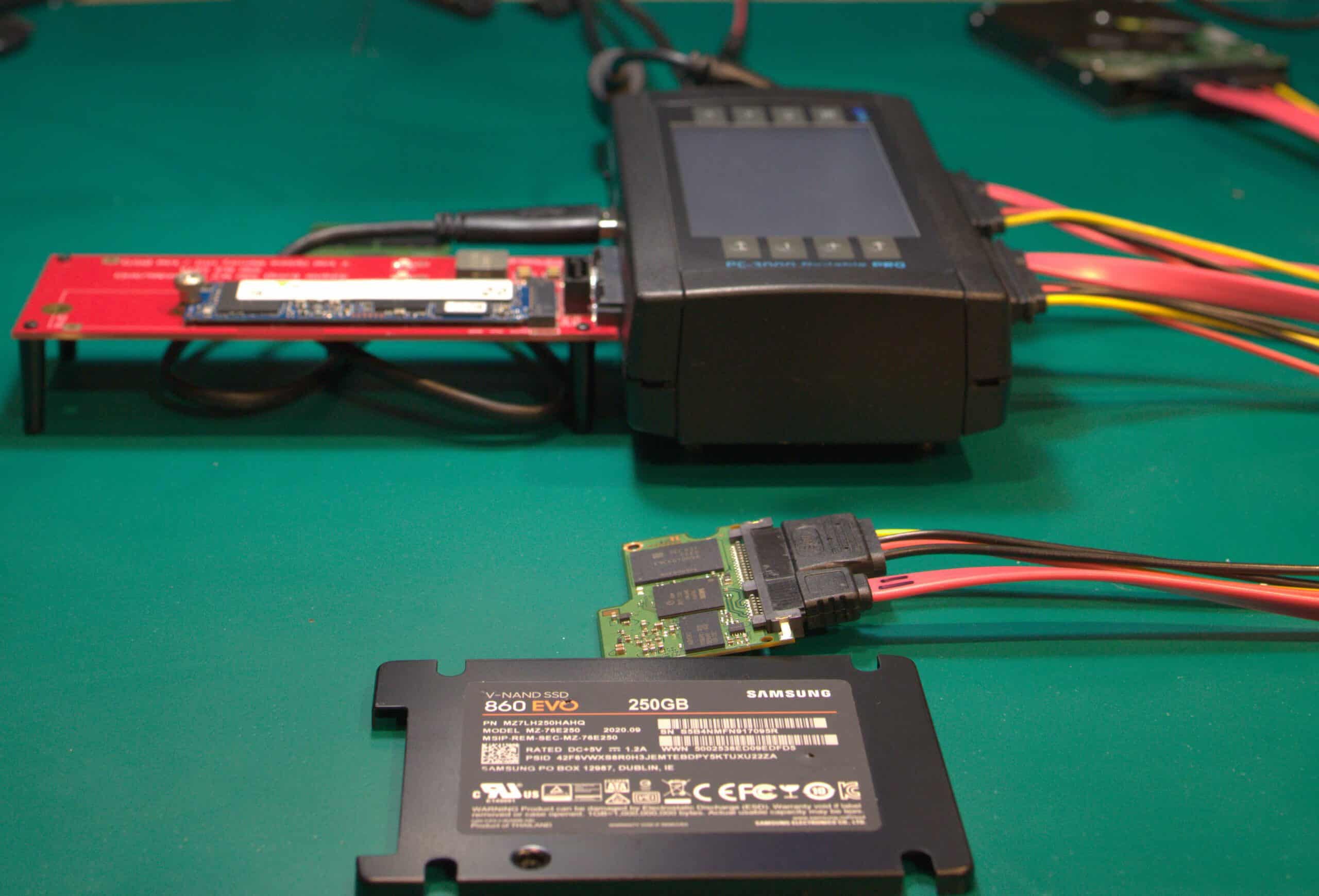

Named SSD recovery equipment
PC-3000 Portable III & Hakko FM-2032
PC-3000 Portable III for controller-mode imaging & FTL reconstruction; Hakko FM-2032 on FM-203 base stations for board-level component repair. In-house at the Austin lab; nothing shipped to a partner.

We recover NVMe, M.2, and SATA SSDs using PC-3000 Portable III for firmware-level repair and Hakko microsoldering stations for component-level board work. Software tools cannot reach data on a drive whose controller is dead. Unlike hard drive recovery, SSD failures involve dead controllers, corrupted firmware translation layers, and shorted power-management ICs. All work is performed in-house at our single lab in Austin, TX; walk-in or mail-in from all 50 states.
SSD recovery uses firmware platforms, soldering stations, and thermal diagnostics instead of cleanroom equipment. PC-3000 SSD accesses controller diagnostic mode for firmware reconstruction. Hakko microsoldering stations replace failed components; FLIR thermal cameras locate shorted ICs without applying power long enough to cause further damage.
SSD failures are electronic, not mechanical. The tools below are what we use daily at our Austin lab for controller repair, firmware rebuilding, and NAND imaging.

What Equipment Does SSD Board Repair Use?
A Hakko FM-2032 microsoldering iron on an FM-203 or FX-951 base station handles the fine-pitch rework on the controller, PMIC, and power rails. An Atten 862 hot air rework station preps for chip removal and reflow. A Zhuo Mao precision BGA rework station handles the controller reball when the controller itself has to come off. A FLIR thermal camera locates the shorted component before any iron touches the board. Once the controller is powered and stable, the drive is imaged through PC-3000 SSD or PC-3000 Portable III to reconstruct the flash translation layer and pull the logical file system. That sequence is what the tiers above pay for. All of it happens in-house at the Austin, TX lab.

What Does the Lab Check When Your SSD Arrives?
When an SSD arrives, we run a fixed sequence of checks: SATA or NVMe handshake, the capacity and model string the drive reports, the ATA BSY signal, PCB power rails, and NAND readability. Each observation maps to one recovery classification and one pricing tier, so the free evaluation ends with a firm quote, not a guess.
The evaluation costs nothing & commits you to nothing. We read what the drive does on the bench, sort it into a failure class, & quote the matching tier before any paid work starts. The table below shows how each diagnostic observation routes a drive.
Diagnostic check
What we observe
Lab action
Recovery classification & tier
SATA / NVMe handshake
Drive enumerates but reports 0 bytes, the wrong capacity, or a factory identity string (a Phison PS3111-S11 showing "SATAFIRM S11", a Silicon Motion SM2259 reporting 0 LBAs)
Force the controller into its technological (safe) mode, inject a volatile loader into controller SRAM with PC-3000 SSD, & rebuild the lost FTL translator from the raw NAND structures
Firmware / FTL reconstruction. SATA $600–$900; NVMe $900–$1,200
ATA BSY bit held high
The drive never clears its busy signal, so no host can issue read commands; the controller is stuck in a firmware panic loop on power-up
Force the controller into safe mode by shorting its diagnostic test points, issue vendor-specific commands over the SATA or PCIe interface to clear the panic state, & repair the corrupted system-area module that triggers it
Firmware panic resolution. SATA $600–$900; NVMe $900–$1,200
PCB power rails
A rail reads shorted to ground or the drive draws no current; the PMIC or a voltage regulator is dead, so the controller never powers up
Localize the short with a FLIR thermal camera, replace the failed component with a Hakko FM-2032 on an FM-203 base, & restore power to the original controller
Board-level electrical repair. SATA $450–$600; NVMe $600–$900
NAND readability
The controller responds but the NAND configuration is unreadable, or read errors blow past the controller's ECC budget so pages stop decoding
Read raw pages through PC-3000 SSD with shifted reference voltages so the controller's ECC engine can clear the read errors, then rebuild the translator from the decoded pages
Complex firmware reconstruction. SATA $600–$900; NVMe $900–$1,200
Every drive runs through these checks before we name a price. The evaluation is free, we never charge a diagnostic fee, & we hold to one firm quote under our no data, no fee guarantee before any paid SSD work begins.

What Does the SSD Recovery Process Look Like Step by Step?
SSD recovery follows five stages: current profiling to identify shorts, safe mode access to prevent garbage collection, translator rebuilding to reconstruct the NAND address map, multi-pass imaging with adjusted read parameters, and file system extraction to a target drive. Each stage isolates a distinct failure class, from shorted PMICs to corrupted flash translation layers.
Every SSD that arrives at our Austin lab goes through these diagnostic and repair stages. The specific path depends on the failure type, but the workflow is consistent.
Current Profiling: We connect the SSD to a bench power supply with current limiting and measure draw at 5V (2.5" SATA) or 3.3V (M.2 NVMe). A healthy SSD draws minimal current at idle but shows initialization spikes when it tries to load firmware. A shorted PMIC or controller pulls well above normal and shows as a hot spot on our FLIR thermal camera within seconds. This tells us whether the failure is a short circuit (needs component replacement) or a firmware/logical issue (needs PC-3000).
Safe Mode Access (ROM Mode / Pin Shorting): A failing NVMe or SATA controller left to power up normally will attempt to load its corrupted firmware and may execute background garbage collection, permanently erasing NAND blocks flagged by prior TRIM commands. To prevent this, we physically isolate the controller from the NAND by shorting specific Vout or clock pins on the PCB before applying power.
This forces the controller into a minimal ROM mode (called "Techno Mode" on Phison, "Factory Access Mode" on Samsung, "Test Mode" on Silicon Motion) where it accepts commands but does not execute autonomous background tasks.
Once in ROM mode, PC-3000 Portable III uploads a custom microcode loader directly into the controller's SRAM. This loader replaces the corrupted on-NAND firmware with a minimal instruction set that enables stable, single-channel read access to the flash. With the loader active, the controller responds to vendor-specific commands without running garbage collection, wear leveling, or TRIM execution, preserving every NAND block in its current state for imaging.
Translator Rebuilding: PC-3000 scans raw NAND metadata to reconstruct the flash translation layer (FTL), which maps logical addresses to physical NAND pages. Without this map, the drive cannot locate any files. The rebuild process reads spare area bytes from every NAND page to piece together the correct logical-to-physical mapping.
Multi-Pass Imaging: Using PC-3000 Data Extractor, we image the SSD sector by sector. Sectors that fail on the first pass get queued for retry with adjusted read parameters. For degraded NAND, we apply thermal stabilization to shift voltage thresholds into a readable range. The result is a sector-by-sector clone on a target drive.
File System Extraction: We mount the cloned image, verify file integrity, and transfer recovered data to the customer's choice of media. The original failed SSD is returned or securely retired per the customer's instructions.

NVMe Controller Recovery: How We Access Failed Gen3 and Gen4 Drives
NVMe controller recovery requires forcing the controller into diagnostic mode before it loads its corrupted firmware and triggers background garbage collection. Phison, Silicon Motion, and Samsung controllers each have a distinct diagnostic entry point and vendor-specific command set. Using the wrong entry sequence causes the controller to boot normally, compounding the corruption.
Below is how we approach the three most common NVMe controller families using PC-3000 Portable III with its dedicated PCIe SSD adapter. A Phison E18 does not respond to the same vendor commands as a Samsung Elpis or a Silicon Motion SM2262EN. Using the wrong sequence triggers normal boot, executing garbage collection on the corrupted FTL and making recovery harder or impossible.

Equipment used at the Austin lab: PC-3000 SSD for controller technological mode and FTL reconstruction; Hakko FM-2032 microsoldering iron on an FM-203 or FX-951 base for component replacement; Zhuo Mao precision BGA rework for controller and NAND package work; Atten 862 hot air for shielded packages; FLIR thermal cameras to locate shorted rails before applying power. The same toolchain handles monolithic NAND recovery on integrated-package SSDs where the NAND and controller share a single die.

Recovery equipment
PC-3000 SSD for controller firmware reconstruction. Hakko FM-2032 microsoldering stations for component-level board repair. FLIR thermal cameras for fault isolation under controlled voltage injection.
